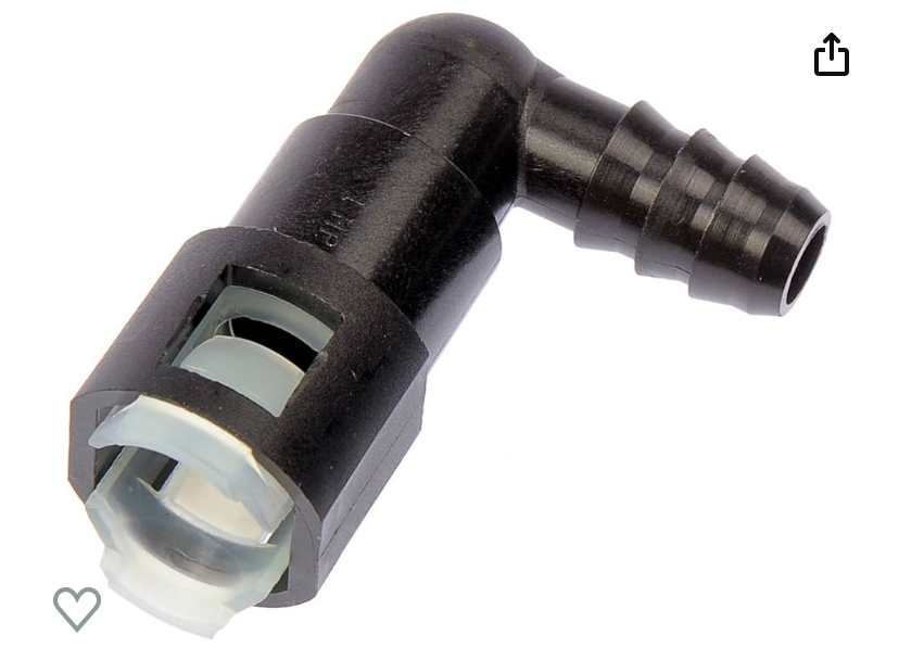

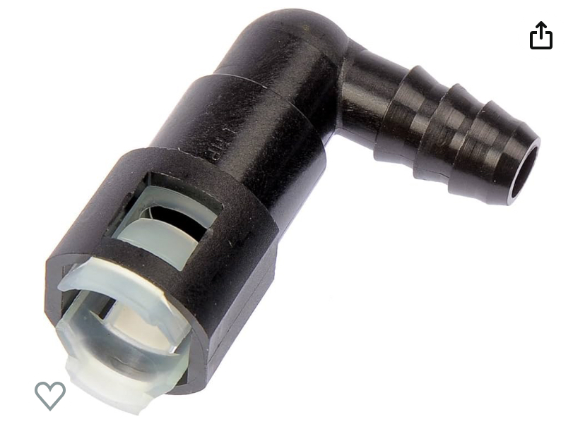

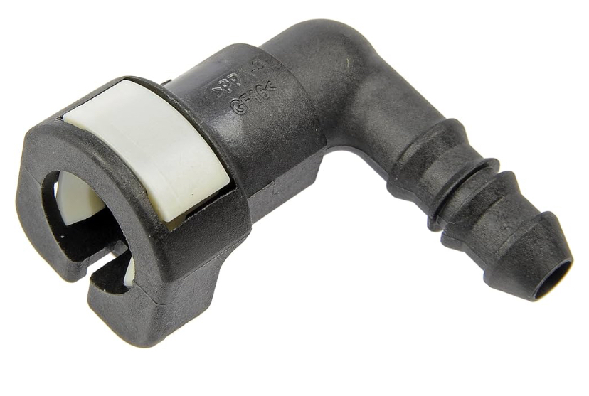

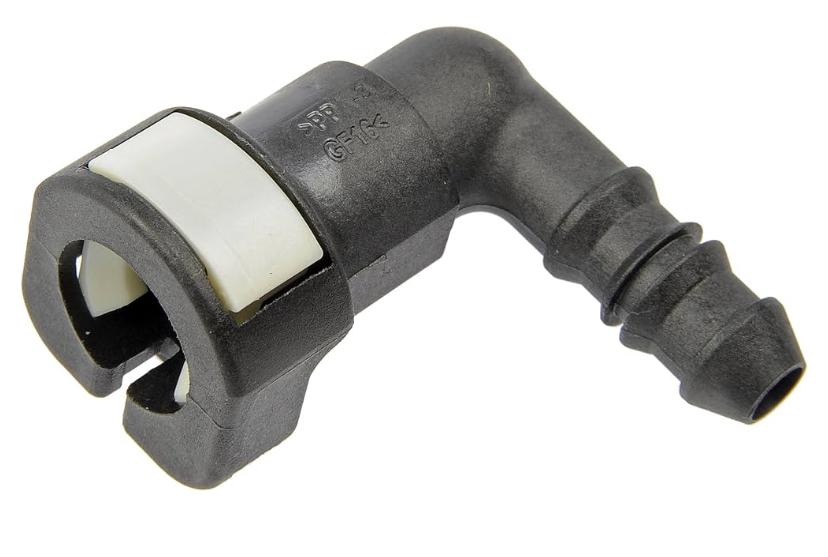

Do both of these fittings work for the same application?
What differences, if any, apply to installation?
Both are PTC (push-to-connect). The top one is the traditional one found on fuel lines and requires a tool to release the locks. The bottom one you just push the large white part in to release the locks. I'd assume the top one is more secure than the other and that's why it's used on wet fuel whereas the other is used on the lesser critical vapor/EVAP portions.
