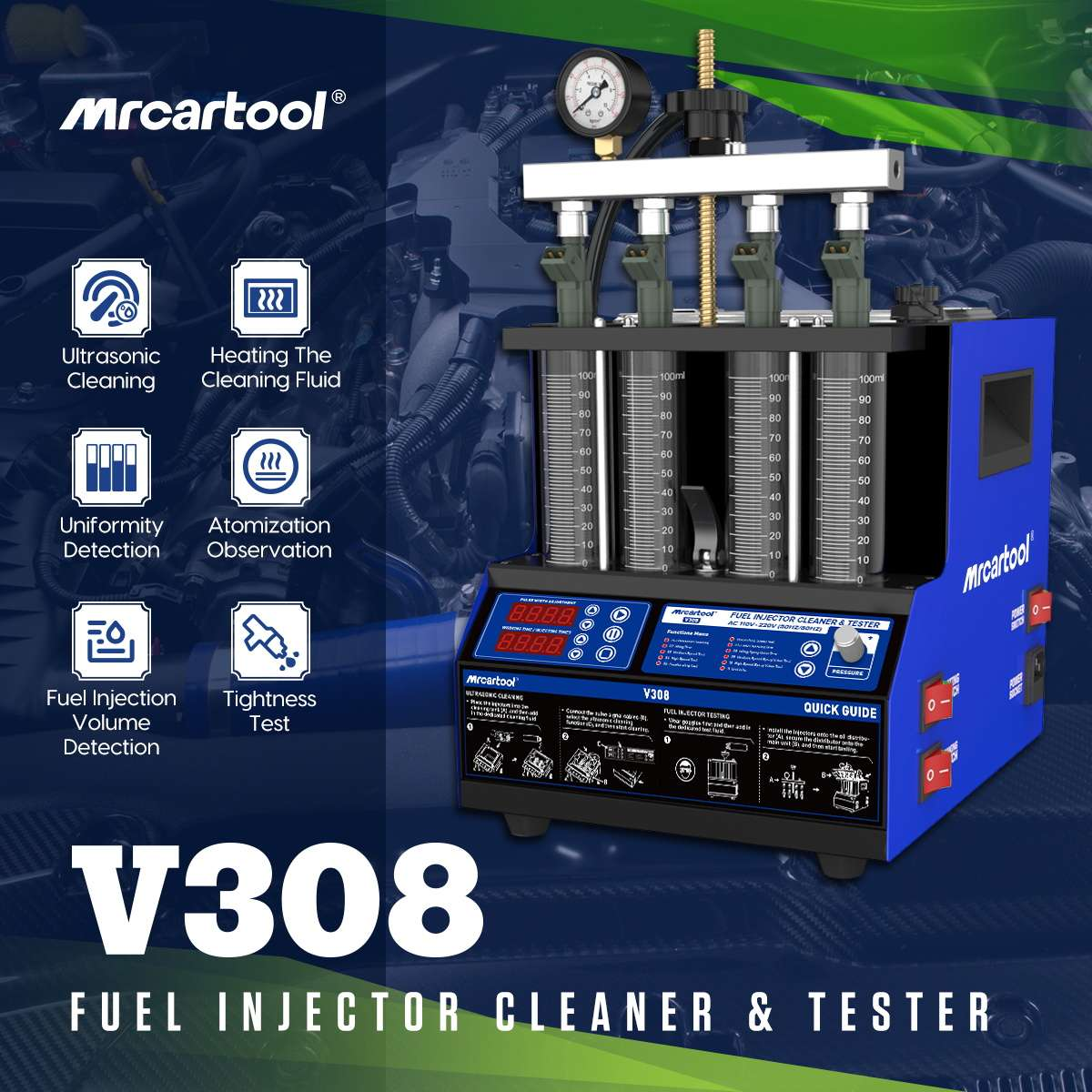

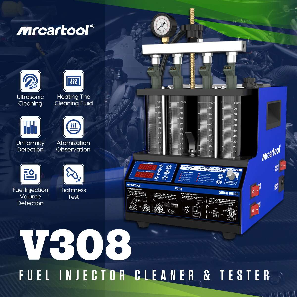

Has anyone bought/used one of these ? I do use Techron Complete Fuel System Cleaner, but the reverse-flush capability of these machines has me thinking buying one might be a good idea.
Good investment or a waste of money ???

This isn't a business venture purchase. This one costs $250 +/-. And I am only asking those who have previously bought/used to chime in on whether it actually does what it claims it can.

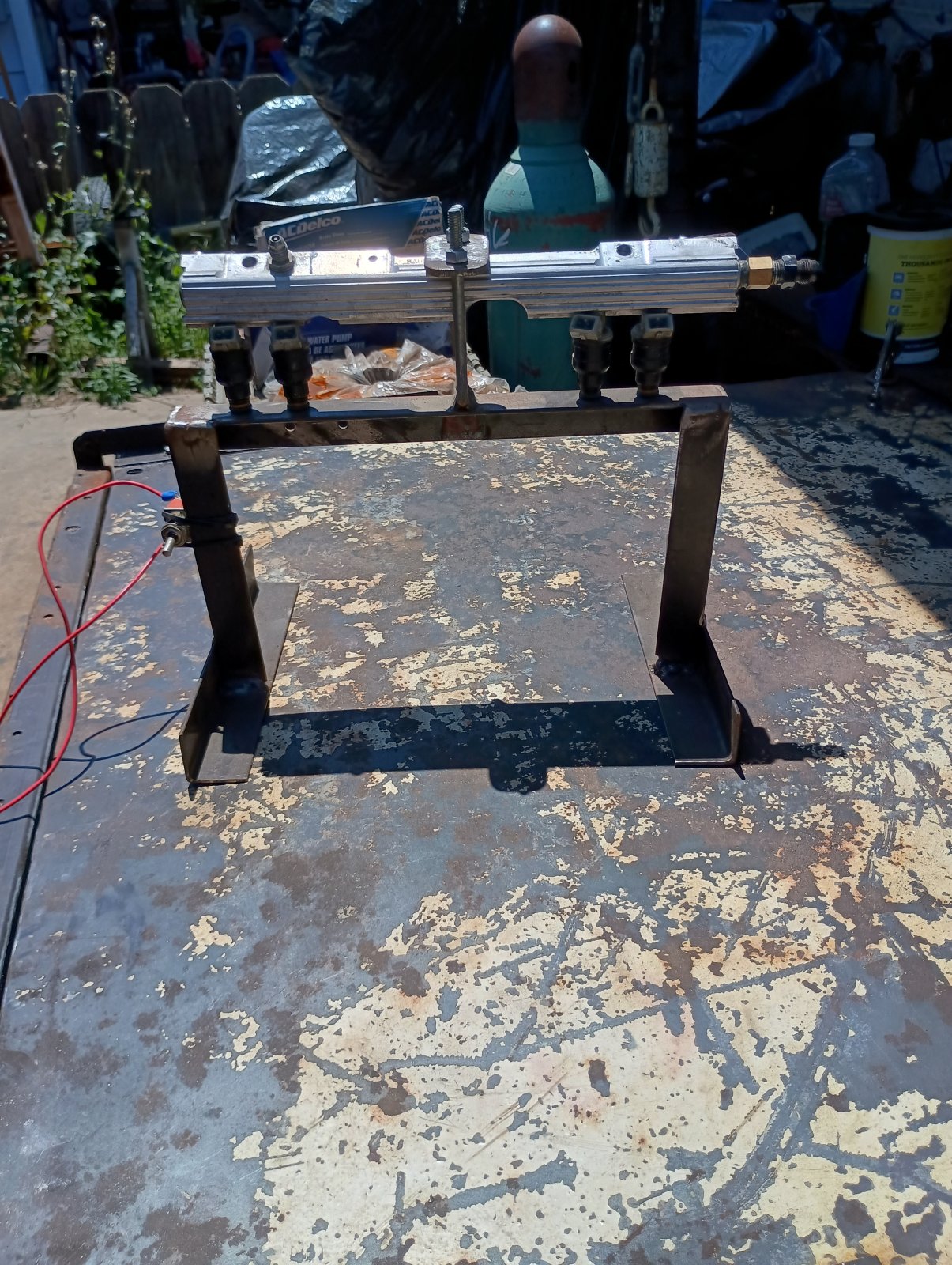

I made one with a used Tahoe fuel pump & an old fuel rail from a 1980's TPI system
They are quite useful for cleaning & checking for consistent flow rates
The reason I made it was because of the high failure rate of new injectors these days, not uncommon for a set of 8 to have 2 stuck open or closed; stuck open will flood that cylinder the moment the fuel pump comes on
For the price that seems like a good investment, my homemade one is a bit clumsy and I use paint cups to measure flow volume; that little system looks much easier to use

Wonder if it checks metering, too, so injectors could be matched as sets.
It does have those graduated cylinders.. The 'volume detection' I am assuming..
Sure looks nice for some peace of mind or for eliminating faulty injectors if running sub-optimally.
Wow! 2 out of 8 stuck! That's depressing to hear..
Nice work on the custom setup!
