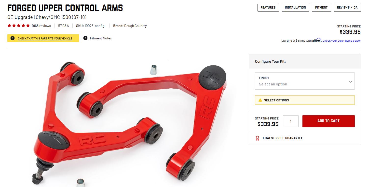

was looking at these, RC county ones... look HD
