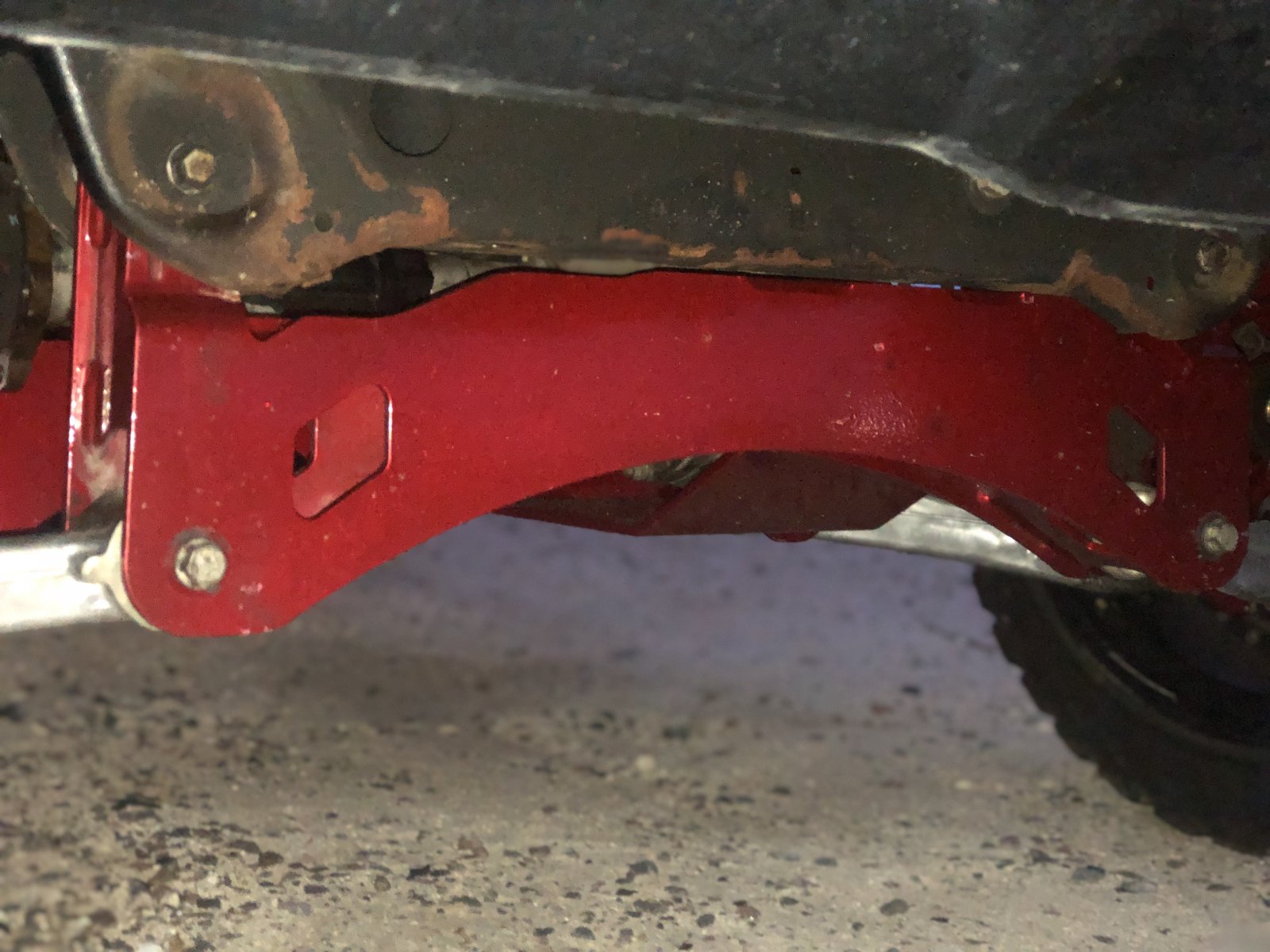

So after spending some time down to Hatteras and not washing the salt off for a month now I’ve started to notice some rust coming from my frame under the factory rubber crap
Has anyone stripped the rubber undercoating off? If so what did you use a wire wheel or stripper grinder with a floppy disk or what was easiest?
I do have a cheapo sand blast gun I may try out first
Probably repaint with pqr undercoat

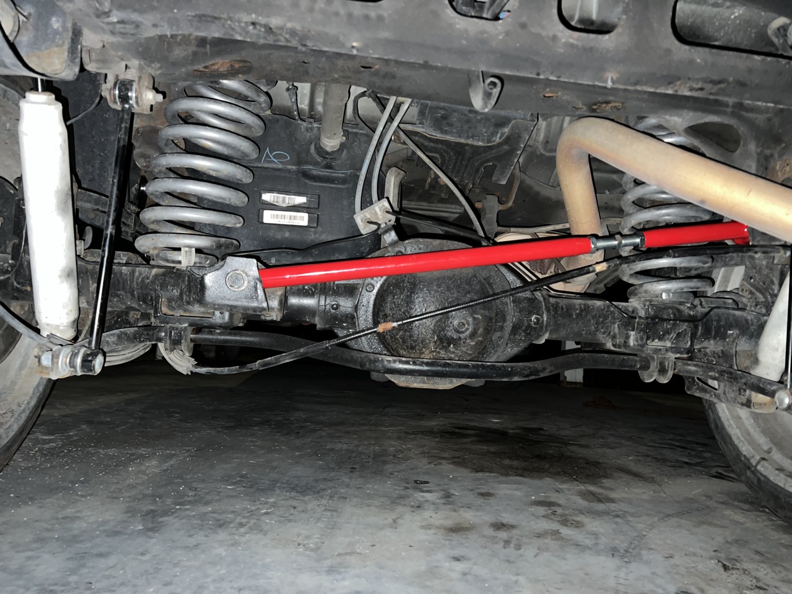

For the sway bar links I have the stocks up front and extended Jeep sway bar links in the rear
I want to upgrade I’ve been looking at the kryptonite links for the front but I’ve also been looking at some Heim joint sway bar links for the same price and I think they would work better
I would also eventually sway the rear ones out with some Heim joint sways for a jeep
Does anyone have any experience with the Heim joint sway bar links?
Along with a panhard bar bracket to level it and make room for a bigger differential cover.
I have coil overs and uniball control arms and I’m trying to set up for a minor MIDTRAVEL build and obtain some better ride quality

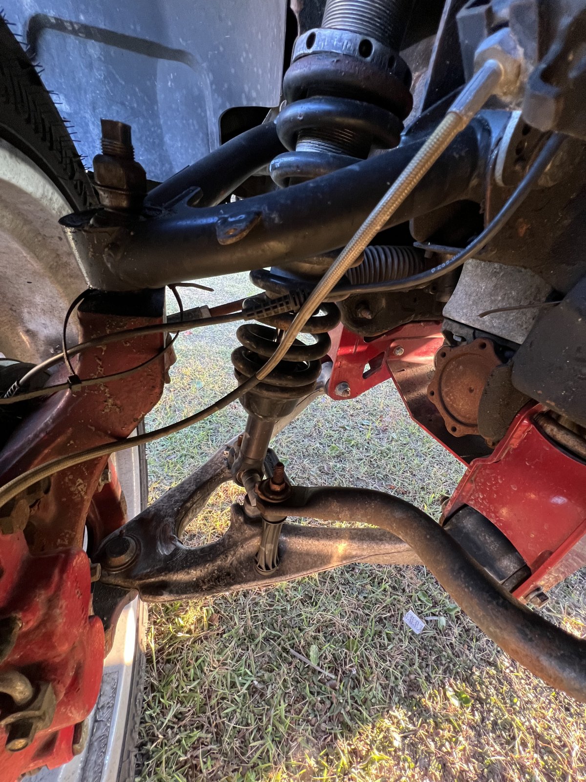

View attachment 394932View attachment 394933View attachment 394934
Where is your half shaft? You running without them?
Yea I cut them a couple years ago when I tried to stretch 6” of lift without a crossmember drop lol
I’m running kryptonite pressed wheel bearings. Since their pressed you can use them with or without cv axles installed
I never use the 4x4 in this anyways I don’t go mudding it’s my daily driver…
I got 4x4 in my white truck for when I want to go off-roading!
I did however take it on the side of the road on hwy 12 coming off of Hatteras island in some thick sand running about 70mph and she took it like a champ! I diddnt even spill my beer!
