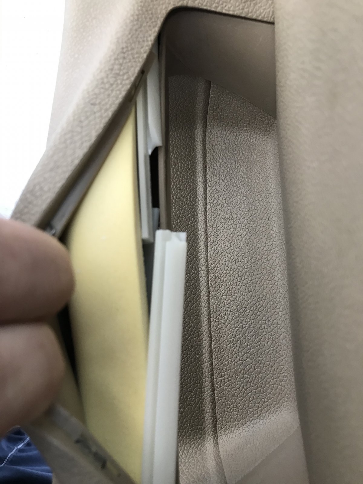

A customer wants me to try the same thing for an Explorer. They have similar issues, but with the door panel armrest. How exactly did you utilize the spreader? Also--maybe try some heat from a hair dryer on the area where the zip ties were holding. That might smooth the indents out a little bit more. Came out excellent. Good job :waytogo:.
@Tonyrodz
Looking at the picture, you can see where I peeled the two parts back to reveal the inside. You really only have the width of that piece of foam minus a bit. I did not take photo of the cut up pieces, but I measured the width and height and dry fit to make sure the lips would close properly. That was just my best attempt at making it a bit more stiff once adding the foam. Because that BS plastic piece is tragically thin and brittle.
I watched one video, where the guy took apart the shrapnel and epoxied it all back together. I gave up before he finished as it wasn't worth the time to put this stuff back together. Once it is broken, IMO, it needs another objective to fix it, like the one I tried seems to be the trick.
Good luck man!

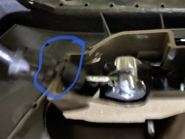

The driver’s side exterior door handle has been replaced. I hate those damn plastic, crappy handles and the tight, blind, sharp edges and no visual to work with.
Managed to drop the bolts inside the door a couple of times, get the lock rod stuck on the inside of the door handle cable, only to realize once it was bolted up and had to disassemble, broke a piece of plastic near the interior door pull cable retaining ring and then and then and then....
grrr made an easy project into a challenge mainly from frustration. Grrr

Thx man. I did both - anger and idiocy lol. And I had no choice as the old handle insert had popped out so the new handle had to work. Especially with short road trip tomorrow.
Job is completed, but breaking the small bit of plastic pissed me off!!
Fuzzy because dum dum got frustrated and didn’t release the cable in the first place and then hunting for the dropped screw and pushed the panel too far then pop... the little bit broke off.
So I drilled a tiny hole and used a zip tie to hold that black spring clip tight so that the cable with the metal bit on the end wouldn’t jump out of where it slots in, thus making the interior door handle useless if it did.
I could just hear the wife calling me to say the door handle broke and she couldn’t open the door. Lol grrr
