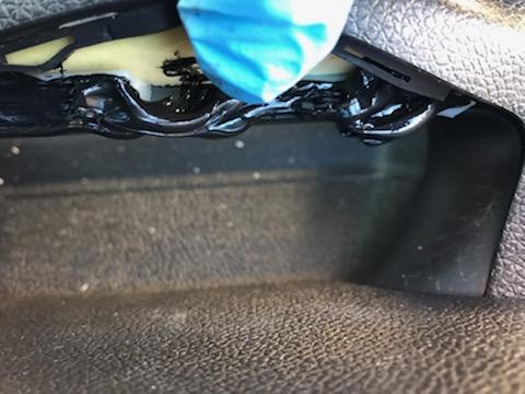

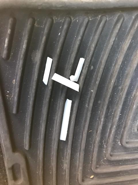

Frustration with the grab handle forced my hand. Someone told me pop stick and adhesive was the driveway repair. I decided to dig in.

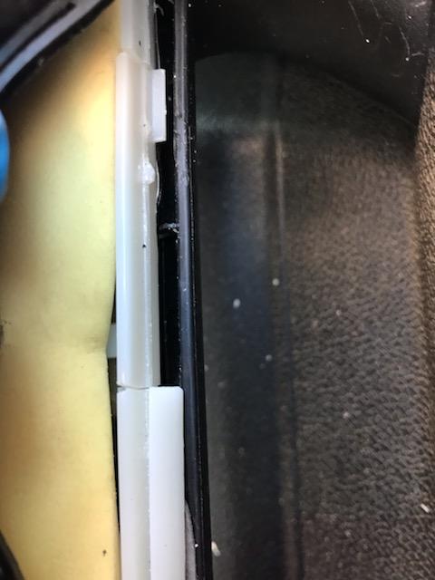

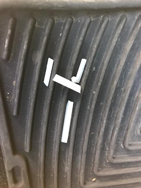

Pulled back the loose door outer cover, saw the broken substrate that holds the cover in place at the grab handle.
Broken pieces

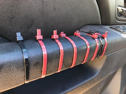

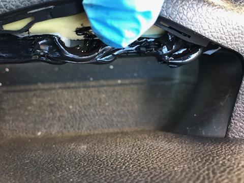

Used JB weld and a small piece of shim stock and tied everything back together to recreate the snap in flange that the cover is supposed to snap in place on and over; then filled the area with a good sized bead of High temperature resistant Permatex Black Silicone
Then push the cover into place until you feel it clip over the attachment flange you rigged back together. Once its in place use wire ties every 3/4" or so to secure it tightly in place for a 24 hour full cure.
Clean up with Alcohol works well and although I know there will always be some residual you wont get out, a spray of armor all should make it look good as new. Cut off wire ties next day. I expect this is going to be a permanent repair.

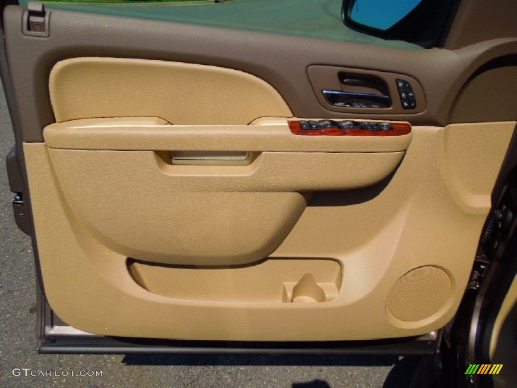

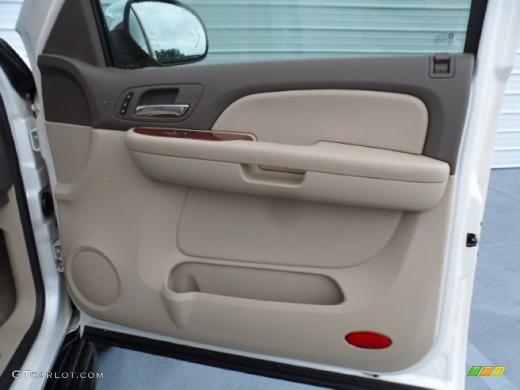

The 07-09 front door panels are a little different than the 10-14 years. 07-09 had a smaller grab handle (that doesn't break) than the 10-14, and the lower portion of the panel is different as well.

How's it holding up, and how does it look now?

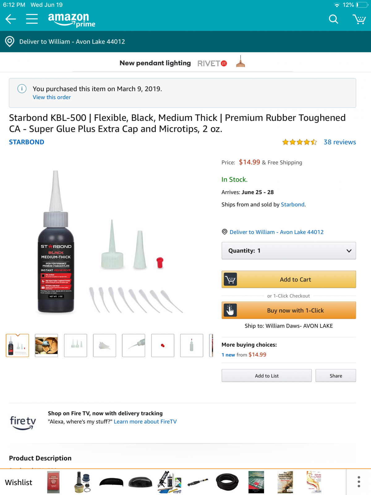

It’s still holding up, but I feel the seam of the door handle is out of position. I’m going to use some Black rubberized superglue to finish off the seam. I used so much Silicone on the repair, it’s never coming off.
33,336
51,819
They have black rubberized superglue?
This explains why I never had this issue with my 08 Tahoe. The 2011 I’ve got now has a really loose door pull
Still holding up great. JB Weld and High temp Silicone will outlive the truck. The only thing I don't like is that you can feel the lip of the grab handle rubber when you wrap your hand around the handle to pull the door closed. The tab or edge should be seated tight against the plastic and it isn't. The handle cover is not loose in anyway, its just that you can feel its slightly out of place from "perfect"
