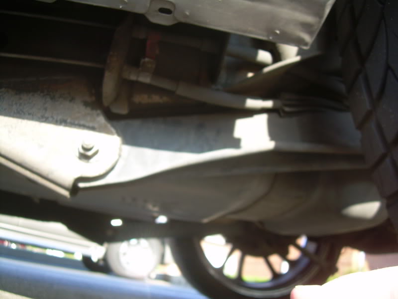

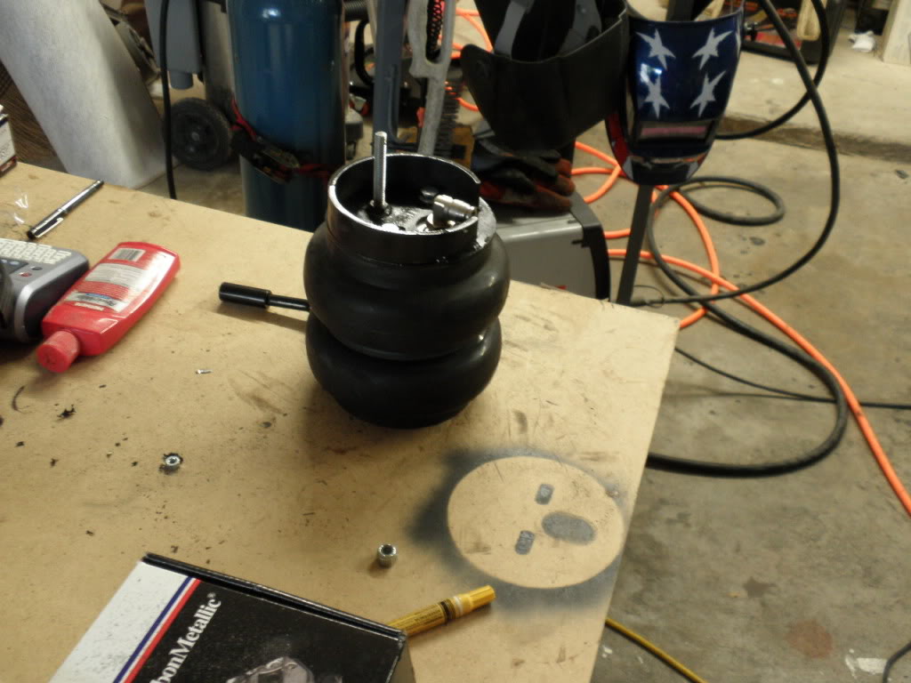

Here are some pics of the rear cups I made..
Oh and this is as low as it will go with the factory 4 link....

Is that with the bags in or no spring at all? Any issues with sway bar hitting? I'm curious to see how those work out, you should measure the rear fender height aired out too :cheers:
ItsAdam1
Master Fabricator
Jun 7, 2009
78
Sugar land, Tejas
I'll measure it aired out in the mourning...
But out back that pic was with the very short cups and it aired out

do you still have the trailing arm? is that what it is laying on? im thinking about fabricating a new one so i can get as low as this one cus my truck is just dropped and the arm is very close to the frame and is hitting it i believe...
and this is my arm on my truck with just a drop..
---------- Post added at 03:57 AM ---------- Previous post was at 03:55 AM ----------
that and im hoping i can find the install pics of a truck set up like that so i can get some ideas for the suspension set up for my air ride
---------- Post added at 04:03 AM ---------- Previous post was at 03:57 AM ----------
my bad adam i forgot i talked to you on GMfullsize and you said you did have the rear arms still

LOL No problem, I still need to get those pics of how my front is set-up.
and yes I am still on the factory four link in the rear. I would love to get my back end as low as that blue one but I think it cut in the back. If I remember I think he was on car domain a while back.
