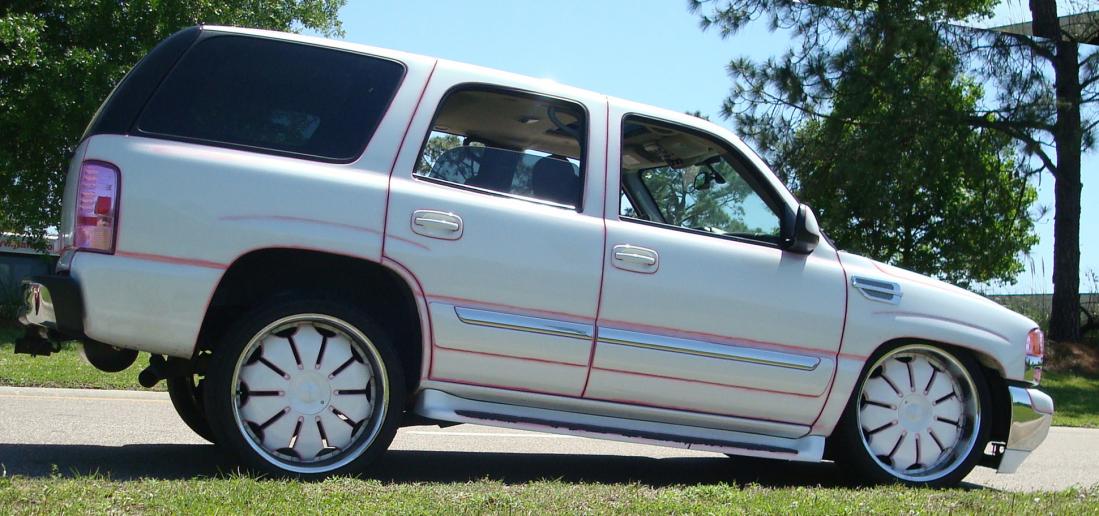

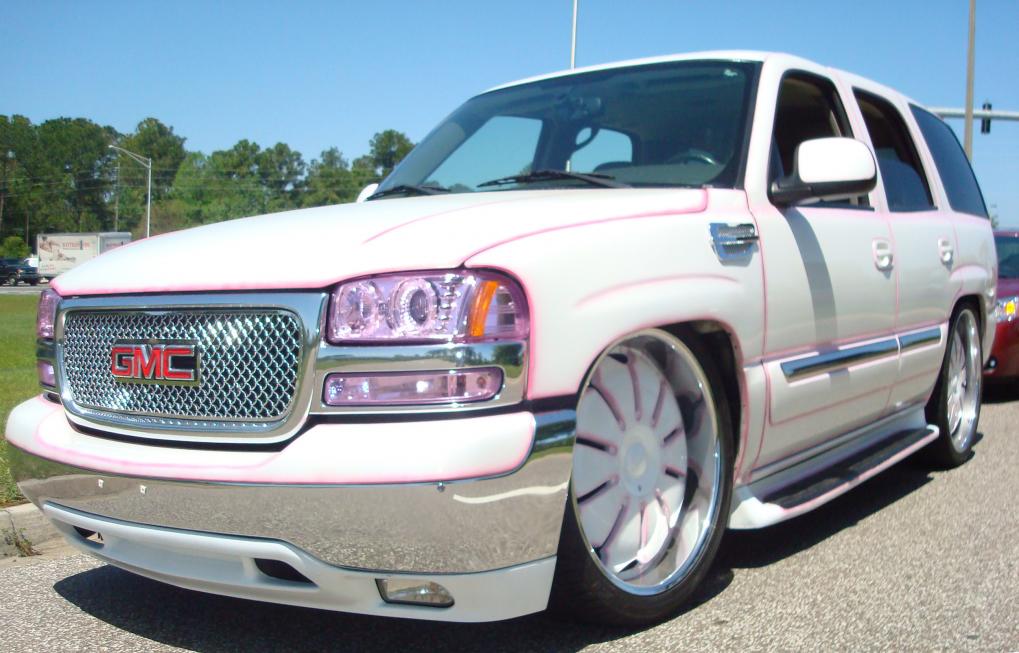

Sorry .. no pics.. its in the shop getting some more done.. i but here it is full up and full down with bags in the stock location with NO mods done but removing the sway bar and nitro drop shocks.

Lift? Ride Quility? hahahaha not for me lol, Its all about being low, I can build a 4 link and notch myself, Back in the day on my first air bagged project I way over payed for really crappy work so no one works on my ** lol. Are your bags still over the axle? Did you have a custom crossmember made? Do you still have a stock floor? Love the white on white btw

no.. mine has a triangulated 4 link but i didnt take pics before we put it back in the shop for more work.
in THOSE pics the bags were over the axle. and aired out its sitting on the bag''
