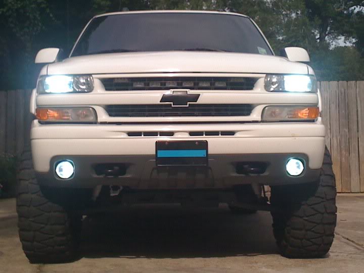

i ended up doing a 6 hi mod for him. now he has to much light output.
55watt 6000k low
35watt 6000k highs
35watt 6000k fogs
lights up everything and he hardly ever turns off the highs.
