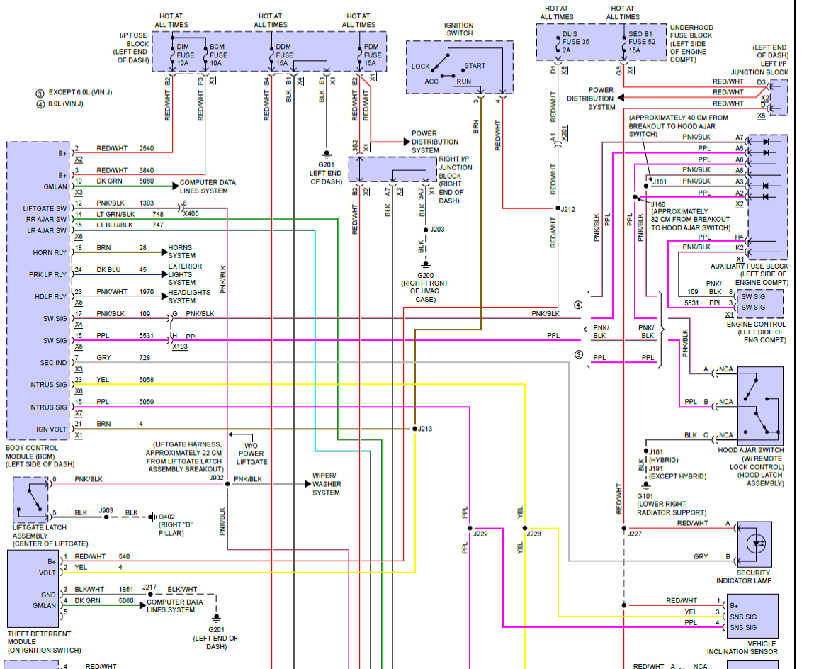

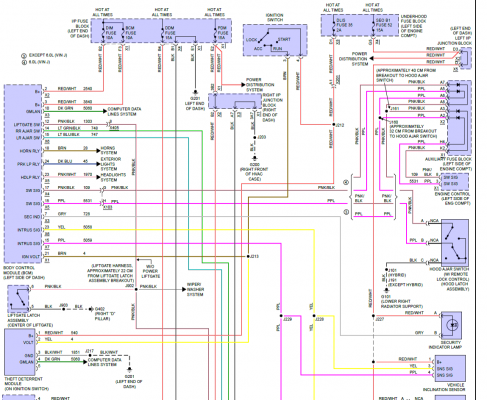

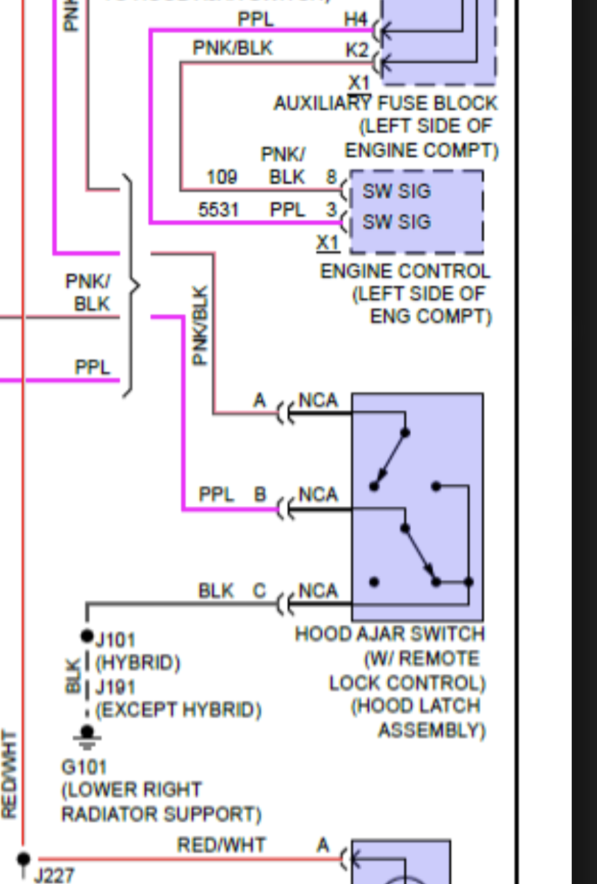

I'll up load the diagram for anyone that wants to try it. the hood switch is wired so that the ecm knows if you just disconnect the plug, and throws a fault code. so you will have to jumper terminal a and d together(leaving be open) to tell it the hood is open when it's not.
I put a 3 way switch on mine, so I can flip it one way to work like normal, and the other way to bypass and tell the ecm it's open at all times. the plug is a few inches to the right of the hood latch as the easiest way to get to the wires.

to wire in a switch you need what's called a single pole double throw switch. that's a on/off toggle switch with 3 terminals on it. that will allow one position to act normal and the 2nd position to tell the ecm the hood is open when it's not. for a 3 position switch, you'd have to look at the wiring diagram and figure that one out. I didn't go that deep.
take a look at the diagram in the first post to get a feel for what the ecm sees from the oem hood switch. when I get a min I'll try to send you a little crapy hand drawn diagram. it's not great thou haha.

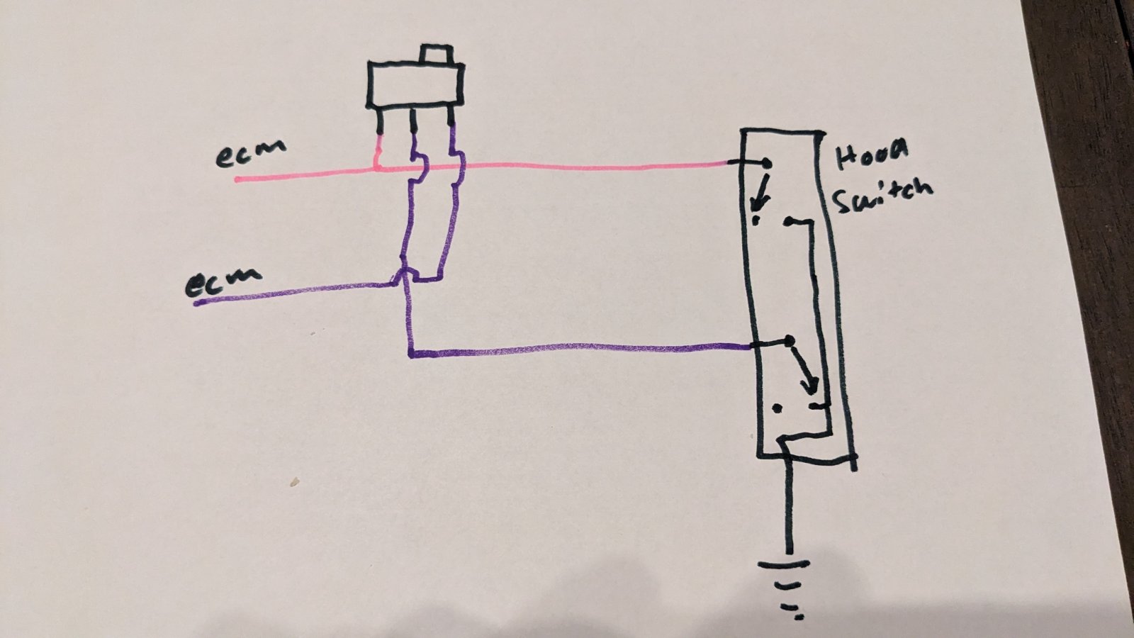

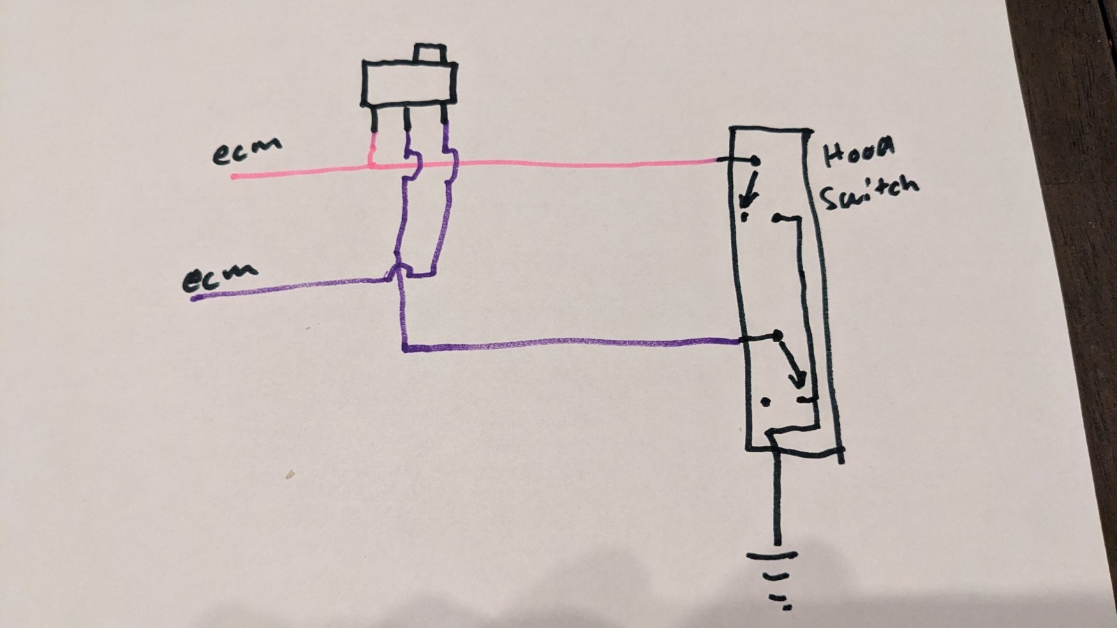

here's a very crude diagram. but basically the stock switch puts ground on the purple wire when it's closed and then when you open the hood purple loses the ground and pink is the now grounded to the ecm.
the switch is wired so that in one direction it works normally, but flip it and it sends ground to the pink wire with the hood opened or closed.
the hybrid battery will still charge normally by the engine running and during regen braking. only difference is it won't go into auto stop. and you will get a dash warning that says hood open, but push any button and that goes away.
