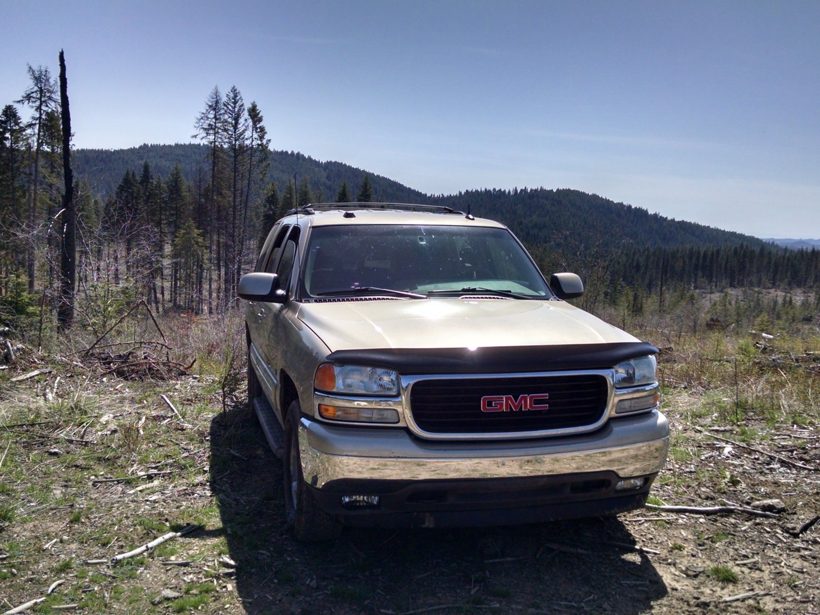

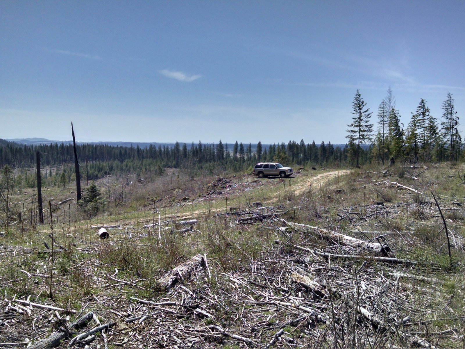

Beautiful spring day in Northern Idaho so I decided to head into the woods to see if I could find some morel mushrooms. It's a bit early, but I thought I'd take a look anyway.
The spot I go to I have been a few times in my pickup and have never had to use 4wd or had any issues. It's a mild logging road and I've seen Subarus up there.

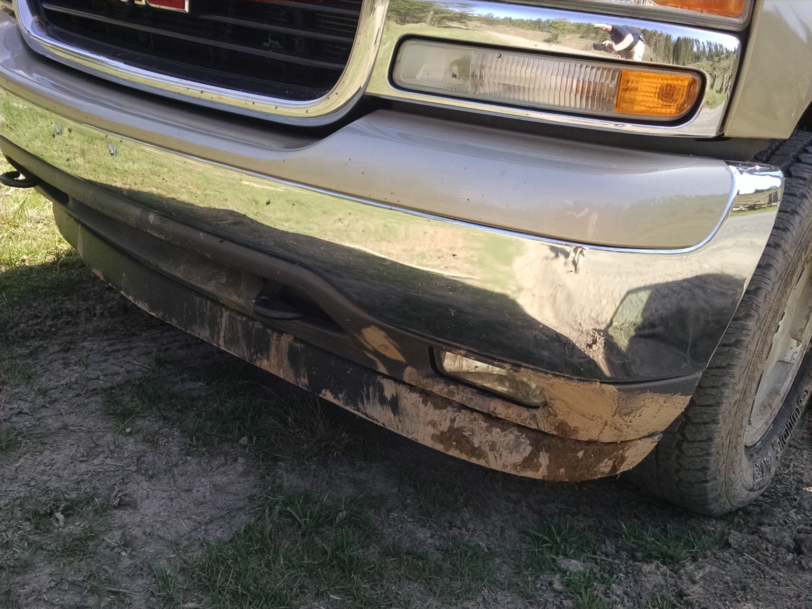

Was a bit too much for the Yukon. Bottomed out a couple of times and scraped the front air dam a bunch. Had to use 4wd once.
Probably going to have to remove that air dam, crank the torsion bar at least an inch, and with the extra inch of the tire height, it should help out quite a bit.
I really wish there were some decently priced front bumper options for these rigs. Do I have to buy a bumper specific for the Yukon, or does a Tahoe/pickup bumper work?
Will have to just get used to the limitations of it compared to my pickup.
Oh, and it was too early for morels; only a couple tiny ones were out.

The 2009 owner's manual says to take the air dam off to increase ground clearance but to more closely monitor the engine temperature while doing so.

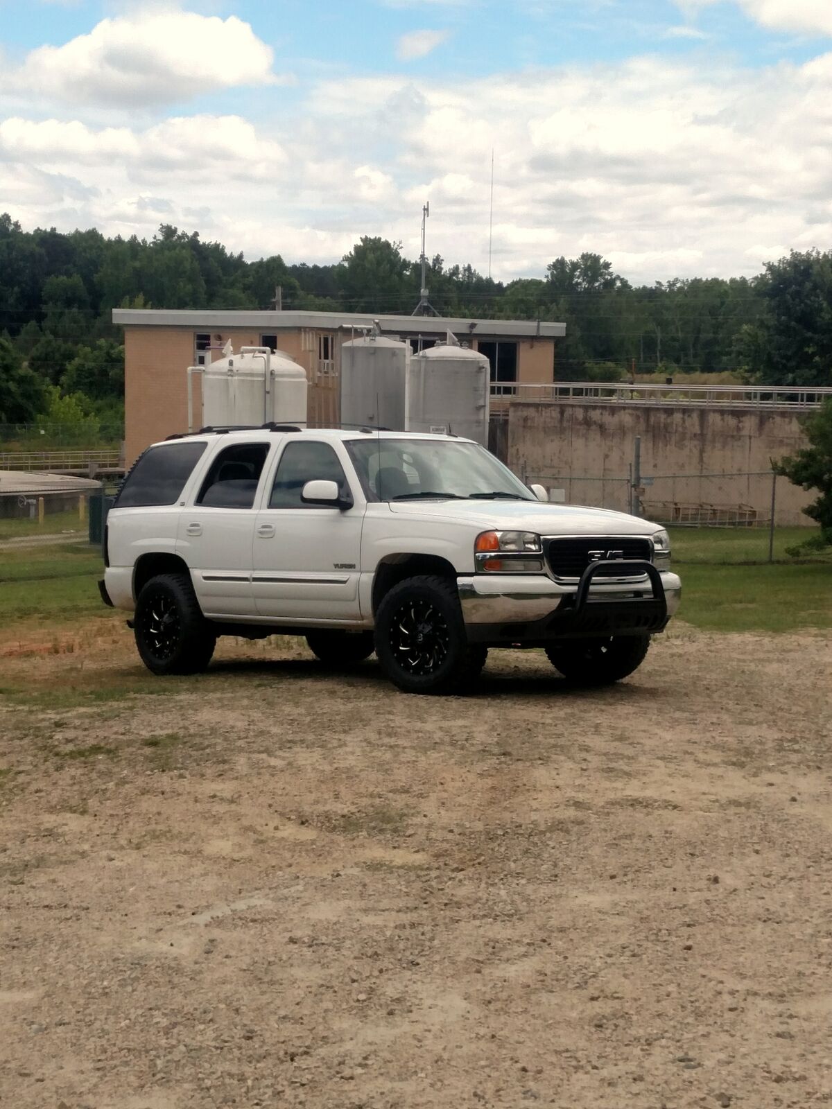

We take our '16 into the mountains all the time. And on some OHV trails. Nothing too extreme of course. But we lifted it 6", put 35" MTs on, a Fab Fours bumper and Smittybuilt winch put on. Sounds like you need a little more clearance

And a bumper for similar model years for Tahoe/Suburban and Yukon should all be the same.

Rip that airdam off, throw on the good tires and make sure you have skid plates. My Yukon is a tank off-road .Do you have the locking rear?

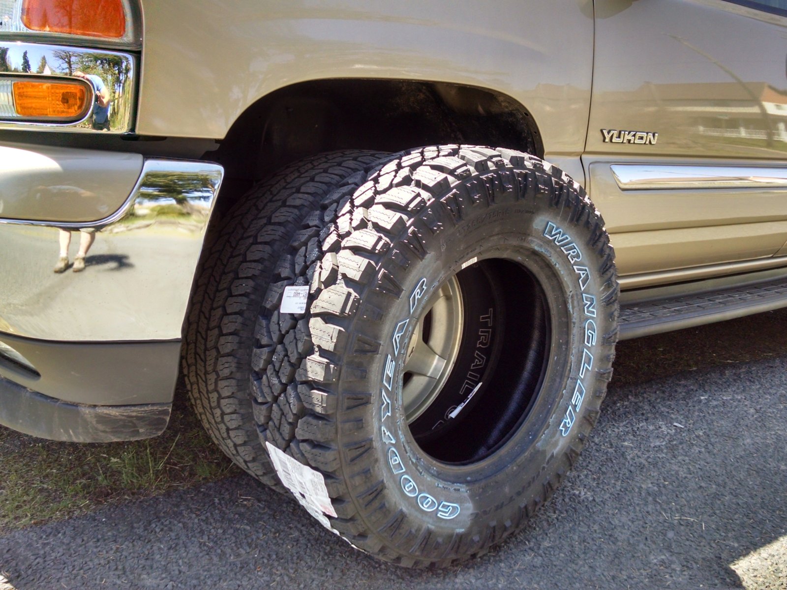

Took it back out yesterday and it is much improved. Still haven't got around to removing the front air dam and am on the fence regarding removing the running boards. I really liked them on my pickup and used them quite a bit. But this Yukon is so much lower, I'm not sure I use them.
Anyway, drove about 80 miles of gravel and dirt roads in the mountains, including the prior logging road that it did so poorly on last week. Definitely did not have to put it in 4wd this time and actually took it into some fairly deep mud holes and was able to get through them with moderate tire spin and no 4wd. The rear locker definitely helps. Very happy with the tires and it was able to get me everywhere I wanted to go.

definetly take off the air dam, it takes 5 minutes and it drives the same but gives better clearance. took my 5 minutes or less to do. you could leave the running boards on to protect the rockers if you wanted but it looks a lot taller without them
