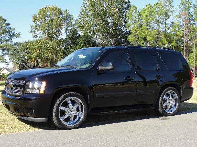

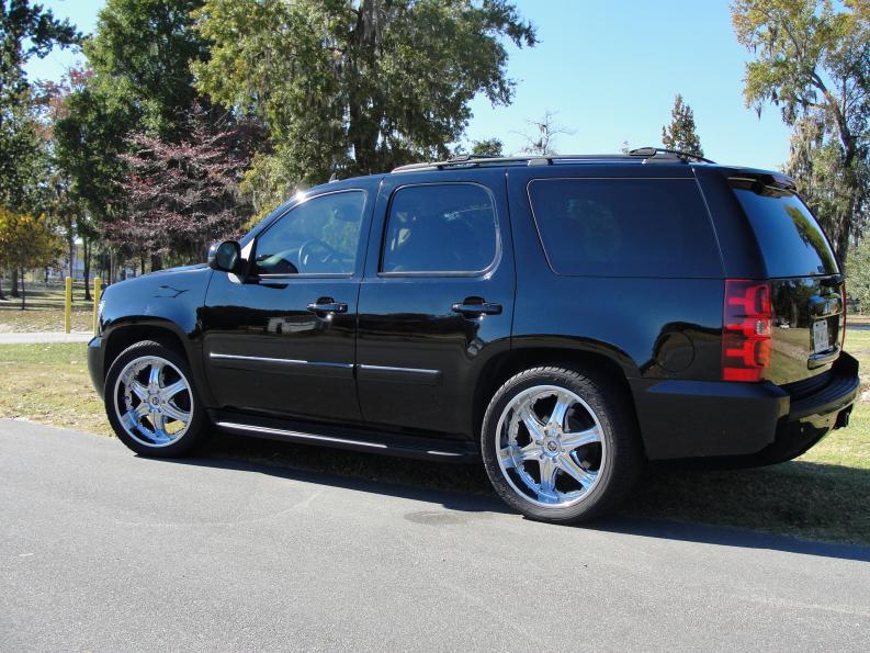

I finally got around to getting the 3/4 BellTech rear springs and shock extenders on Tahoe. Swapped out the 2inch Eibachs I had on rear to even it out with the front, so now its completely level.
Also spent the last 2 days removing the badges and pinstripes.
Now I need to fix the ugly gold chevy logos on front and rear

When I got the truck it had 2 inch eibach drop springs on the front and rear. I wanted to level it out, so I put the belltechs on the rear (ordered from Tony). I used the spacer on the rear for a 3 inch drop and now its completely level. It was a little stiff at first, but now the ride is good.
Tires are 305/40/22. I think the ride quality is more effected by the tire size than the springs.
