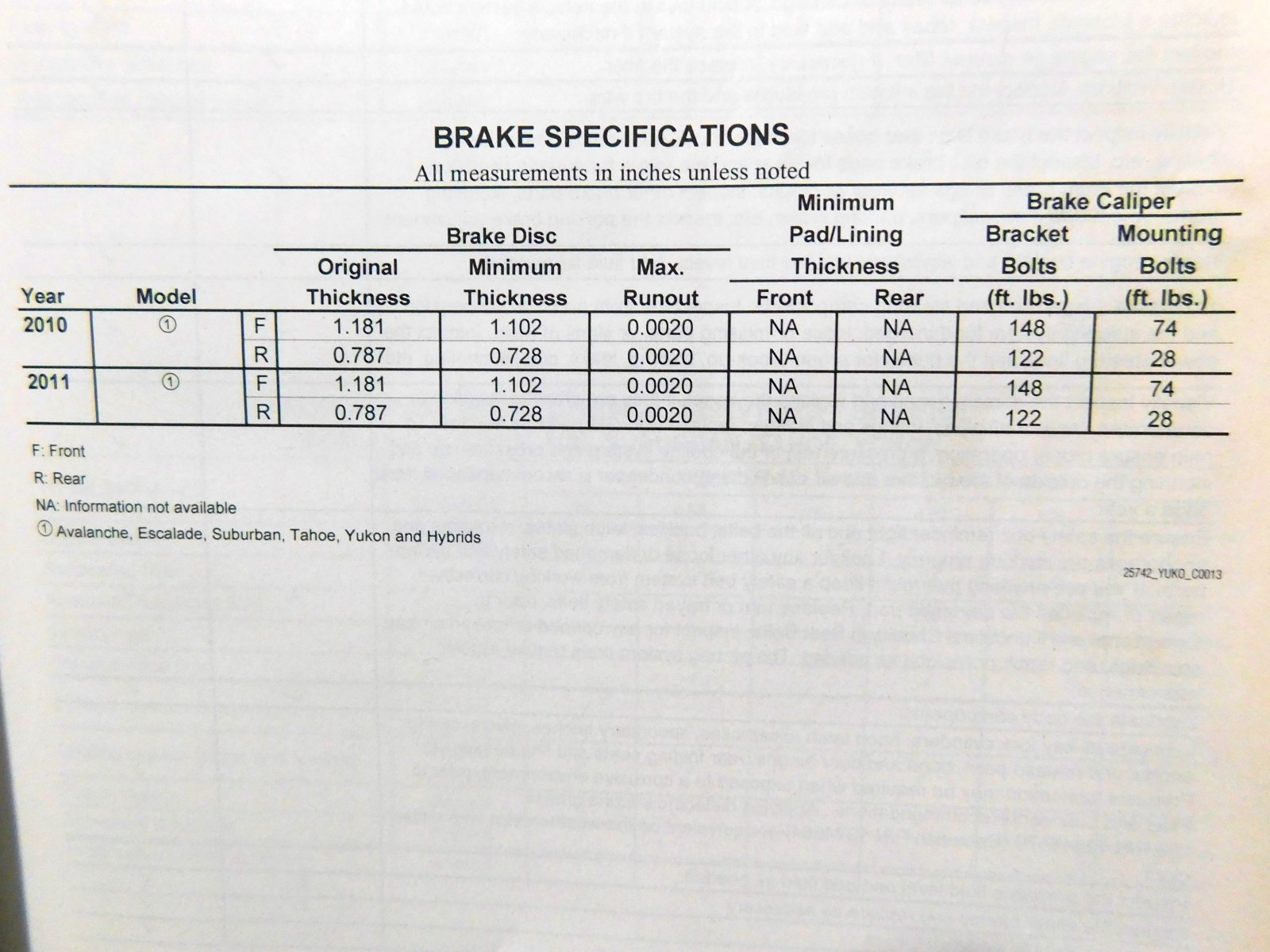

I am resurrecting this because of conflicts in information on brake component torque specs between different sources and hoping someone can provide the correct information.
This is related to 4wd Tahoe, 6 lug wheels.
As an example of the issue, the Haynes Manual 24067 and the above referenced manual (https://charm.li/) differ on the rear brake pins (Haynes 38 ft#, other ref 28 ft#) and the front and rear caliper mounting bolts appear to be opposite in the two manuals (front to rear comparison) as well as varying a bit off in one of the pairs (Haynes Front 129 ft#& rear 148 ft#, other ref front 148 ft# & rear 122 FT#).
And AI, well, garbage information as usual.
Anyone have a GM manual or other dependable reference, specifically for the brakes?

If I had to guess, the haynes probably has front and back caliper specs flipped. (Front being larger and handling more braking)
I don't think you will hurt caliper pins going to the higher spec of 38ft/lb.. (unless the screw is smaller than I think?)
So to answer your question, I don't know!
