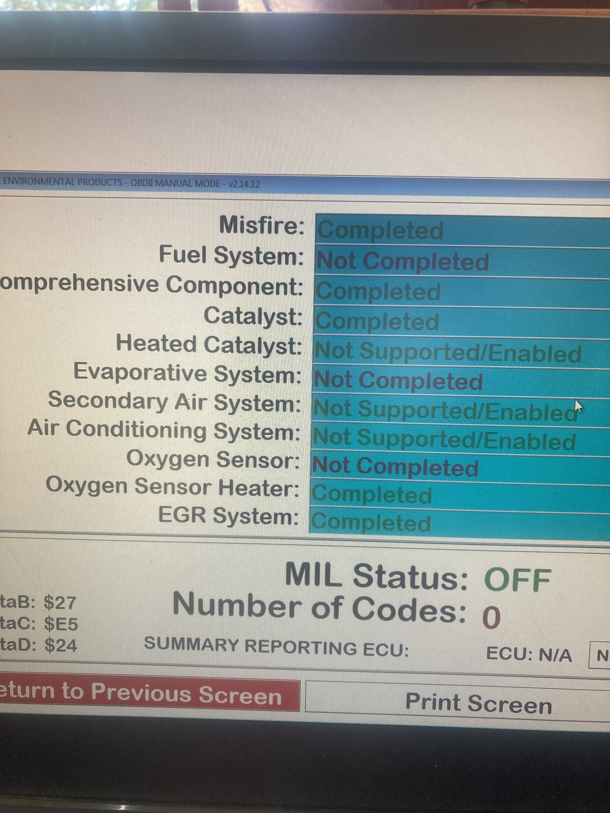

Haven't done any mods, replaced the alternator a couple months ago. Drives great, no issues or lights on the dash. I use a range obd plugin but I took that off and it still failed. Any suggestions?

We've heard that unplugging the Range device can reset some of the monitors, although it seems to vary. Anyway, your pic is showing that there are three monitors that have not completed, and usually you're allowed only one incomplete monitor. You'll need to drive it for a bit without the Range device to get the monitors to set, so be sure to re-check them with your scanner before going back to retest.

I'll try driving it around without the range device in, we'll see if that helps. It was failing on 4 monitors but as soon as I unplugged it I only failed for 3. I'm in Tx but I don't know how many I'm allowed to fail here. Thanks guys
