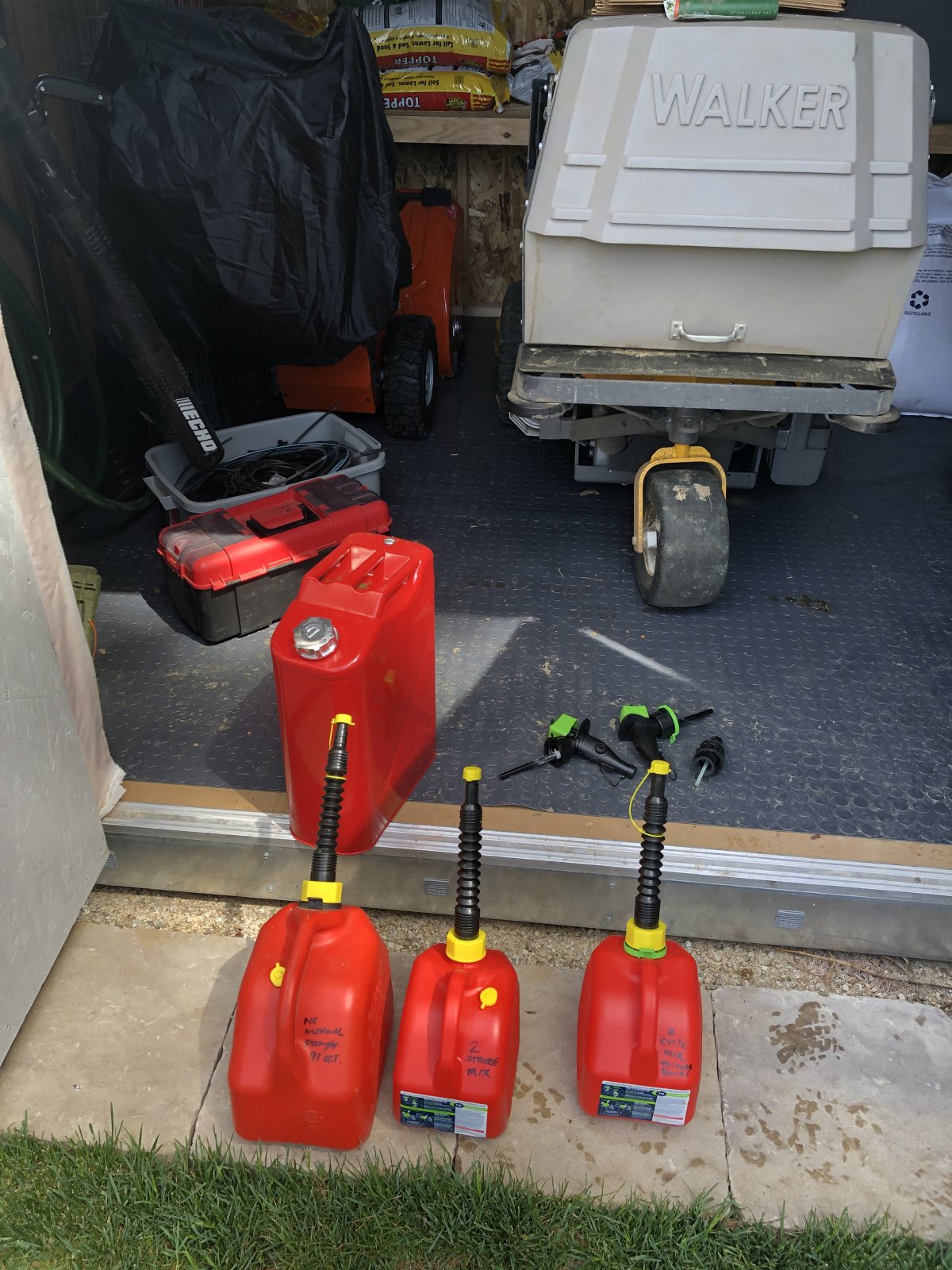

I scored a couple of 5-gallon race cans off CL a few years ago. Love 'em! I feel like a NASCAR pit crew member when I'm filling up my mower and I turn the can almost completely inverted and the fuel shoots through the 3/4" hose without a single bubble or that "glug glug glug" shit.
Here are my modified cans with the gasspout upgrades, no spilled gas anywhere.
At 2 O'Clock are the dead soldiers of the progressive revolution. I just keep them around to raise my mood, anytime I am feeling a little low. :)
The jerry can I got from Jegs, not cheap, but the best jerry can I have ever owned.
No spilled gas?! You're gonna be in big trouble when the EPA hears about this!
