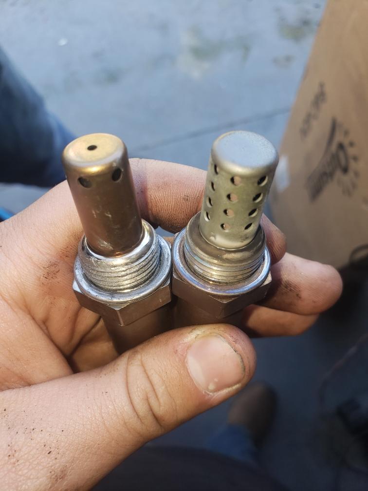

I had the issue of the virtual sensor causing truck to run rich. The problem was that I had replaced the O2 sensors with the "wrong" sensors. The local Advanced Auto parts computer said they were correct for my truck and it didn't throw any O2 sensor codes but it was clearly a different design when I finally replaced them with the correct ones. It would cause the ethanol percent to slowly rise over the course of several fill-ups. I would reset it with the Tech-2 and it would gradually rise to the 40%-50% range, obviously causing it to dump too much fuel.
Correct sensor on the left in this pic.
Correct sensor on the right in this pic.
That is one of the reasons I decided to install a physical sensor, although after installing the correct O2 sensors I never had any further issues with inaccurate calculations.
