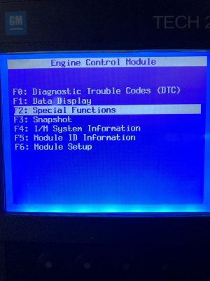

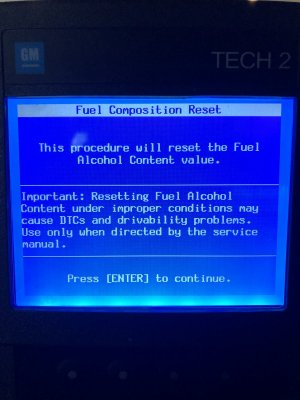

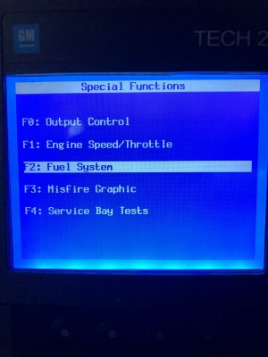

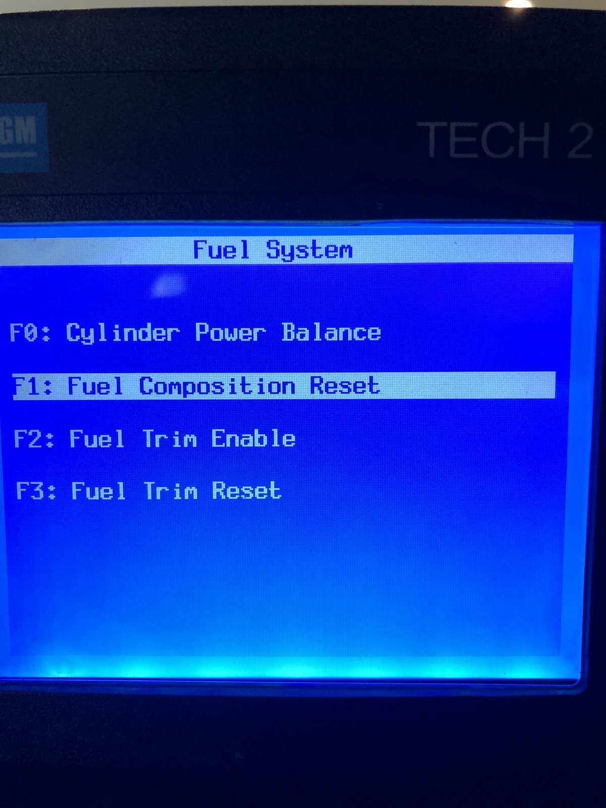

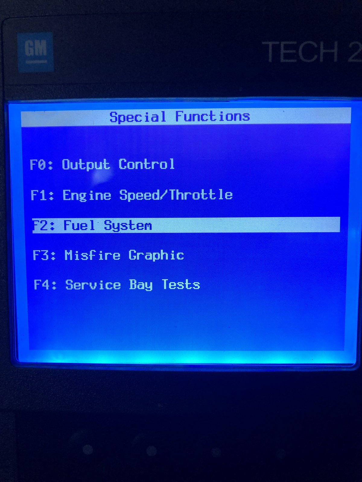

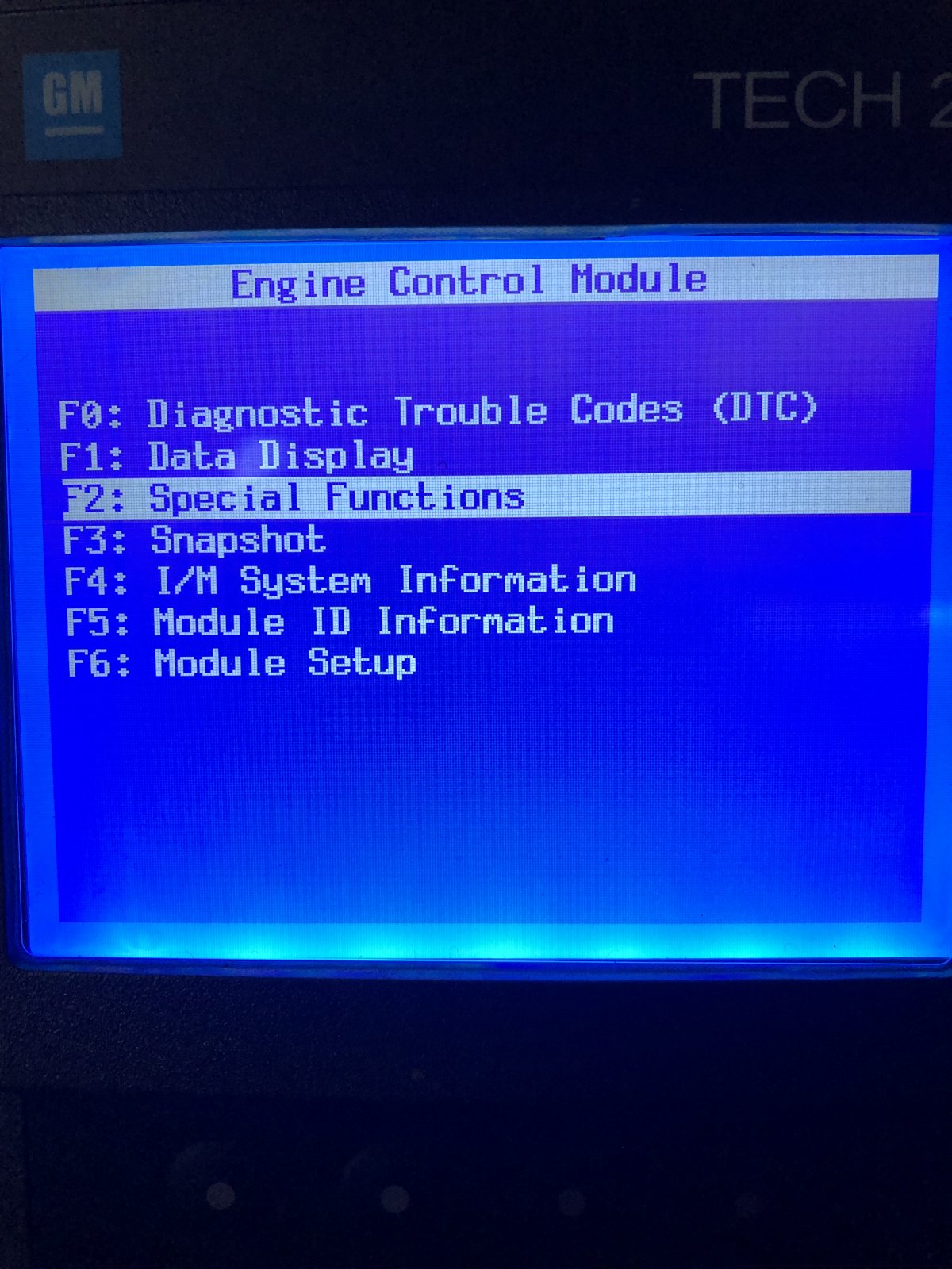

OK, here are the screen shorts of the nav to the Ethanol reset procedure on the Tech 2. This may be model/year specific, so YMMV.
