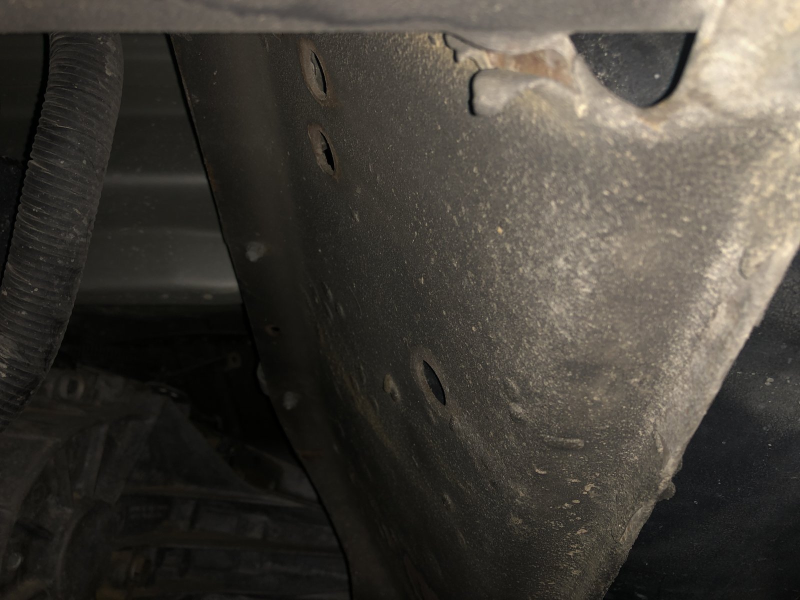

OK, here is another twist. I decided there was enough confusion when looking up part numbers for my FPCM, that I decided to drop my spare and get exact part number on my FPCM. Guess what, no FPCM on my truck that I can find. Whatever my truck is doing to manage fuel pressure, it seems very different than previous and later model years. I went and looked to see if maybe they carried the pressure regulator over from earlier model year, didn't see anything. Frankly, it is starting to piss me off. :)
I thought the FPCM is in front of the tank, mounted to the face of a cross member, kinda at a 45° angle.
In all the videos I have seen, they have them back behind the rear axle, very near the spare lift crane. But I will skoot under tomorrow and look. In any case, if it is there, it aint actually a FPCM, at least, as later models see them.
Great place for it, just across from the BM, unfortunately, like all my other explorations, just another dry hole. :(
I thought in the back was on the trucks and the SUVs had them in front of the tank. I know when I had my tank down recently, I saw a computer-looking thing that had "FSCM" (or was it "FPCM"?) whit lots of other numbers on a white label.
I think it could well be there, at least for a few model years. I know for a fact (thanks to Ken), that the 2008 models have them, so if you saw your's there, almost for sure it was there. Mine, I am convinced doesn't have one. At least, tonight, that is what I believe. ;)
