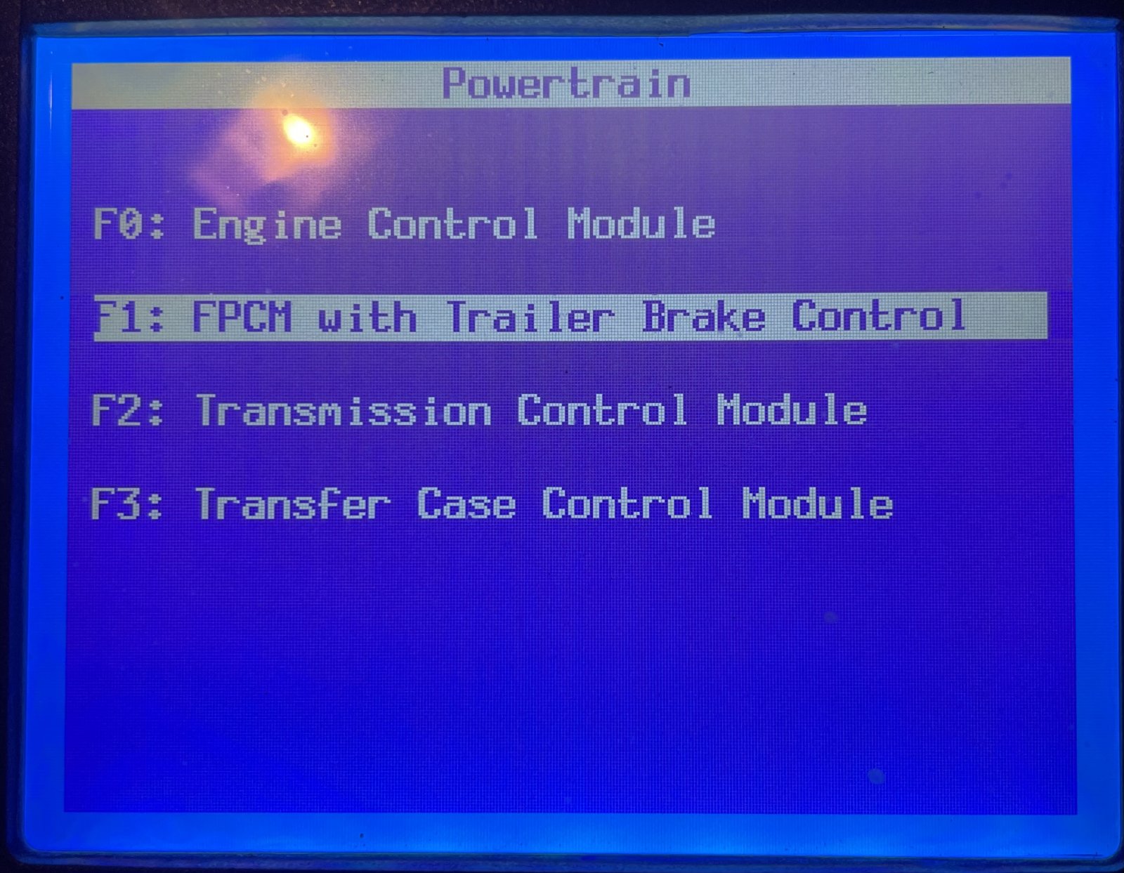

Found it! They say “with trailer brake control” so I never selected it.

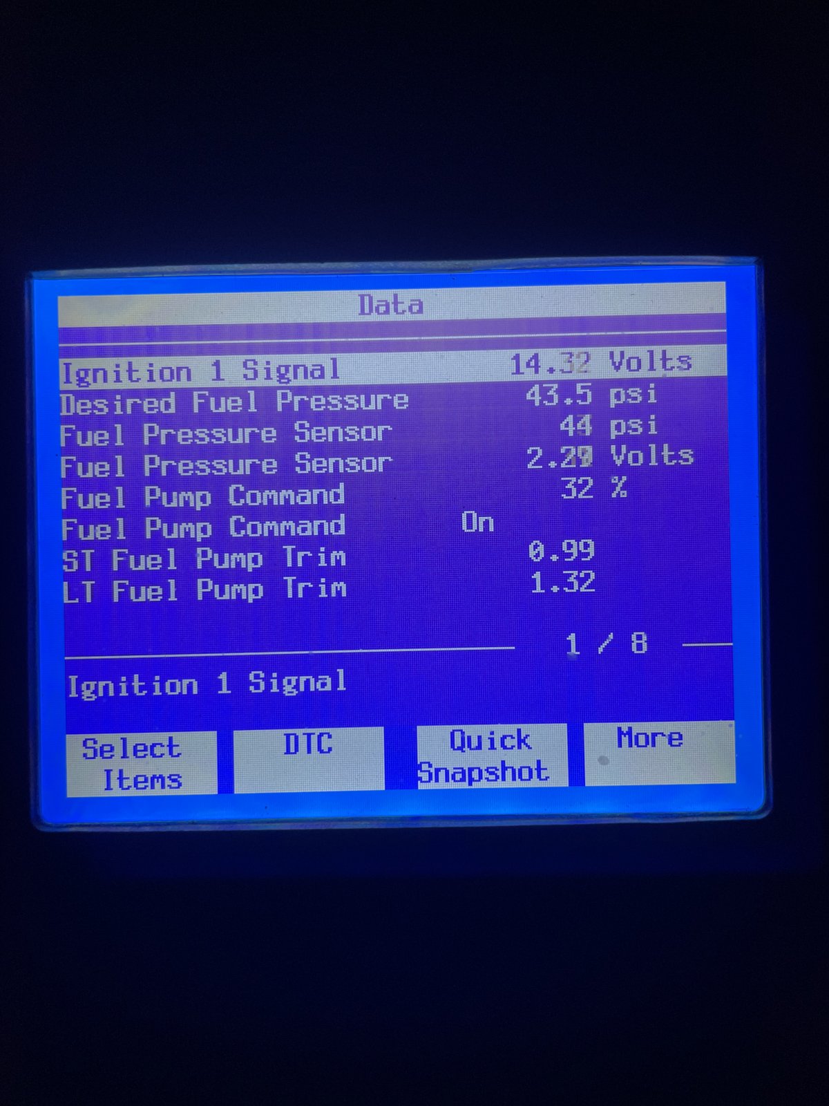

Here is my pressure at idle.
2FB79B98-CCF3-4DFC-86CA-45031BDC0056.jpeg 35859AF6-66AC-425F-8337-12F6DA3FB71D.jpeg

When I was looking at part numbers there are FPCM’s that are no trailer brake control and others with TBC. I suspect they had some pins available and some spare processor cycles, so put that option in that location.
Does your truck have TBC?
