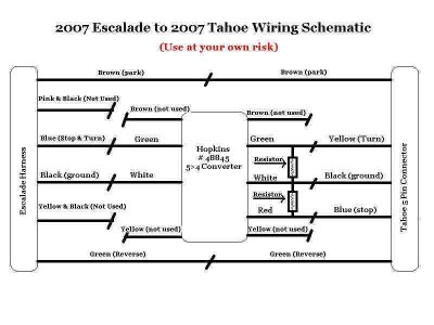

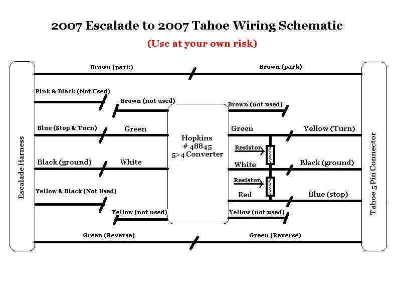

Yeah I was looking at the HID reverse mod as well but have no idea how to do that? Shed some light on that topic please, id love to do it. :Handshake: I found a wiring diagram online with the color coding of what goes where but Little confused on how I secure the wires and converters. Heres the pic I found

Someone tell me if this is right. I read the chart and put it into a list, and I wanna know if it's right for future use. :
Direct connections:
  • Brown Escalade wire ties directly to brown Tahoe wire. Does not connect to converter.
  • Green Escalade wire ties directly to green Tahoe wire. Does not connect to converter.
Wire combinations. (Escalade to converter)
  • Blue Escalade wire is tied to green converter wire.
  • Black Escalade wire is tied to white converter wire.
Wire combinations. (Converter to Tahoe) for RESISTOR 1
  • Green converter wire is connected to yellow Tahoe wire. The green wire is also tied to resistor 1. Therefore it is split in 2 places.
  • White converter wire is connected to black Tahoe wire. The white wire is tied to the other side of resistor 1.
Wire combinations. (Converter to Tahoe) for RESISTOR 2:
  • The white wire stated above is also tied to one side of resistor 2. Therefore the wire is split into 3 places. The remainder of the wire is tied to the black Tahoe wire as stated before.
  • Red converter wire is connected to blue Tahoe wire. The red wire is also connected to the other side of resistor 2.
Unused wires
  • Brown converter wire is not used.
  • Yellow converter wire is not used.
  • Pink&black Escalade wire is not used.
  • Yellow&black Escalade wire is not used.

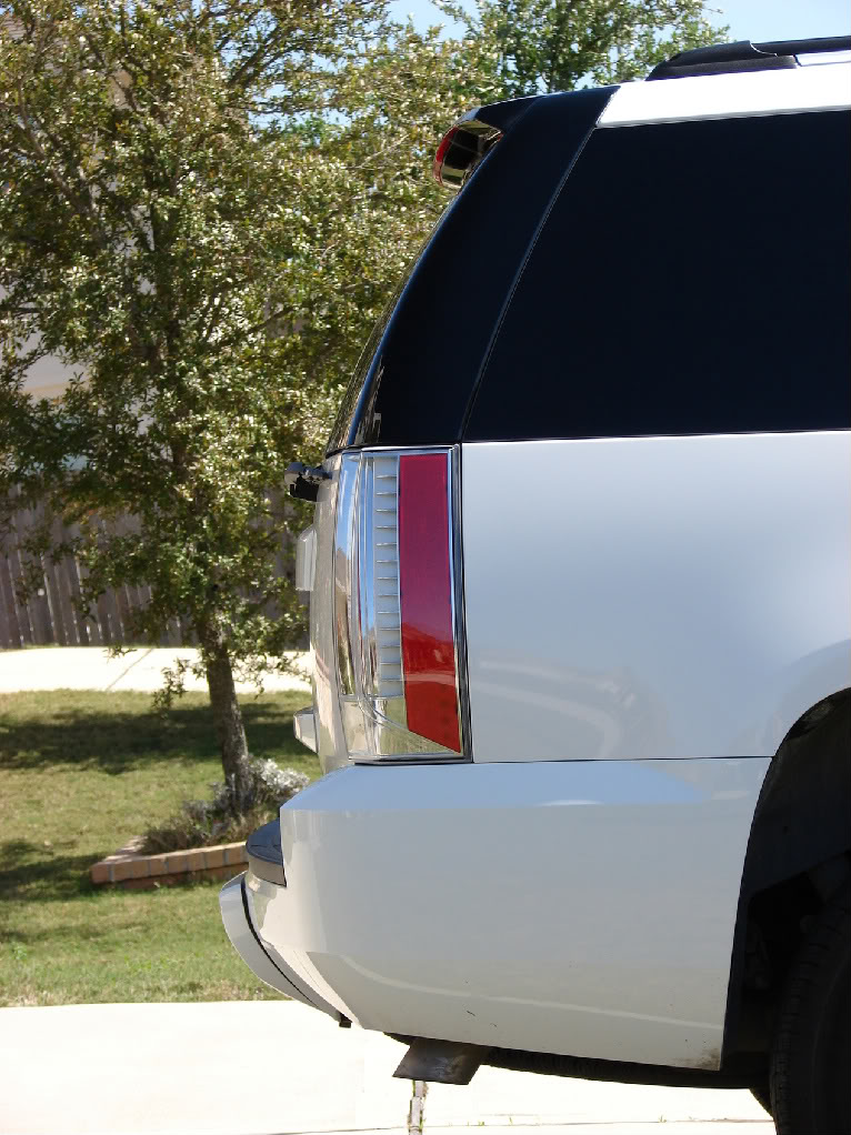

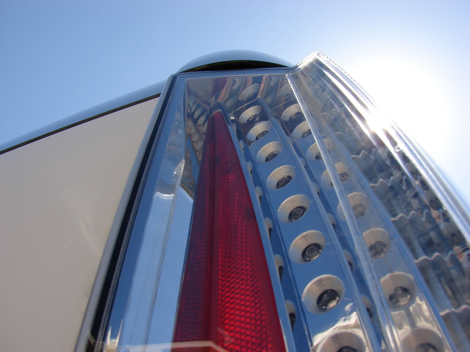

Yeah I mounted them and couldn't tell the difference.
I am glad you found it... that looks like the one I used!!! :Handshake: About securing the wires, if you mean splicing and re-connecting this is what I did: Layed out all items in a row on my workbench - the Esky tail lights with their wiring harness still attached followed by the trailer adapter(and resistors) and Yukon wiring harness(I bought new one's so my factory tails remained in tact). Once the desired least practical length of everything together could be determined I cut the wiring with a little extra room to play with since additional length will be removed by the time the splices are completed. I then removed insulation from the wiring ends and connected one splice at a time and confirmed that the expected functionality had been obtained by plugging the new harness/tails into the Yukon's harness and testing. Once all connections were confirmed to be correct I began soldering the wires together, covering the splice with heatshrink tubing followed by wrapping electrical tape around the entire length of each splice. Once all splices were completed I wrapped electrical tape around all of the wiring and splices to keep everything bundled together. The resistors I used had two mounting points on each which allowed me to mount them to one another with some small bolts/nuts purchased at Home Depot. Small rubber grommets were used to serve as a spacer between them(they apparently heat up when in use). Once installed the additional weight of the trailer adapter and resistors on the new harness concerned me, so I used zip ties to suspend it all to where the additional weight would hang from the body/frame instead of pulling downward on the housing harness. After everything was completed I had my stock tails/harnesses in tact as well as the Esky's with their harness... and from that point on it was "plug and play". This mod does take alot of time and effort (It took me a total of six hours to build both harnesses), and is more expensive than other LED tails, but is well worth the outcome :imo:

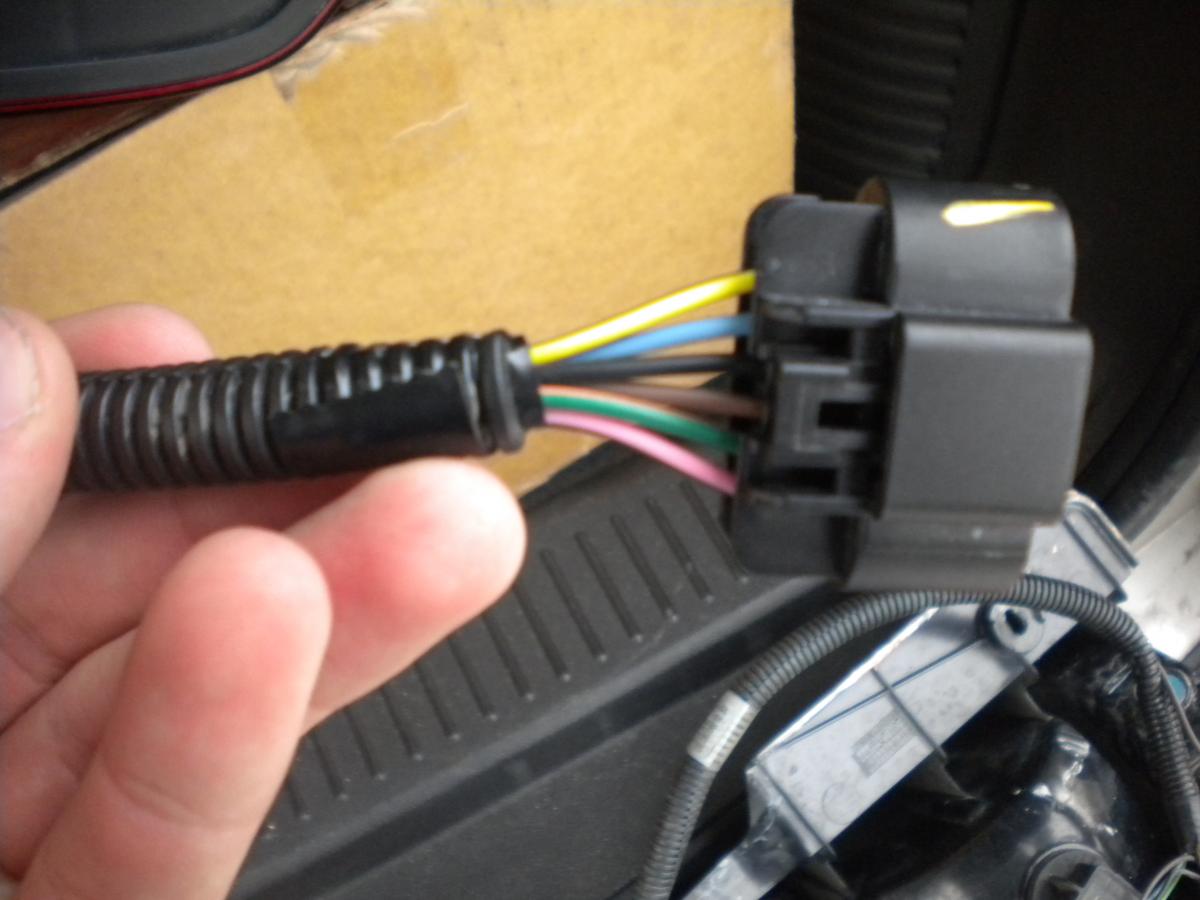

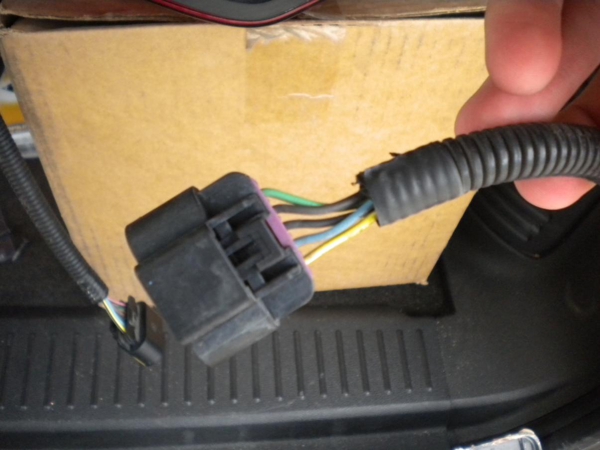

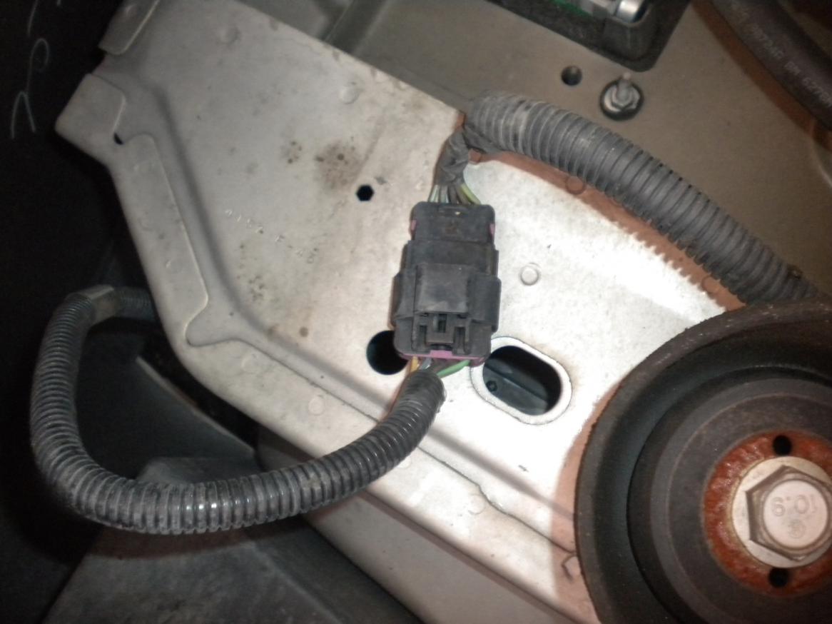

K I took some pics Im guessing I have to cut both harnesses right? Right before the black connectors? Iwaslower can u shed some light on this :Handshake:
