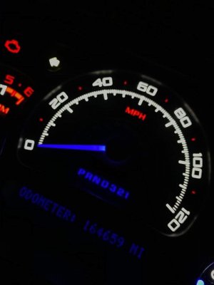

@05Single THAT IS SEXY.Could you link me to the films you used?Also the KM/H delete was a very subtle change i didnt even notice that.
05Single
afraid of the dark
Feb 26, 2015
8,179
11,434
Thanks. And sorry I do not , the builder did it . It was just my ideas . Also he added red to the dots , that was actually his idea lol. Great touch imo . 00EEA195-647F-4A6A-9279-41255D239810.jpeg
