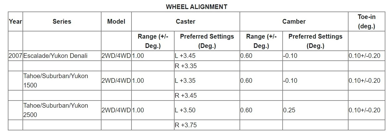

I didn’t trust the specs he was pulling up for the car so I gave him this:
Told him to swap the L/R caster settings and use the 4WD toe.
Here in South Florida I'd use that, neutral settings. I see the 2500 has more, presumably because they expect it to tow more and more often. I haven't had my '04 2500XL on a rack, so I can't say where it is. Too bad, I like the way it drives everywhere.

Just adding that the "in the green" is a wide range, I've gotten terrible alignments that were visually ugly and destroyed my tires very quickly but were "in the green" and I didn't know any better at the time to do anything about it.
