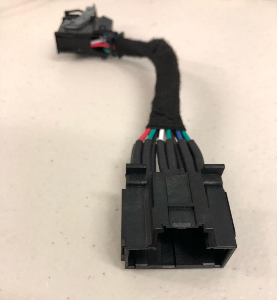

Or you can buy the pigtail harness I made.[emoji846]

how does your harness work? The dash harness is a male plug and yours also has a male plug. Am I missing something?
52,954
Look again. The dash has a female end- the original cluster has a male end. That’s the correct setup, just like the one I made.

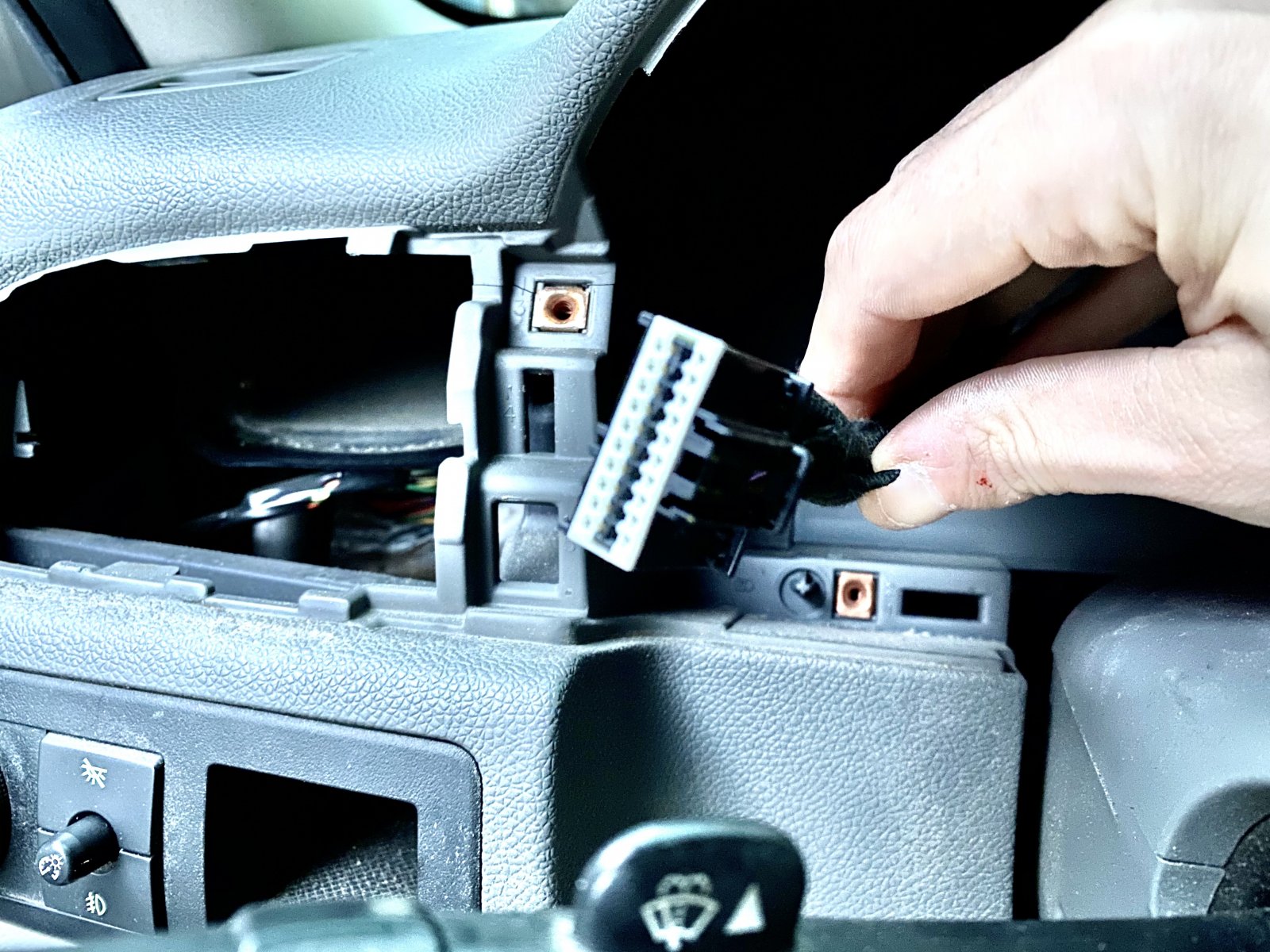

I guess my truck is different. My factory wiring harness has a male connector and the cluster is female

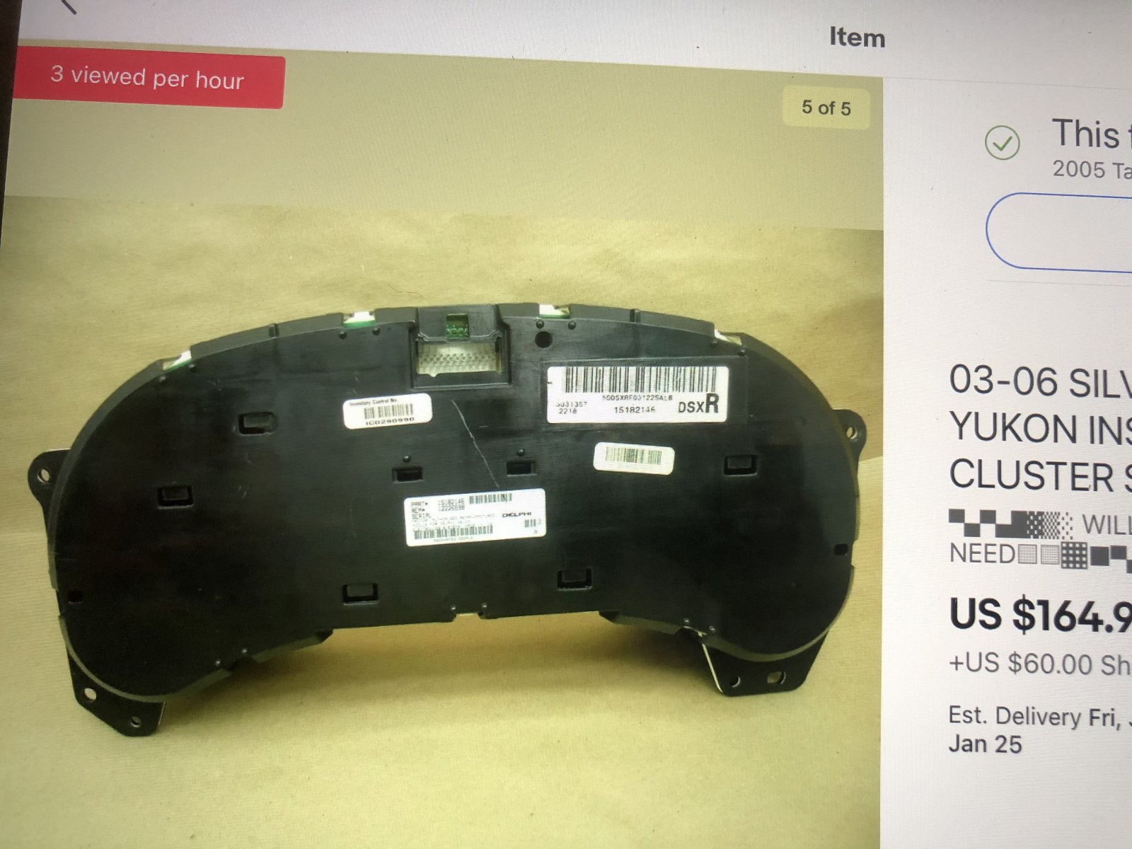

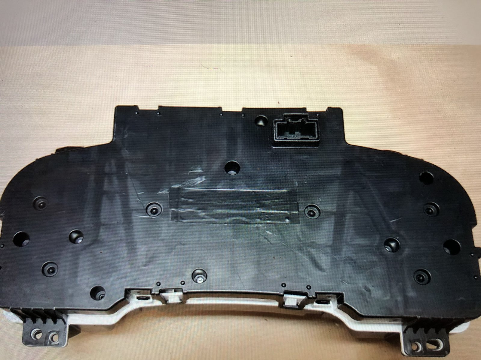

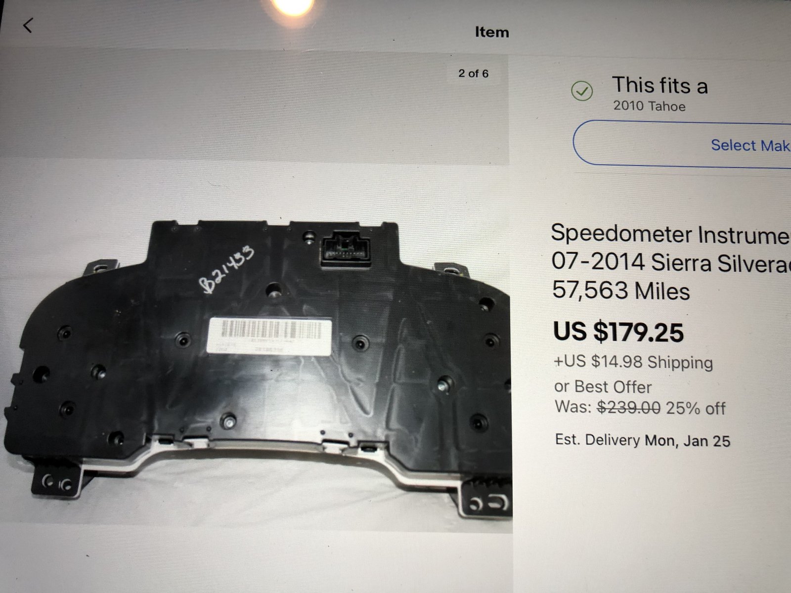

Yeah I was wrong- that pigtail is female like the cluster, it just looks like a male in that pic. What year is your truck? Let’s see the back and front of your cluster. Here’s two EBay clusters that fit 07-14’s. Yes, completely different than yours. Also here’s a 03-06 which looks like it fits your harness. Weird.

my cluster looks like the 07-14’s you posted. The picture of that jumper harness threw me off because it definitely looks like a male plug at both ends. I’ve been trying to track down a female plug because I have no issues wiring, soldering, crimping etc. I’d much rather attempt on my own. Maybe I’ll just go crazy and hardwire the Escalade plug right to my dash harness

Here’s the vehicle side of the harness.
A connector’s “gender” is determined by the terminals it houses. For example, the connector in my pic above is male because the terminals are male. The factory cluster plug that’s part of the dash harness is female because it houses female terminals.

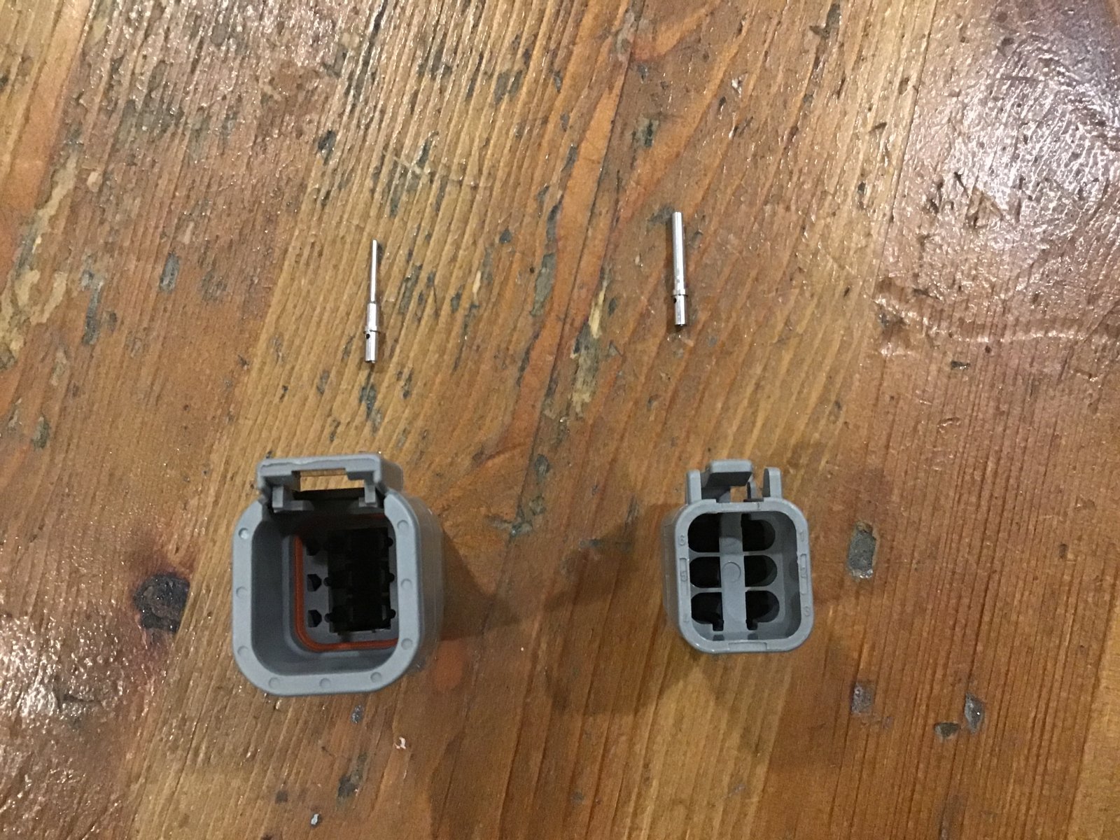

This is correct. Not having the parts in front of me caused my confusion. I’ve built a lot of wiring harnesses and have quite a selection of Deutsch connectors on hand, and that’s the way I order them. It’s the pins. Here’s one, and the male pin is on the left with its corresponding housing which looks like it’s a female while the female pin on the right with its corresponding housing which looks like a male. The left is called the male connector, right is female. If you look inside an assembled connector, the male has pins that protrude and the female just has holes that the male pins go into.
