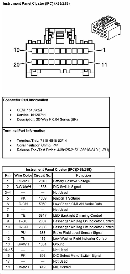

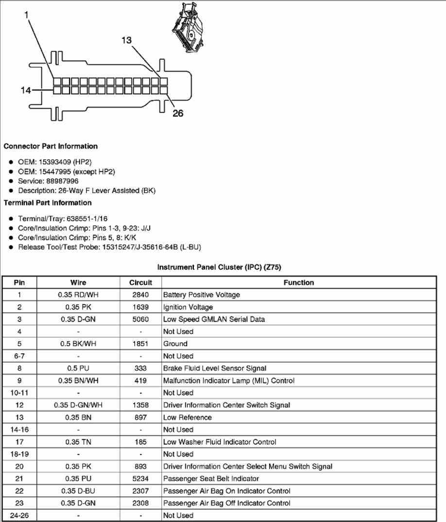

67RS427
Apr 5, 2017
595
1,217
I had trouble finding the correct part as well, this might help though since you can just splice right into the old one...

67RS427
Apr 5, 2017
595
1,217
Thank you, yea thats my last resort wanted to be able to swap between clusters so trying to figure out some sort of plug option
I've tried before but you can also try to contact https://www.mouser.com support and see if they can help. Give them the connector number on that picture and see if they can find the other end of it. Their support is pretty good...
