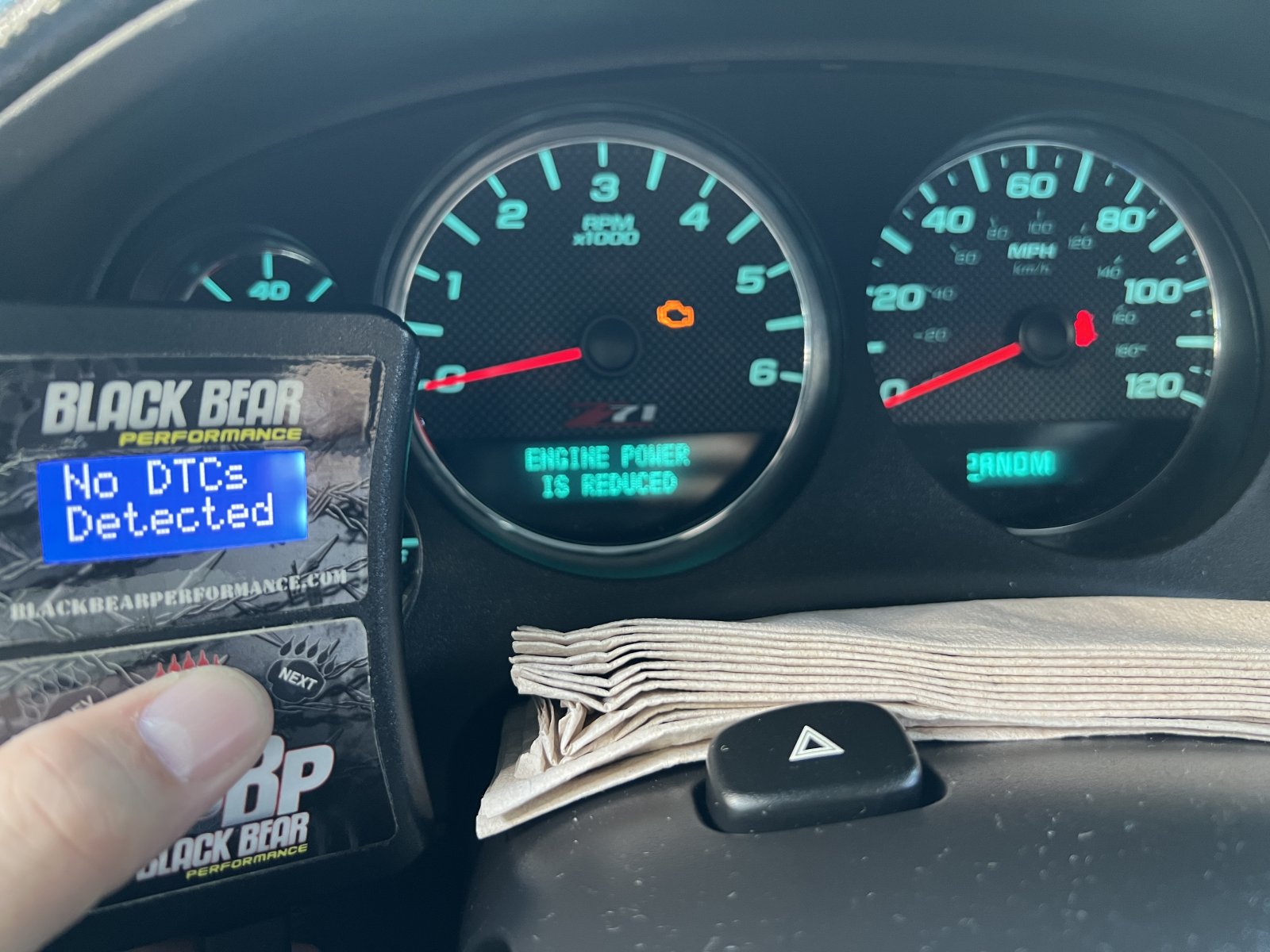

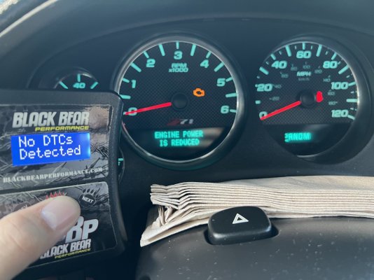

Ok. Here’s the pattern that I am getting: I have tested each scenario for multiple driving cycles.
Factory tune:
Engine power reduced message has gone away.
Blackbear tune:
Cold start - no issues
Hot soak - drive to destination (5-10mi full warm up)
turn the engine off for at least 5-10+ minutes.
The next key or ignition cycle will produce the engine power is reduced error.
I can cycle the key 1 or 5000 times and the message continues to come up
Put the factory tune on and it goes away
I have reached out to Justin / Blackbear several tikes with no response other than a tuner will get back to me over the past three weeks.
I do have a new ECM coming this Friday
I do NOT want to keep the factory tune on as I have the AFM disabled on the Blackbear tune…

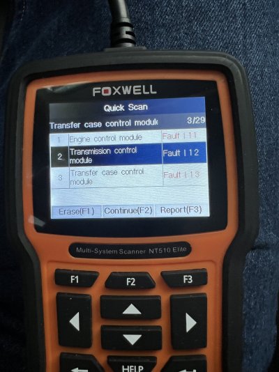

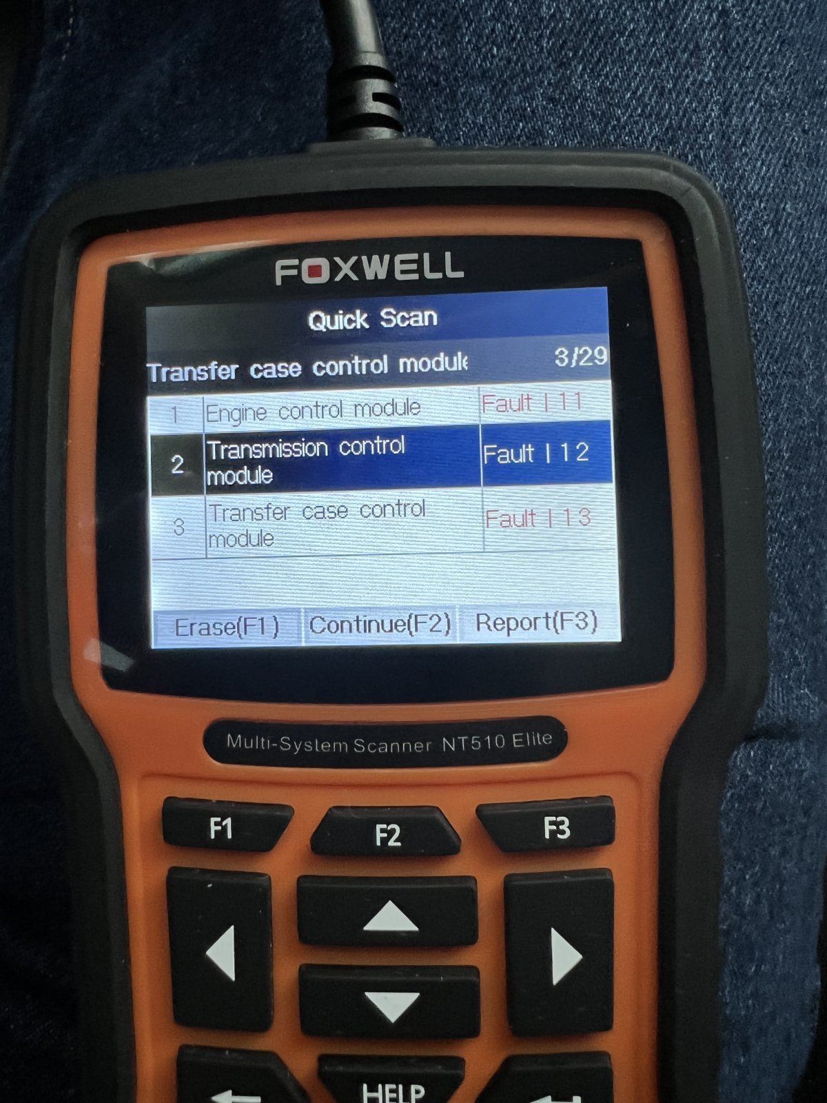

Still no real updates. I changed the coolant temp sensor and thought I fixed it as the problem didn’t surface for about a week.
It has been “cold” here in central florida…the one day it warmed up the problem came back.
BUT now I’m getting some new codes align with all the others. Vehicle runs fine…no hard DTC set. These codes come and go like the rest.
I was able to find a brand new ECM and have it in hand….looks like that may be next.

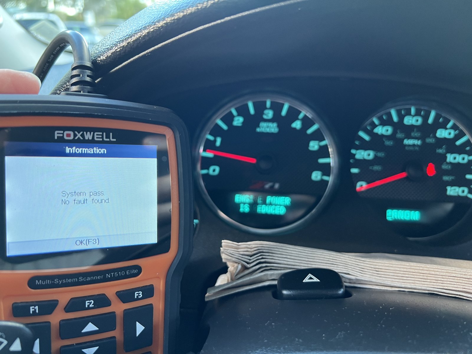

So some more driving and results:
There is no CEL or DTC being set.
Engine power is reduced / cylinder deactivation solenoid errors ONLY happens with the Blackbear tune installed and after the vehicle is fully warmed up, and a shutdown occurs (hot soak) of at least 30 min.
Factory ECM tune does not produce engine power is reduced message / cylinder deactivation solenoid errors.
New Ecm is pending dealer scheduling.

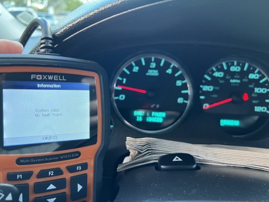

Installed the datalink LAN terminator resisotor today above the spare tire. #88988999 as suggested by another user. No change in behavior.
Engine Power is reduced message does not appear with the factory tune installed.
The instant that I put on the blackbear tune, and even before I start the vehicle (key to ON) the EPR message appears. No DTC codes set, MIL is not on.
I'm wondering since I changed the fuel pump / throttle body if the tune is somehow tied to those and is throwing the message up?
I have a few messages into Justin @ Blackbear. I'll update the post when he replies
