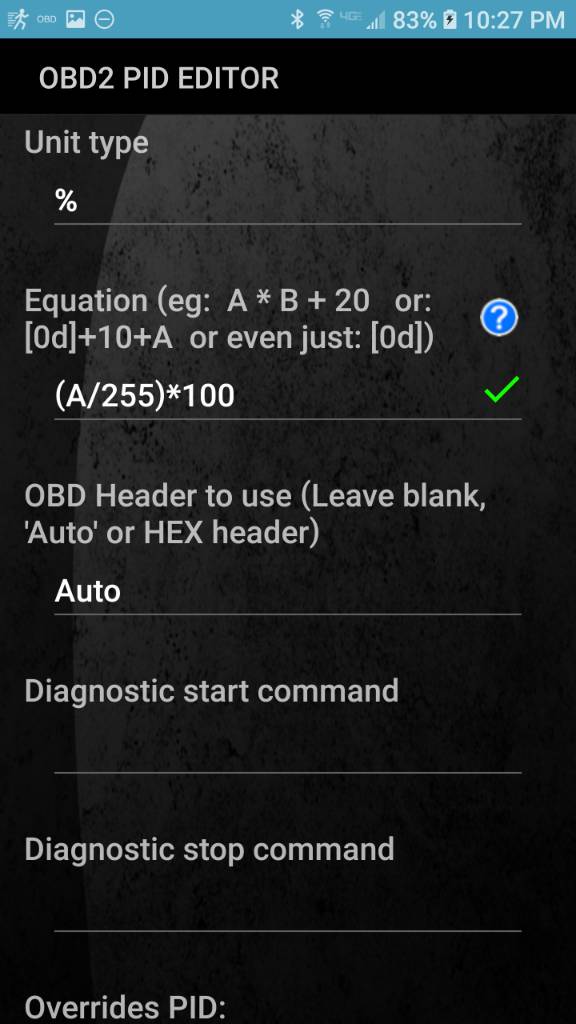

I have been trying to get the engine oil life monitor to read properly in the Torque Pro app but haven't had any success.
These are the parameters I have currently...
And it reads 39% constantly.
I have tried many other configurations and equations but almost all of them give me a negative reading.
I know I can just pull up the info on my dash but I would like to get this working just because it should be possible.
Does any one have this working correctly???
Any help is appreciated.

Here's what's in the PID info on my Torque Pro app

Got my adapter back. Oil life monitor doesn't give a reading in Torque app.
My adapter is the OBDLink MX and I even tried it in their app and I can't even find an Oil Life PID in the app, unless I create a custom one.

Yeah mine doesn't work either. I can change some of the parameters to get a reading but it's not accurate.
Mine comes back with a reading of A = -1

="Yeah mine doesn't work either. I can change some of the parameters to get a reading but it's not accurate.
This has me curious. What year etc. Do you have?
I think I previously posted mine is a 2005 Yukon 5.3 .

I think GM changed to a different system (CAN bus) around '05, so PIDs that work on earlier vehicles are a bit different on newer vehicles.
