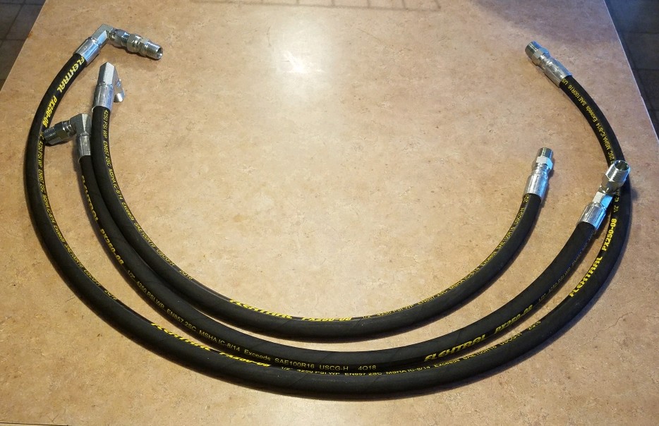

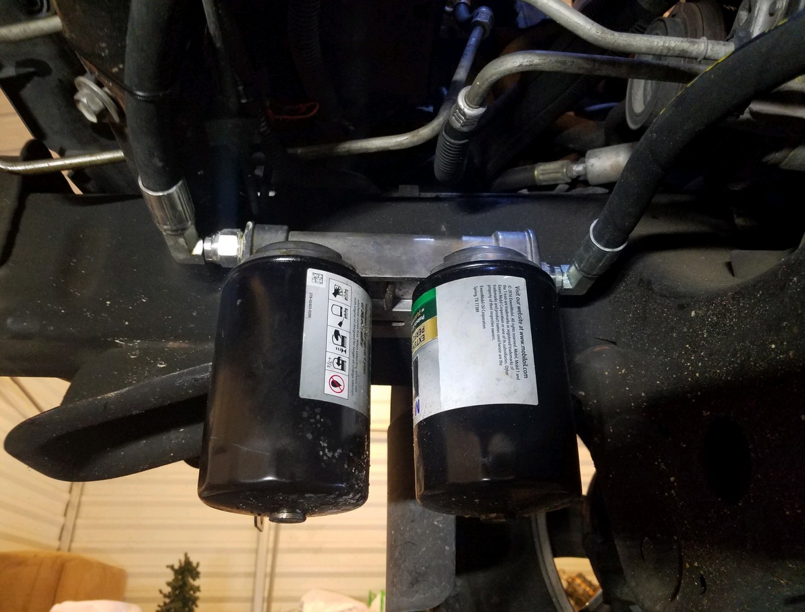

My truck didn't come with the EOC from the factory either.
I ended up adding an aftermarket stacked plate style cooler and a dual remote mount oil filter housing with oversized filters. I had custom hydraulic lines made to plumb everything together.
Filters are mounted to the inside of the passenger frame rail behind the front bumper and infront of the crossmember.

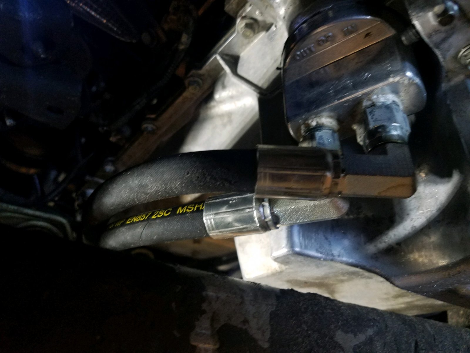

I have changed it since then and added the factory oil cooler, that is mounted in the radiator, into the system along with everything else.
I also ended up redoing the lines as the hydraulic lines started leaking after several years.
