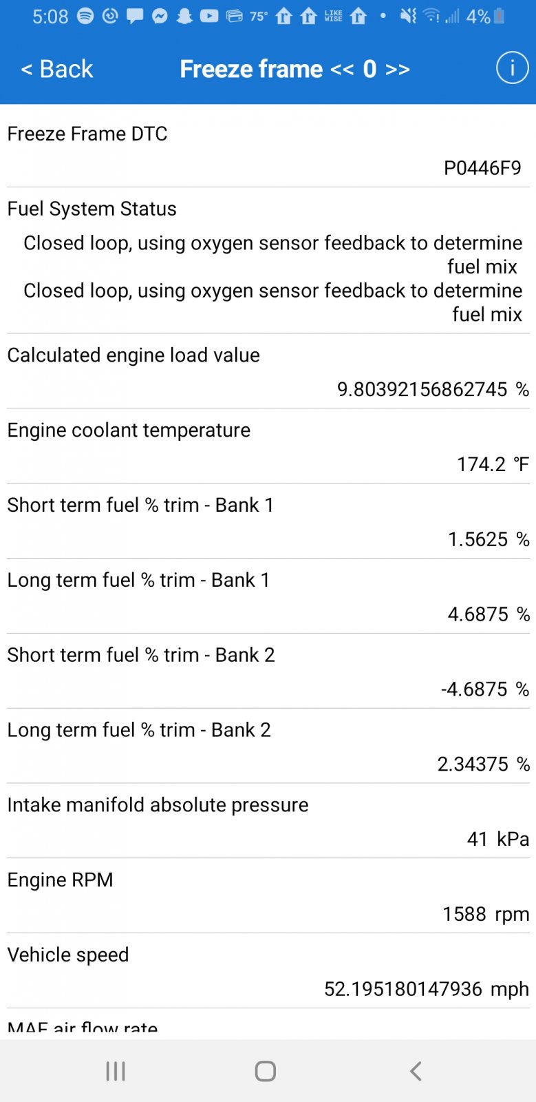

Not data recording like live data ("real-time monitoring"). A freeze frame. It's a snapshot of what all the sensors were reporting at the time the DTC was set. It's a really handy diagnostic feature that is usually standard with any half-decent scanner. I mean the data is already there, in the PCM. It's just a matter of accessing it along with the DTC you're viewing.
For example, say I had high idle, persistent stalling, rich exhaust codes, maybe even lean exhaust codes, sooty O2 sensors, etc. I could check the freeze frame for the rich exhaust code and, as expected, I'd see the O2 sensor reporting low or high (whichever indicates "rich"). But, I continue scrolling through the freeze frame data and I see the coolant temp sensor is reading some obscenely low temperature. There's my smoking gun. The PCM is thinking it's super cold and dumping fuel trying to warm up the engine. The excess fuel soots up the sensors and, eventually, they're clogged and can't accurately sample the exhaust so they report it as lean, which makes the PCM dump even more unneeded fuel.

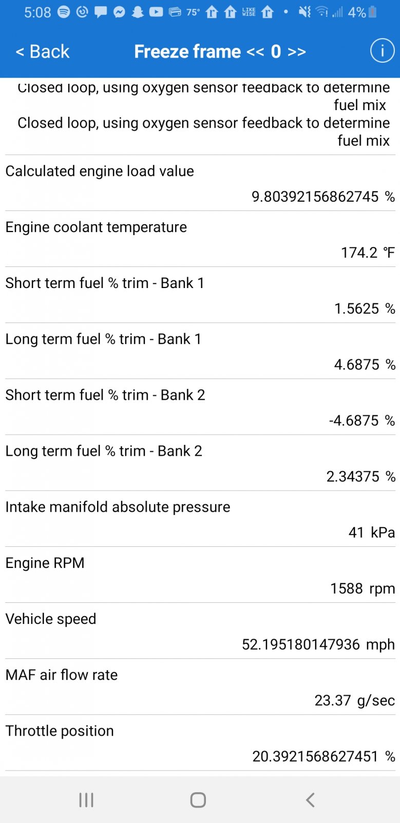

Last night I decided to take on cleaning up the grounds. I got the one on the engine block done and today it seemed that may have taken care of the crank but no start condition. The engine will still intermittently die but seemed to start right away just fine. Today now I cleaned up the frame grounds but now I seem to have other electrical issues worse than I already had. I made a post in the electrical forum for it.
@iamdub gotcha regarding the freeze frame capability. Yes the phone app does do it. Parameters it looks at are pretty limited though. This is for an EVAP code that's currently active.
