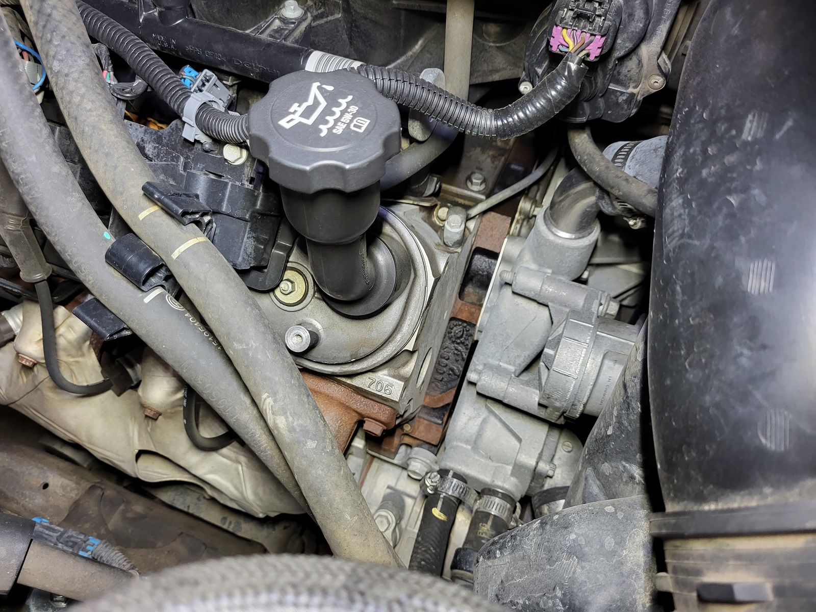

Well, damn. This is one of the first steps! Check that main ground on the other end where it bolts to the engine block, a few inches behind the power steering pump.

Well, damn. This is one of the first steps! Check that ground on the front of the passenger side cylinder head. It's the easiest to get to.
It took way too long to find this pic off the 'net. Ignore the blue aftermarket wire. The factory ground is the black 4 gauge with the exposed copper. It's just inches away from the oil fill neck:
Interesting. I was curious enough about this to go look at mine, and it's not there on my L59. And the oil dipstick on mine is closer to the firewall.
Check the other head.ain’t the battery on ds in NBS? I forgot how mine was setup but I’m pretty sure about battery placement…. Little red junction block for the positive too?
Yes, red junction box for the positive, and battery on DS. I think the main (fat) ground goes down to near the starter.
