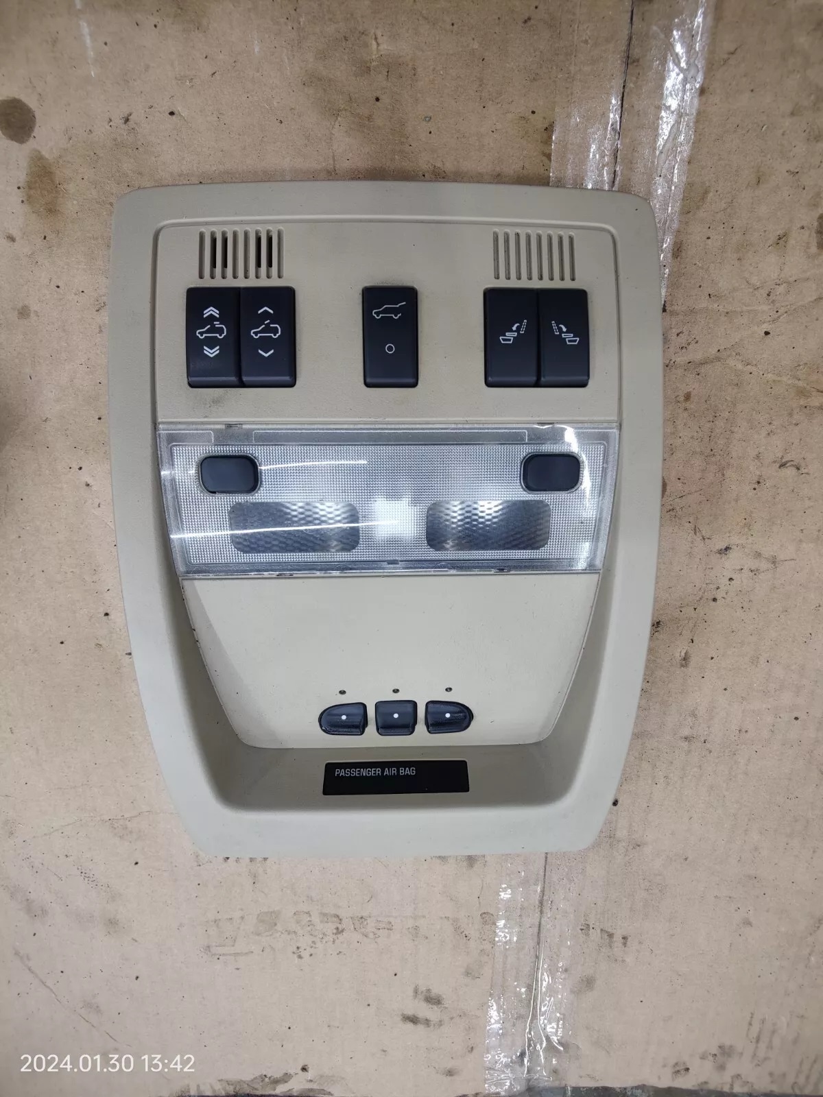

Ah, looks as if the switches for the power-fold 2nd-row captain's chairs were in this location for years other than my '13, which has them on the C-pillars. From an eBay auction:

ya they deleted those because they thought some one might fold there kid up in the seat, which basically has no force to it at all.
and if you are tall at all like me and have the front seat back they won't fold anyway they just hit the seat back.

It was an 07-09/10 thing. In 09 & 10 they also included two more additional 2nd row collapse & fold buttons on the C pillars behind the seat backs.
After ‘10 to 14 they only put the buttons in the C pillars. Yea, there’s also a hydraulic strut in those 2nd row seats with that feature. If they don’t fold completely flat, just replace the strut.

The c pillar buttons have always been there they didn't get moved, they just deleted the overhead ones
