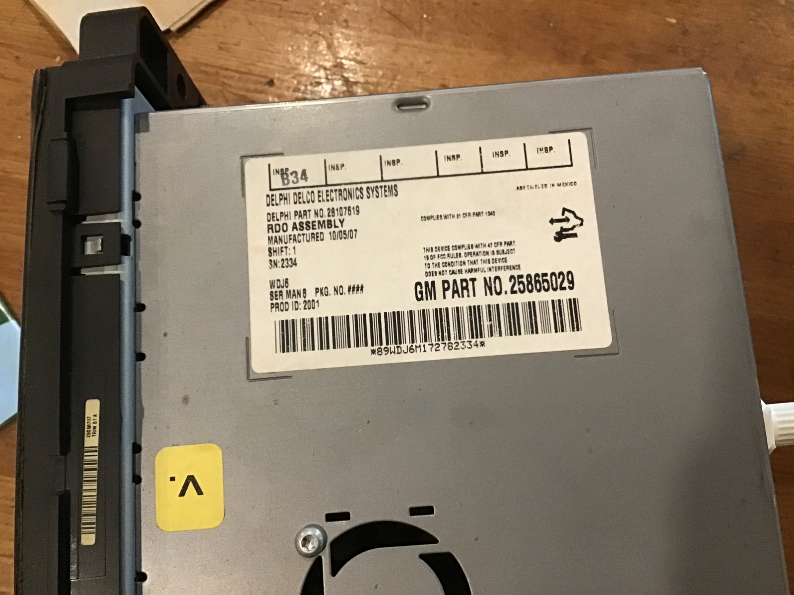

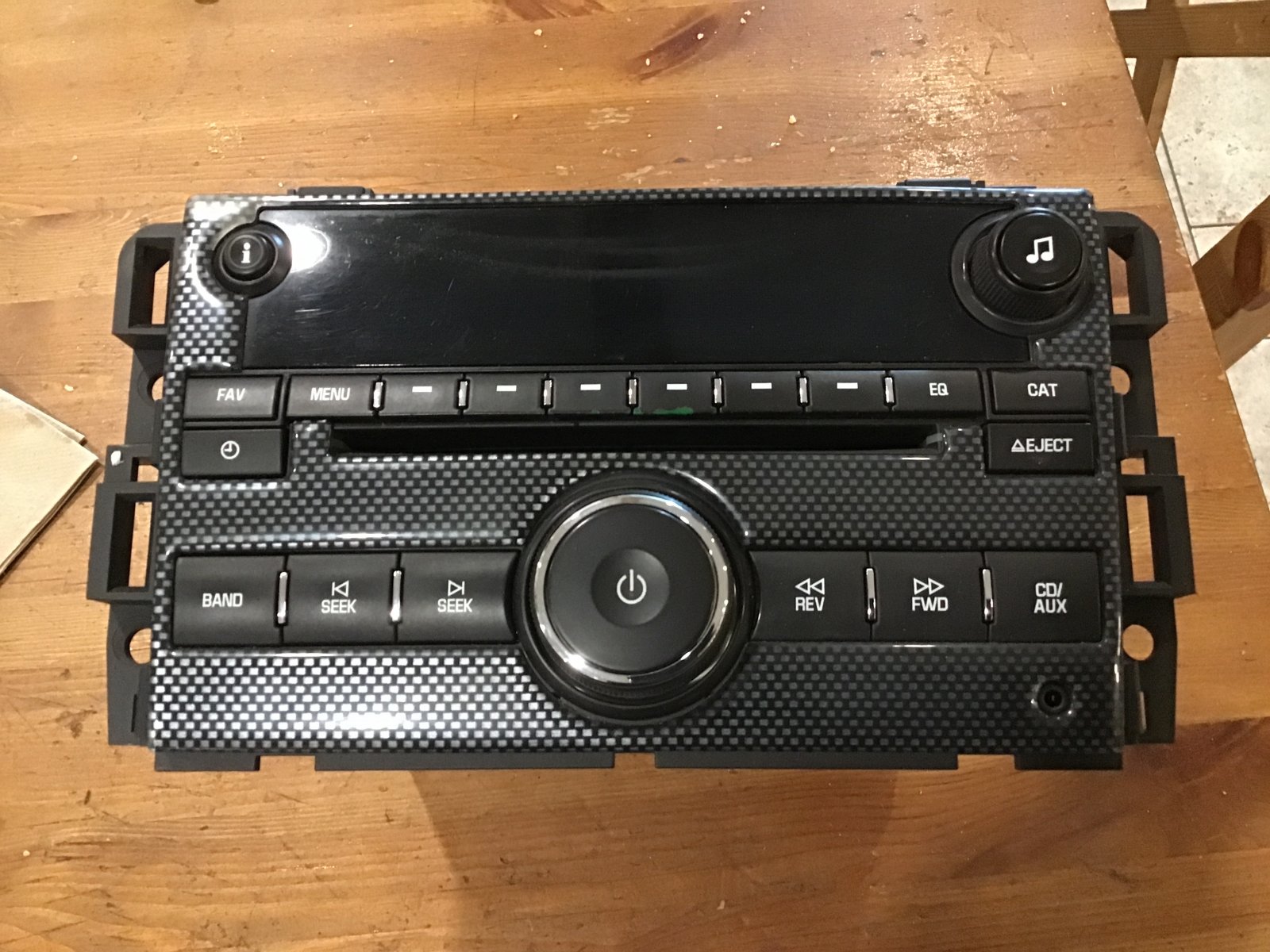

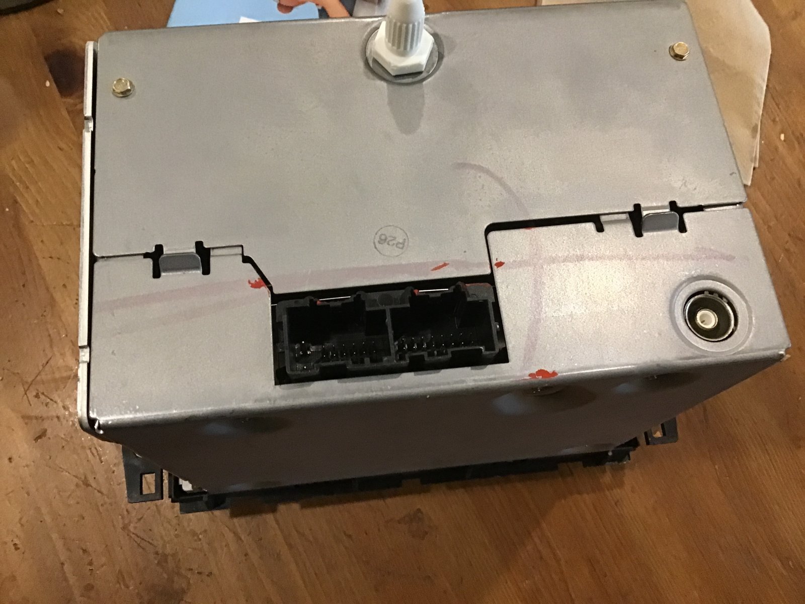

If it’s not the grounds it might be the head unit itself. They do go bad sometimes. You can usually find the factory ones on EBay for pretty cheap since a lot of people swap them out for aftermarket. If you decide to go that route, pull the old unit and get the p/n and match it up. I have the factory unit from my 08 Silverado you can have if you pay shipping. It’s listed as 07-13 Silverado Tahoe Yukon in compatibility charts. It’s got some face carbon fiber overlay but you can remove it with a bit of work. It might not be the same p/n as yours but I’m sure it will work.
