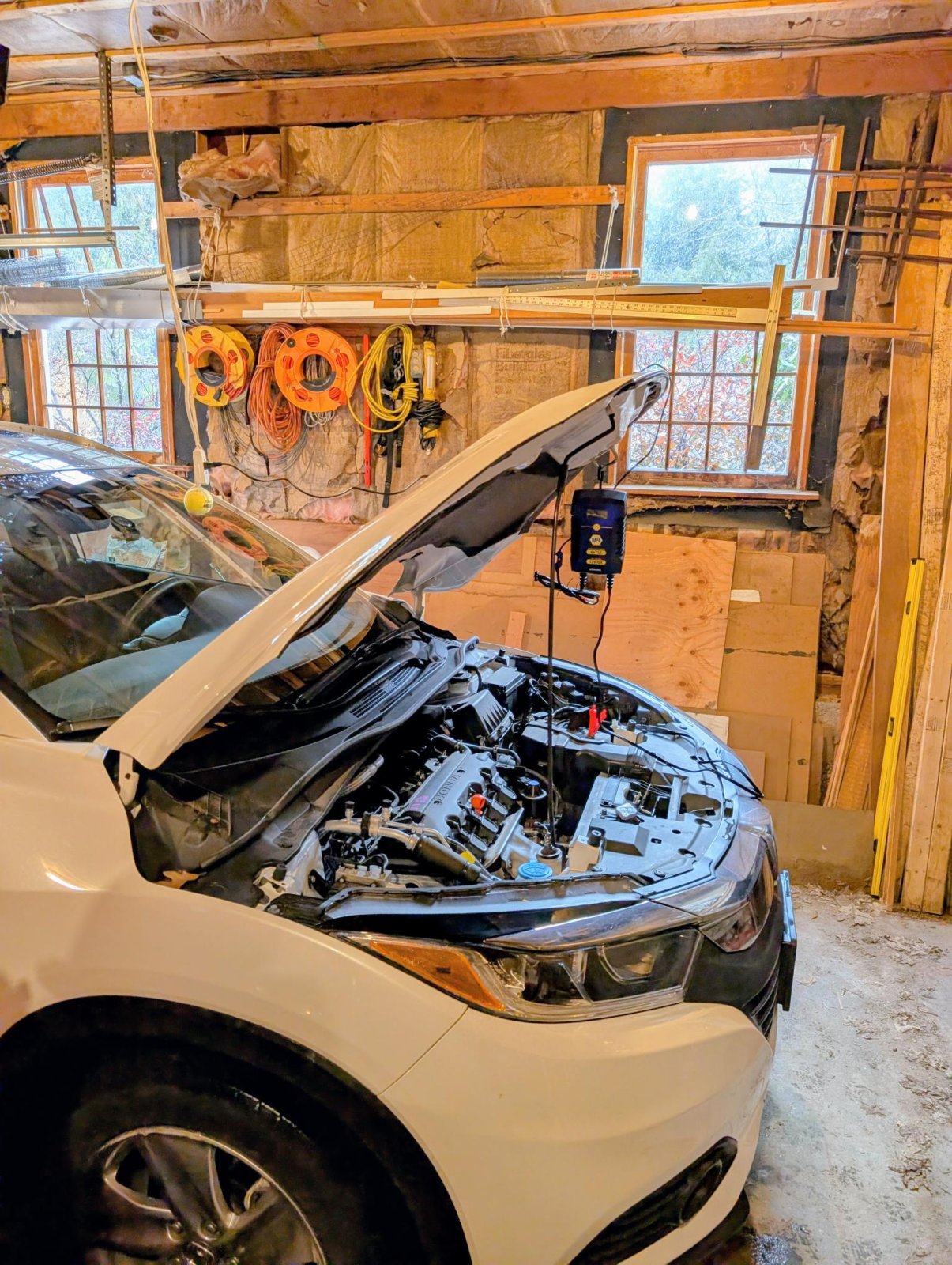

Since I mostly use my truck, because my dogs demand to go everywhere with me, my 2 cars don't get used very often. Fortunately, they are both garaged, so I have AC power and battery tender chargers on both of them.
