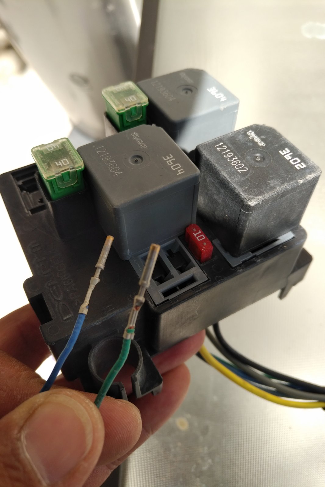

Those are the part numbers for the std 34 inch(?) radiator found with the 5.3/6.0. You should get the factory harness that @ScottyBoy sells if he has any available. There are two wires, a blue one and a green one, that plug into the ECM. I don't remember which wire goes to #42 and which one goes to #33.

Green trigger wire goes to pin 42 in the blue plug, and the blue wire goes to pin 33 on the green plug. And yes, I have an OEM harness in stock right now. It's $125 shipped.

Thanks for clarifying which trigger wire goes where.
