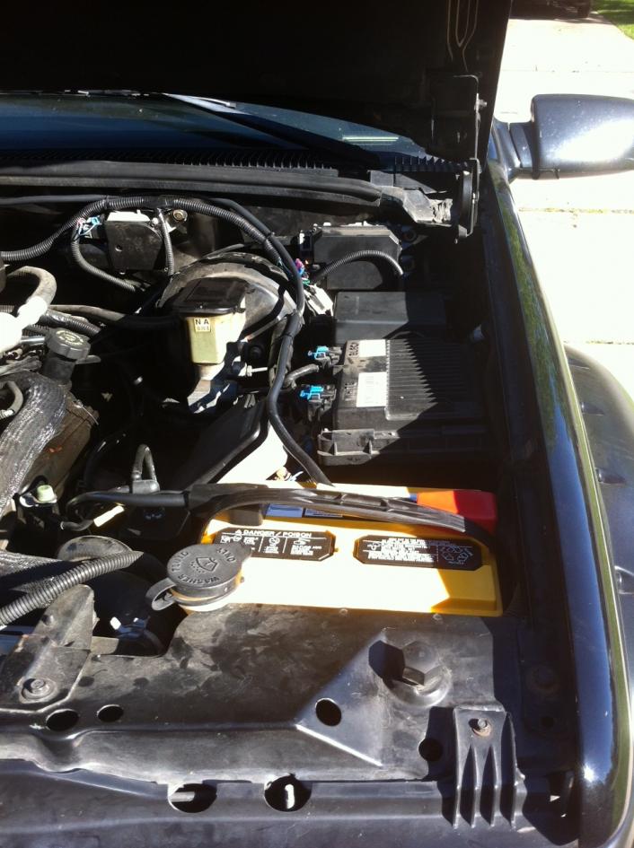

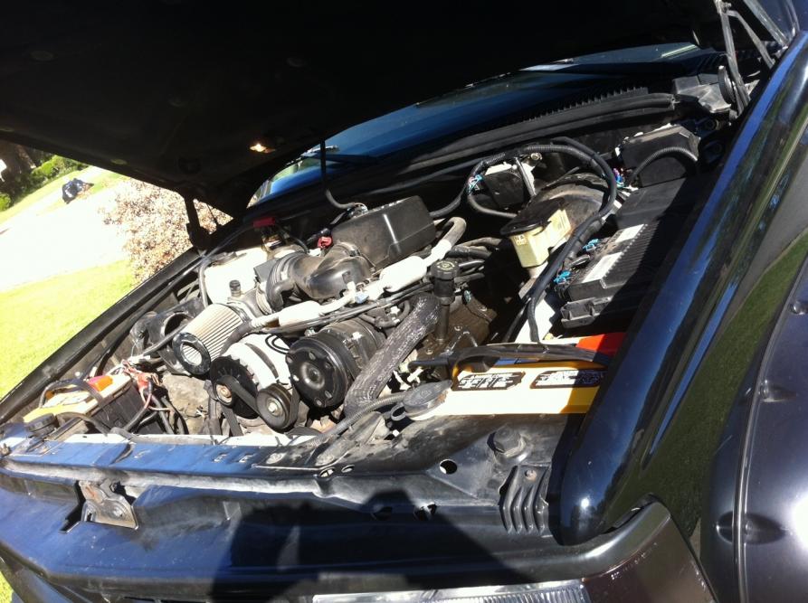

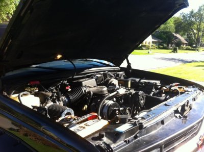

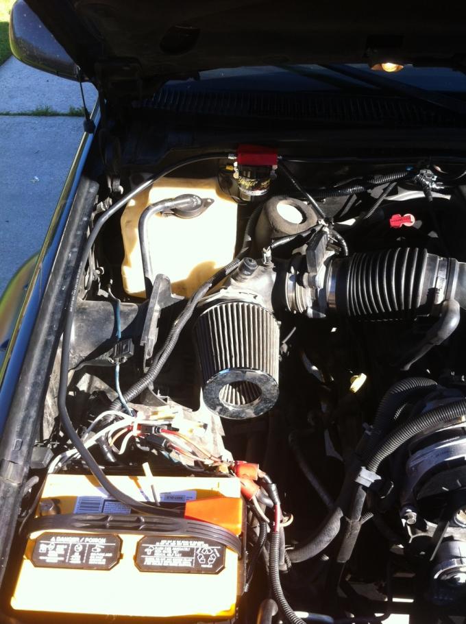

Did a dual optima yellow top set up, direct connection with 0awg, have a 200 amp alternator, been in for a month now, no problems whatsoever. Took about an hour to set up, I have no reason to isolate.
Some pictures
Wow nice clean engine bay :thumbup:
