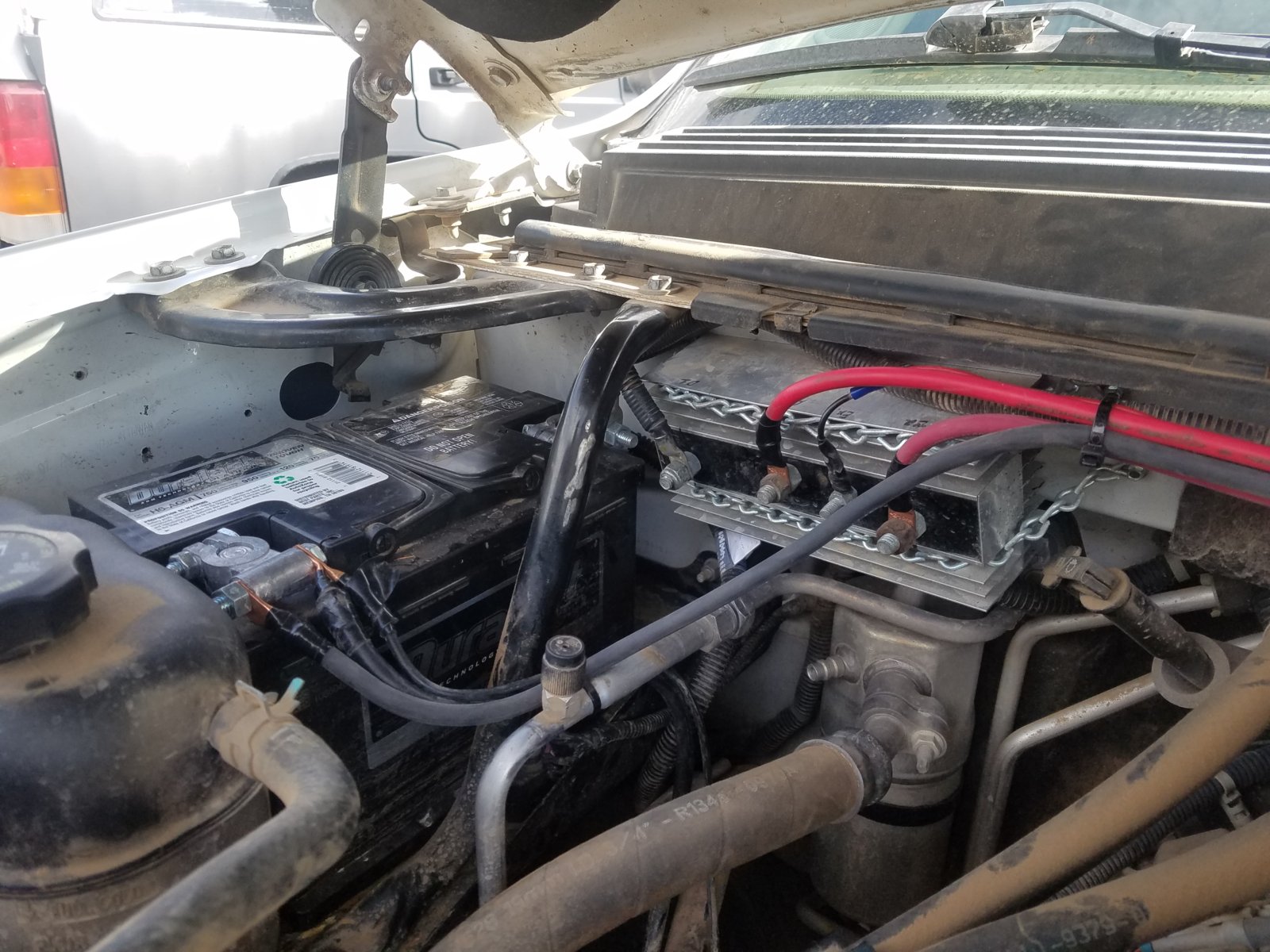

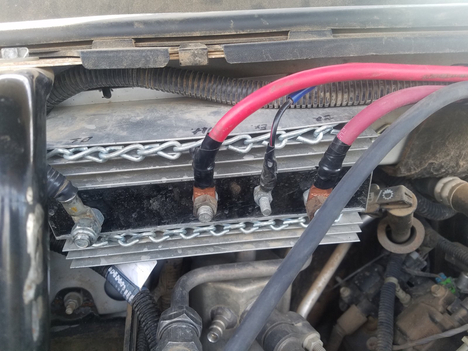

Staring battery and isolator
(Neg from other battery was a little short and this also keeps it away from the Pos terminals)

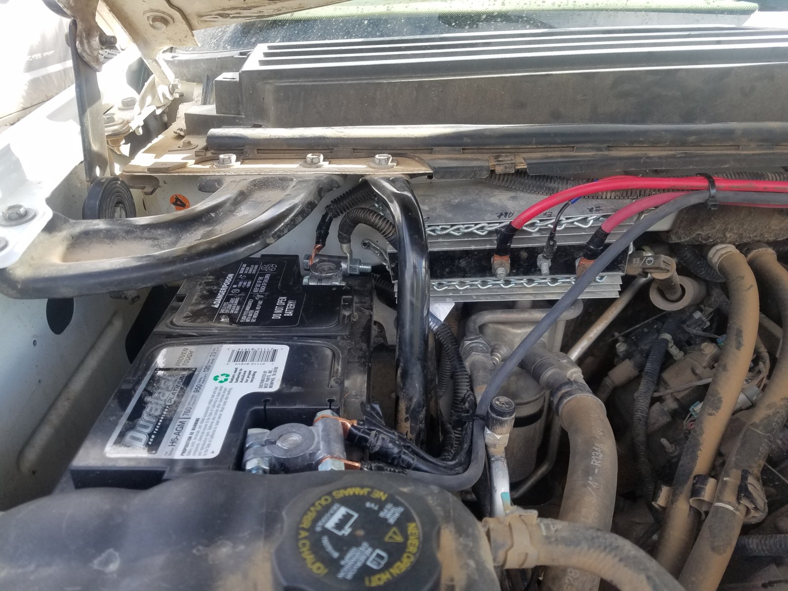

Another angle of the starting battery and isolator
(note I removed the "amp clamp" for constant charging current, probably necessary for dual battery anyway but I mostly just didn't want to deal with it to begin with)

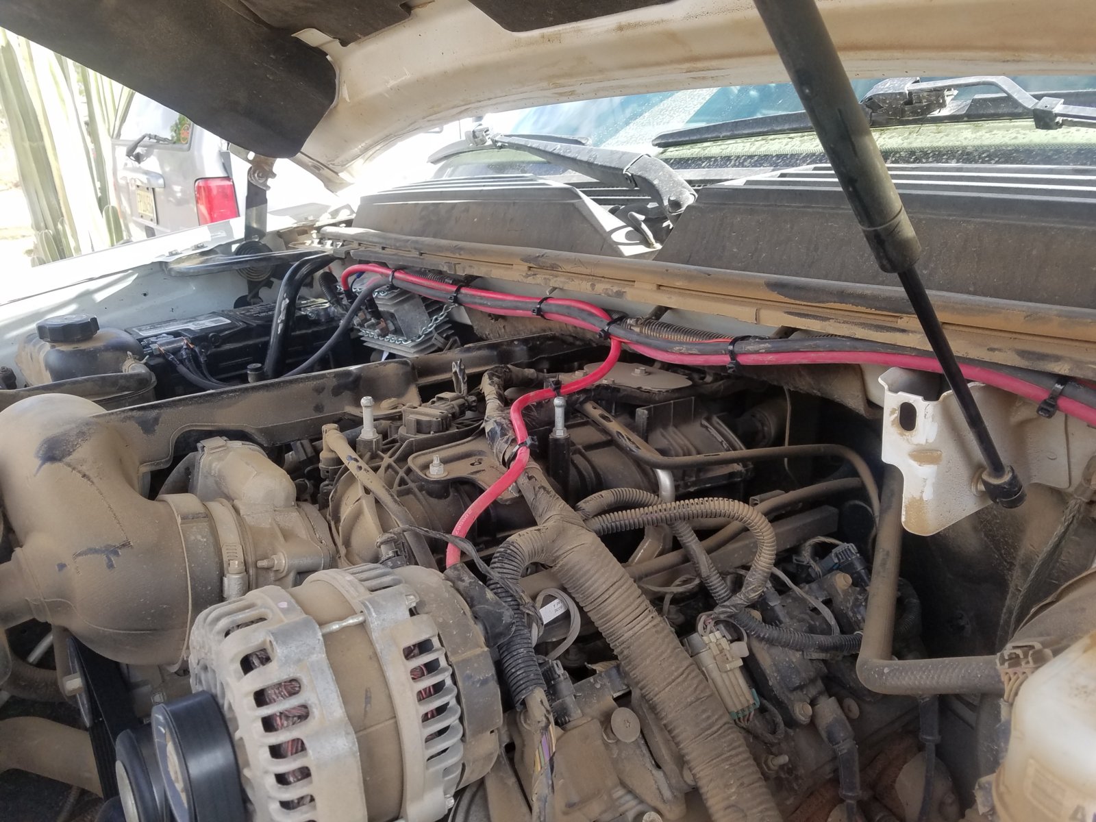

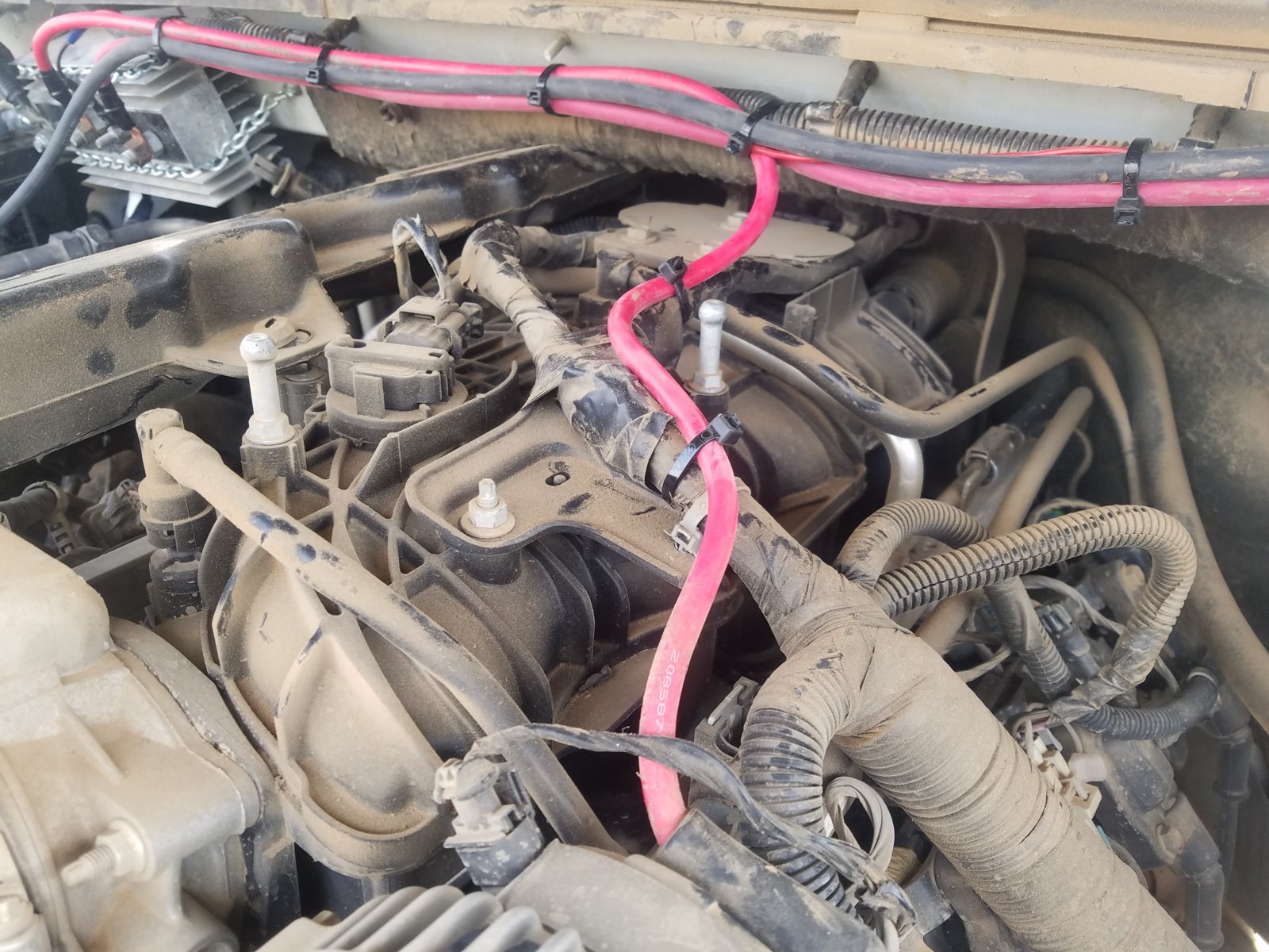

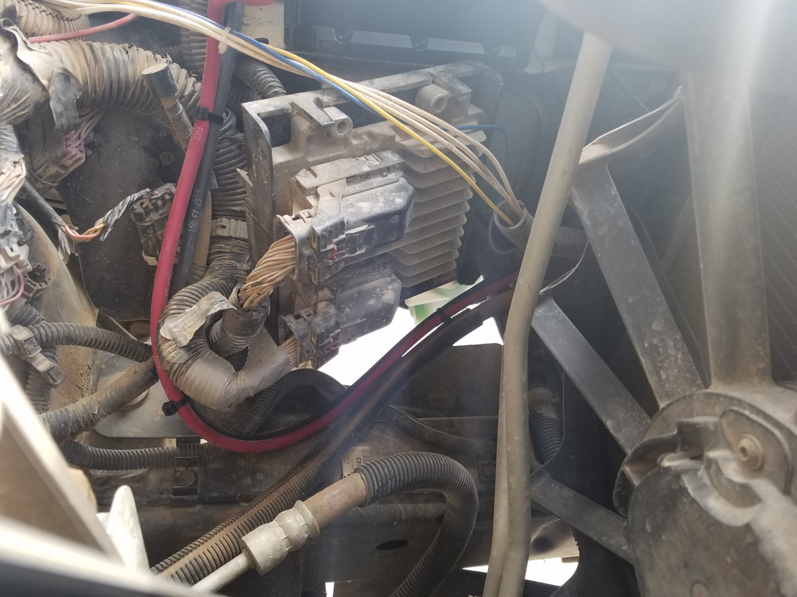

Picture of the rerouted alternator wire as well as the wiring going to the fuse box and secondary battery, following the stock wiring
Close up of the rerouted alternator wire

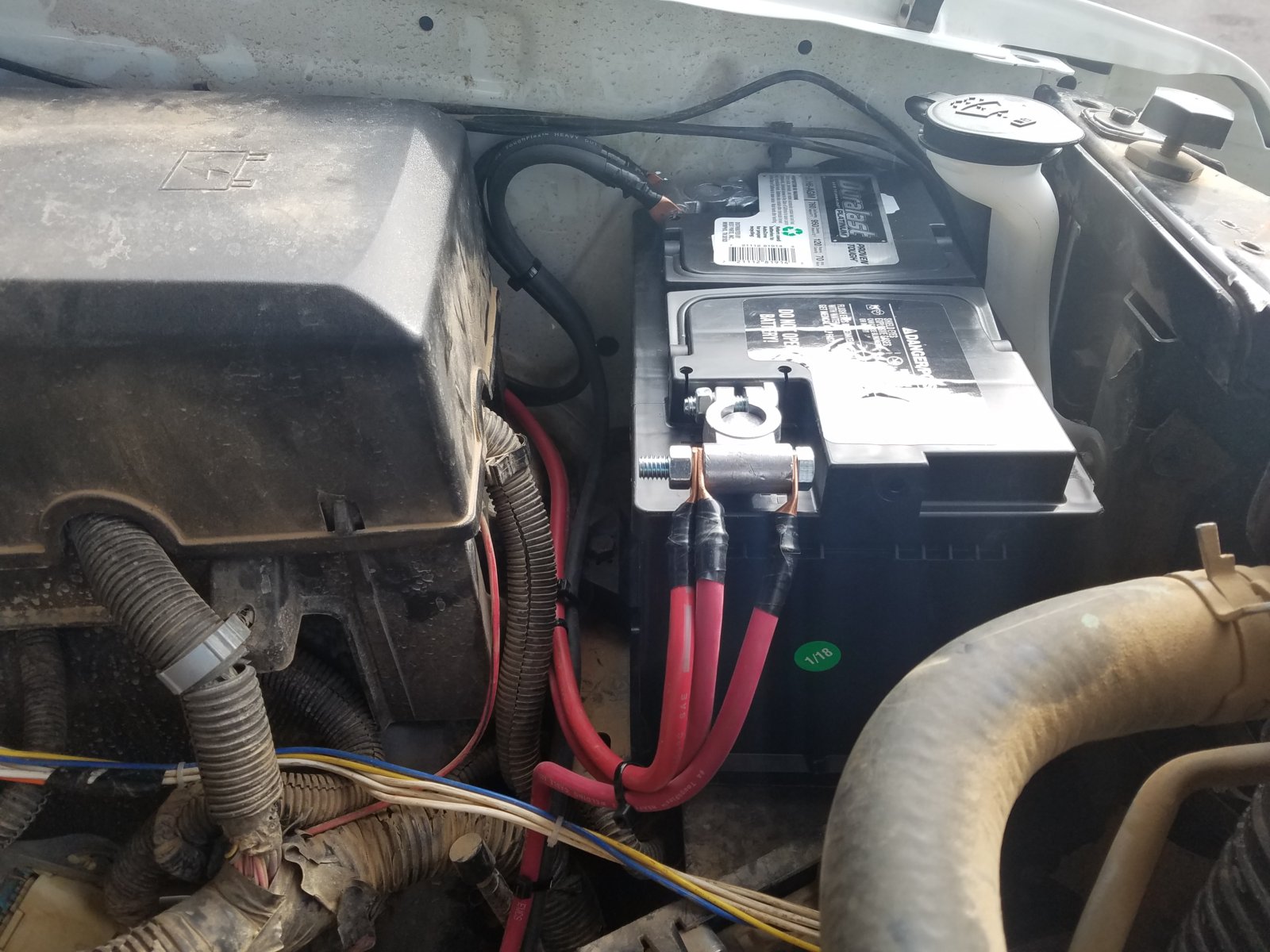

Picture of the second battery with Pos and Neg going to the accessories around the truck as well as a quick disconnect mounted on the front bumper

Neg terminal just barely clearing the side of the truck... glad its the Neg

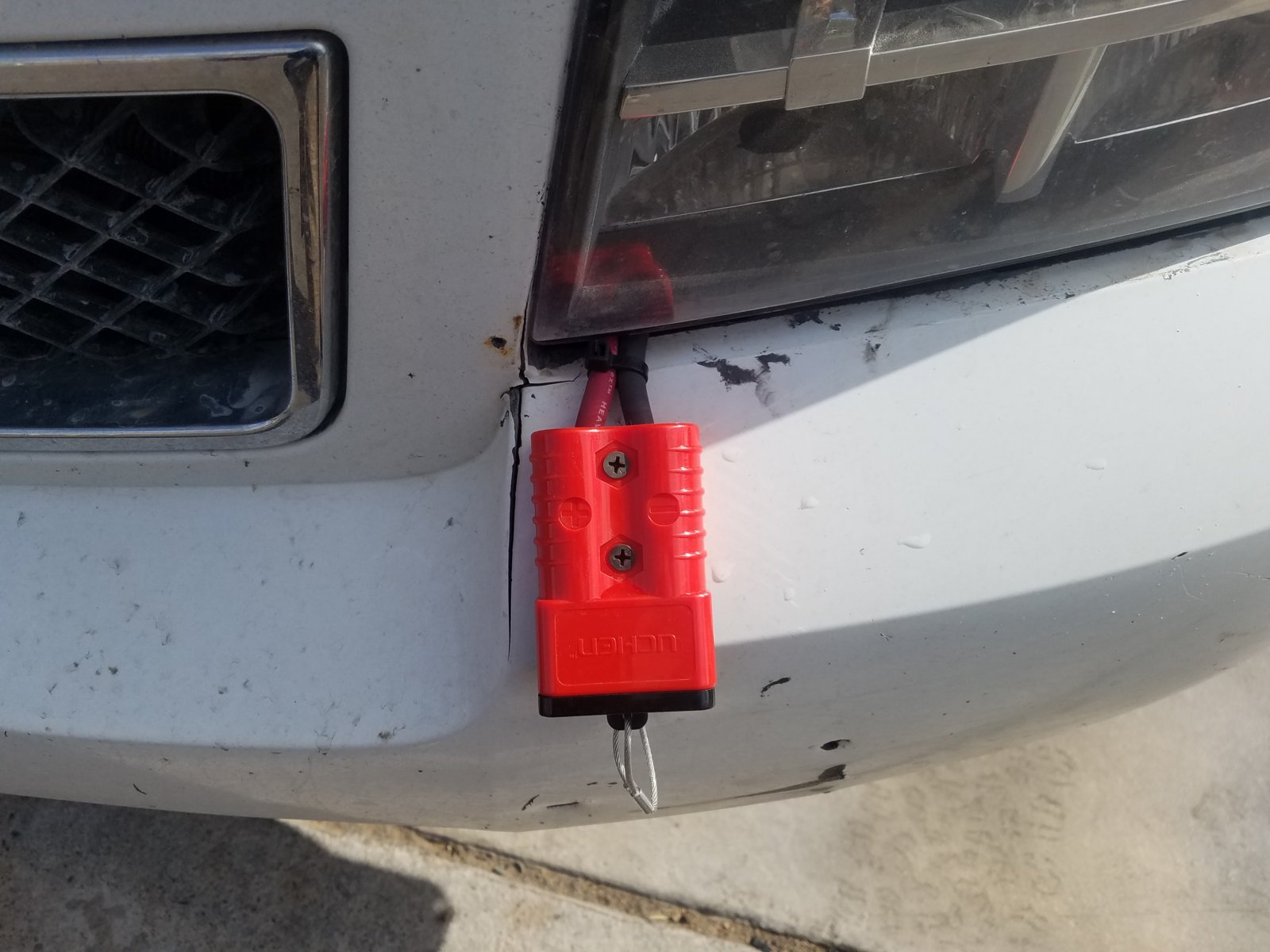

Quick disconnect mounted on the front of the truck for jumping people or whatever you could think of
View of the wire running to the disconnect

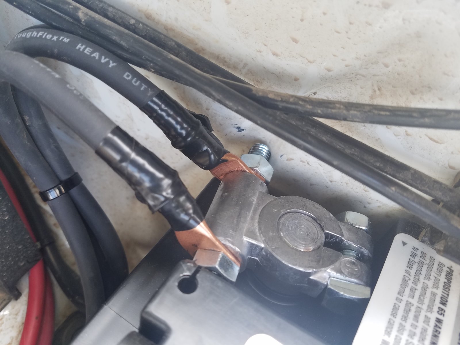

Close up of the starting battery Pos terminal (note the wire in the backgound twards the bottom goes to the starter)

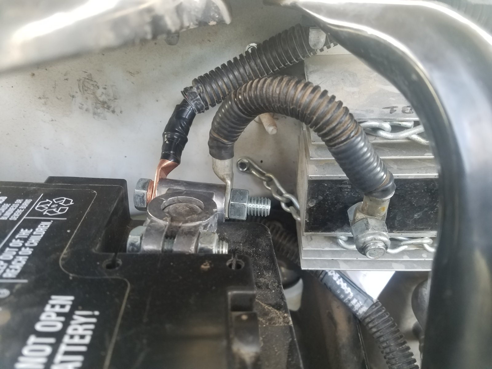

Close up of the isolator

Looking good.... out of curiosity... why so many cables on each battery?
Most of the connections are stock (main battery has 3 on the Pos; alternator, starter, main fuse box. Neg has the two stock connections plus one from the second battery).
On the second battery the connections are Pos and Neg to the accessories, another to the disconnect in the front and the last two are one Pos from the alternator and one Neg to the other battery.
