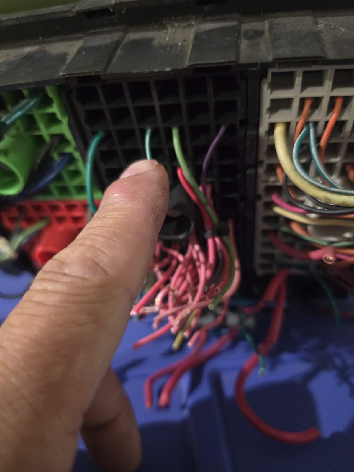

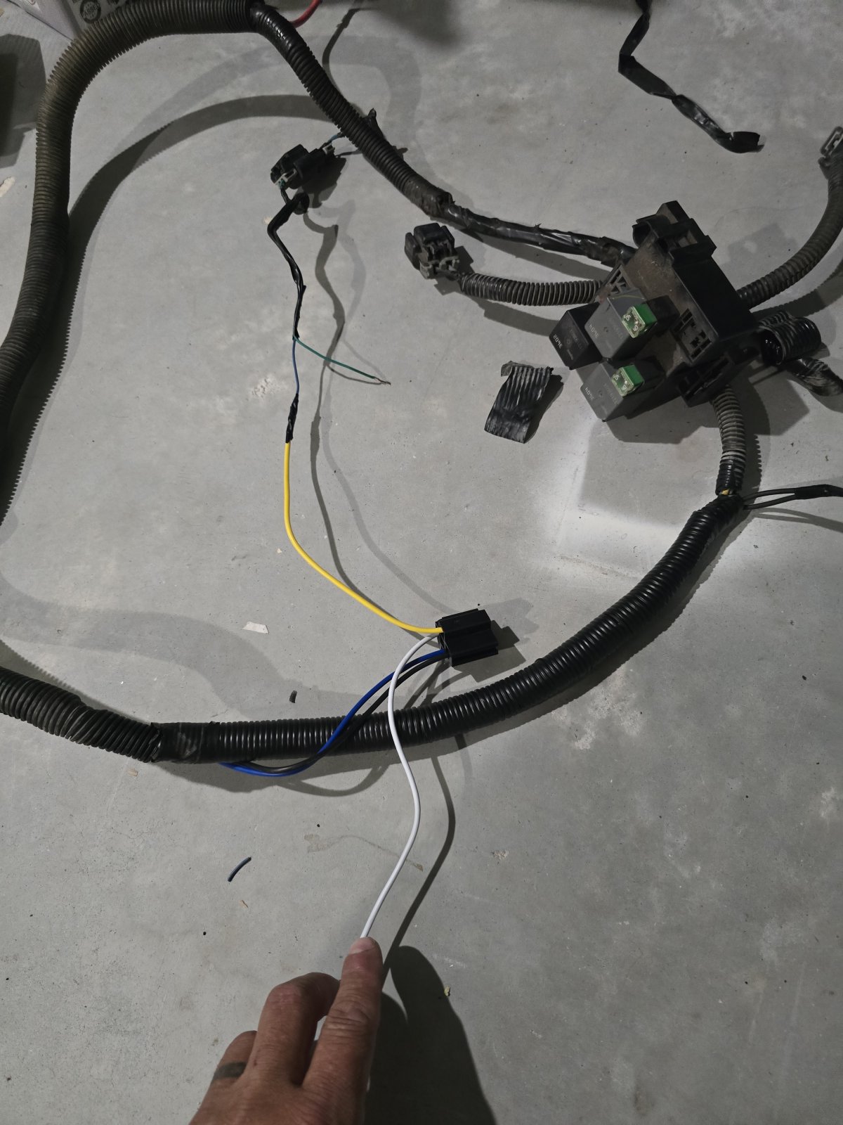

New to the forum so.please forgive that I couldn't find a way to ask this in the thread I found on this topic. I have an 04 Yukon and dual efans from 05 Silverado with stock wiring harness and got the relay for the temp probe. Pin 86 white wire on the relay goes to the a/c comp relay but I am unsure as to which color wire/pin ....all videos say dark green wire but I have two same color green on the underside of the fuse box one for pin 85 in green/white stripe and I think that's the one but not sure. Any help is appreciated

I apologize, I am not tuning the PCM I'm using a temp.probe into the radiator and I am trying to confirm if I tie the white wire from this relay here to the green/white wire from under the fuse box as shown in pics or the dark green one to.the left of my finger

I added pics to my reply

I wired up the factory wire harness from a 05 Silverado and used the probe into the radiator so when the truck hits op temp the fans kick on low , used another relay and tied into the ac comp.relay pin 87 so when I turn on AC both fans run on high. All is working except after I turn off the truck the fans come on a few times for a min or two due to wiring it to constant 12v I'll add another relay tomorrow and run it to ignition power and that should fix the fans to only come on when the trucks on. Thanks all
