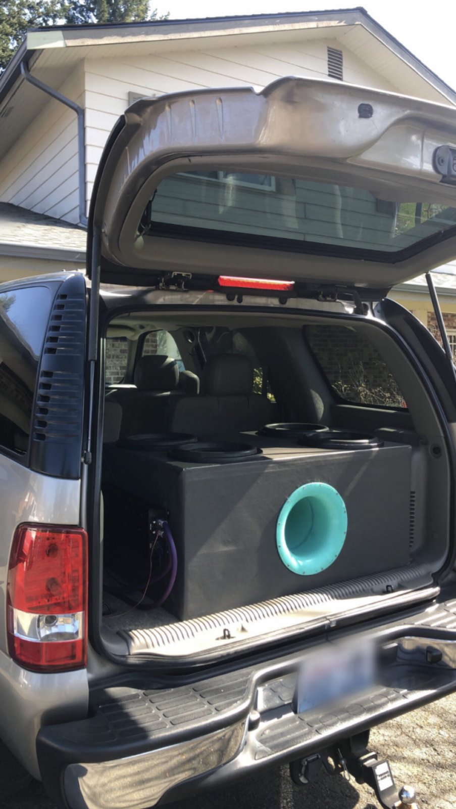

I'm looking at upgrading my mids setup, using the 4 channel amp I already have installed. The yukon currently has 4 worn out coaxials, and I am looking at adding 4 6.5s and tweeters. I have been thinking about running all 4 6.5s on ch 1/2, and running the tweets off of 3/4 in order to not have to add another amp or use crossovers. Does anyone have experience with running speakers only in the front door, or can I even run my speakers in parallel in all 4 with a lot of wire connecting them. Any input would be greatly appreciated.
