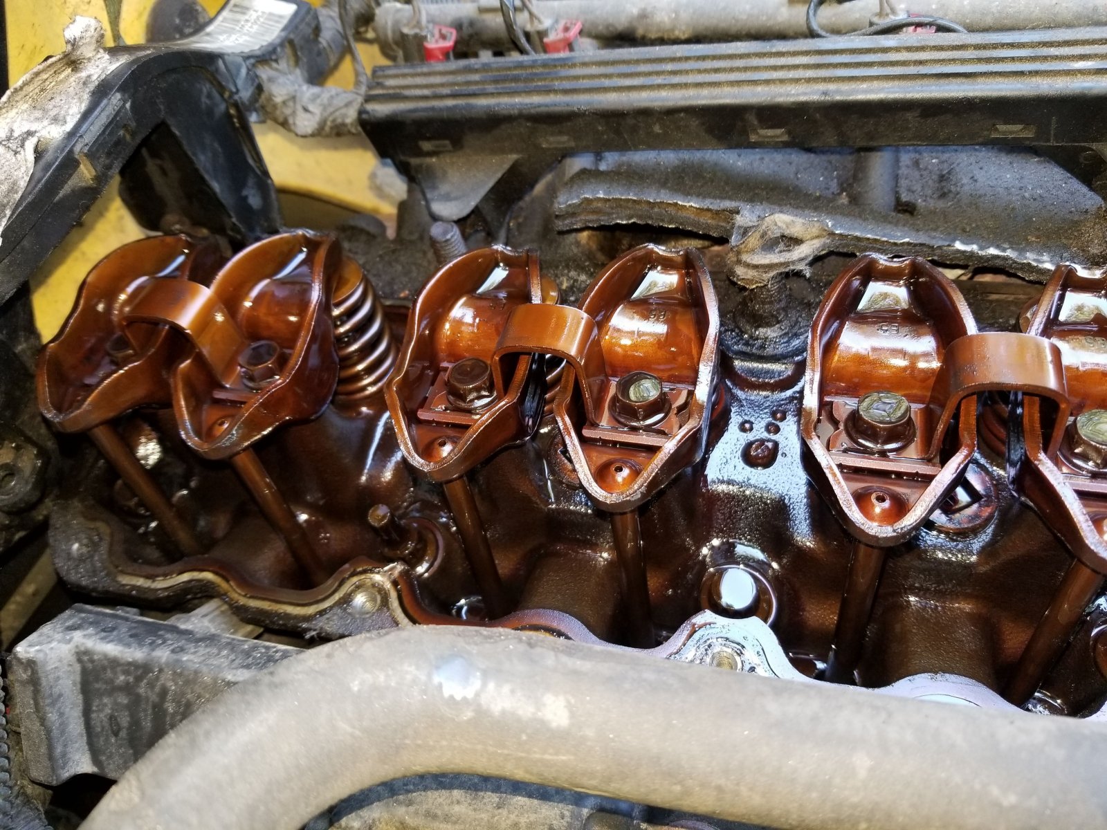

On my 4.0L 2005 Jeep Rubicon, I kept up with oil changes every 3k miles. It got cleaner with every oil change.
I was hesitant to do any kind of deep clean with solvents or things like Seafoam or the old ATF fluid in the oil trick.
My gut was telling me it might do more harm than good on an old high mileage engine.
I figured it took years for deposits to build up on seals and gaskets. It wasn't leaking a drop on the ground. If I did a hard cleanse, I was afraid the deposits that were helping keep the oil in would not be there anymore and the oil would start spewing out like a faucet. Oil pan gasket and RMS never spilled a drop! I left it that way and just did the frequent oil changes.
Here is what it looked like inside when I did the valve cover gasket replacement... It had 183k when I bought it and it was about 225k here after 3 years.
