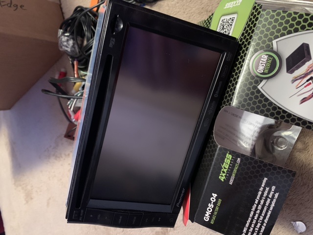

So picked this Pioneer AVIC-X920BT for 75 bucks with all connections and I couldn’t pass it up. Yes it is a bit dated but it will do it’s job fine along with navigation. As for the wiring interface module I went with the Metra GMOS-04 since it came to 75 with an employee discount. Tomorrow morning I’m going to throw all this together and see how it comes out. When the car audio store opens I’m going to grab a double din dash install kit. I have a Panasonic stand alone rear entertainment system in the rear already. What’s the best way that I can tie these together so what I watch on one is on the other and plays through the vehicle speakers. Also anyone have any tips or anything on the best place to hide wiring (ex. GPS Antenna and Microphone) or just install tips anything would be appreciated

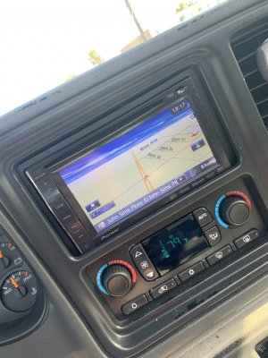

i did that exact same thing for my mic. I was worried from research that the headunit would be pretty much junk due to the age and updates. I went into a local car audio store and was told pretty much it was a fishing weight and to get a new one and that nothing would work at all. So come to find out everything on it works perfectly. As for the rear entertainment system being a stand alone unit all I’d have to do is tie into it and done. For being hell 8 years old or so it does all I want and need until I can really upgrade to iPad install

i was referring to GPS reception signal, as of now i have it mounted right next to the factory fin. I was wondering if there’s a better area for it. Sometimes it picks up good and others it’s so-so. Like I said it does all I need it to do for now until I get everything for my iPad install. Also got some new stuff coming this week
