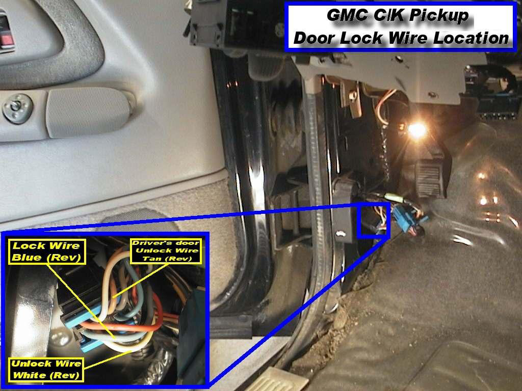

Ponchonutty
Sep 1, 2013
560
69
New Washington, Ohio
You can set up the locks to unlock only the drivers door then if you quickly press unlock again does the rest. If that lock isn't doing anything, it more than likely is a bad wire

hmm, no such thing on the gmt400 platform with a possible exception of it being a luxury model. otherwise the only thing that would unlock and only unlock the drivers door is the keyless entry system.

Correct. It would be along with the factory keyless system. Sorry but it's been a while since I've worked on an older Tahoe. Do what I said on unhooking the motor harness then test each wire to see which wire doesn't change state when pressing the lock/unlock buttons
