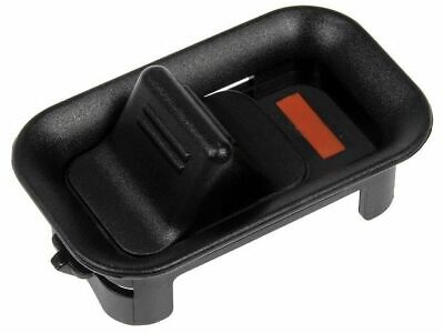

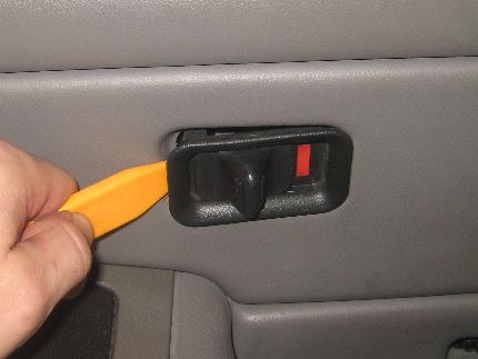

This lock knob?

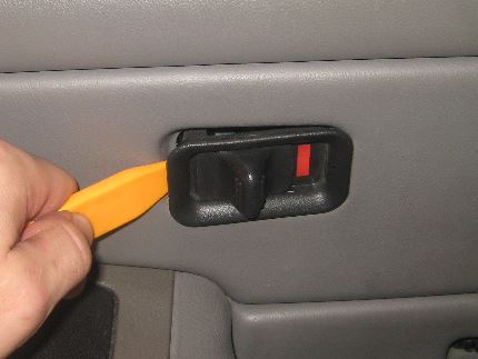

They just pry off, either from the front or the rear end. Behind the flange one end will have a somewhat flexible piece of plastic that is held under tension, and the other end will have one or more hooks:

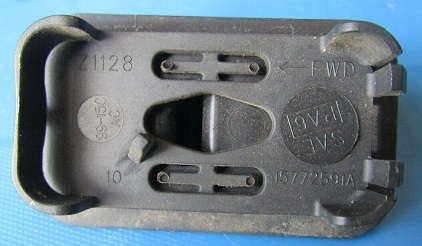

I don't recall which is the correct end to pry on but I would recommend using a plastic trim tool. Try from one end to pop it out and, if that's very difficult switch to the other end.

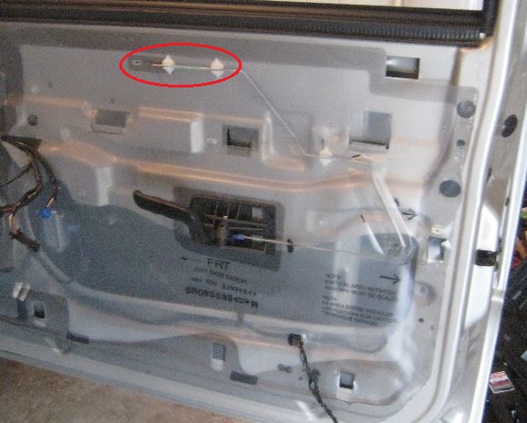

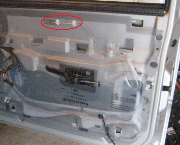

The hole in the back side of the knob is supposed to go around (capture) a heavy wire rod that connects to the door latch, horizontally. There are at least two clips on the inner door that the rod is captured by and slides front to back to guide the rod as it runs along the door.

This lock knob?

Yes that is the lock knob I got here to replace the oem one.
I am kind of scared of damaging the door panel but I will try to pry it off later on when it stops snowing.
Thanks for the write up! I appreciate it!

Can the lock be worked without jamming with the button removed (moving inside lever by hand)?
Does it operate OK using the fob to lock/unlock?
If it jams in either of those two ways, maybe you do have an issue with the connector or door latch.
Spray the moving parts and door latch with some brake/parts cleaner. Get the inside of the door latch good and clean.
Maybe there is dirt and junk inside the latch, causing it to bind up on you.
Some white lithium grease on the moving parts (including where the connector rod slides and the ends of the rod where the button attaches and the end that pivots).
Wouldn't hurt to make sure things are clean and well lubed.
30,548
47,998
this ^^^ that little plastic thing is not jamming up your door lock, the door panel needs to be removed and lube all the moving parts where they slide in the plastic holders.
it could also be the lock is getting tired or has a poor electrical connection it is 20 years old after all.
plenty of youtube videos on how to remove the door panel only takes a couple minutes.
