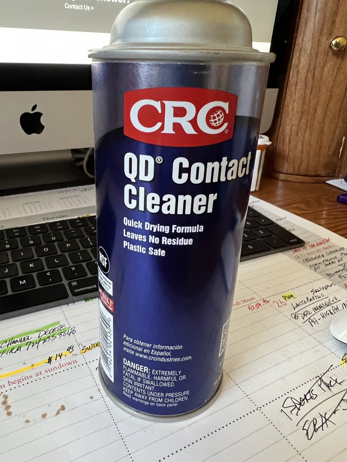

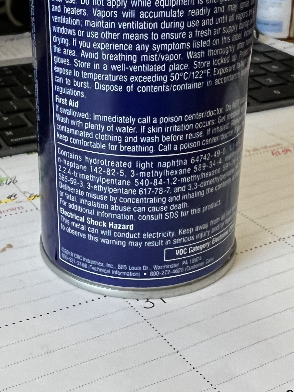

Will this contact cleaner damage my paint/clear coat?View attachment 366497View attachment 366498
hard to say, maybe take it by the dealer instead, there are relay's that operate the locks they used to have 1 for each door then they switched it to 1 for the front doors and 1 for the rear, not sure what they do now, it's possible it could be a weak relay IF they changed it to 1 for each side.
