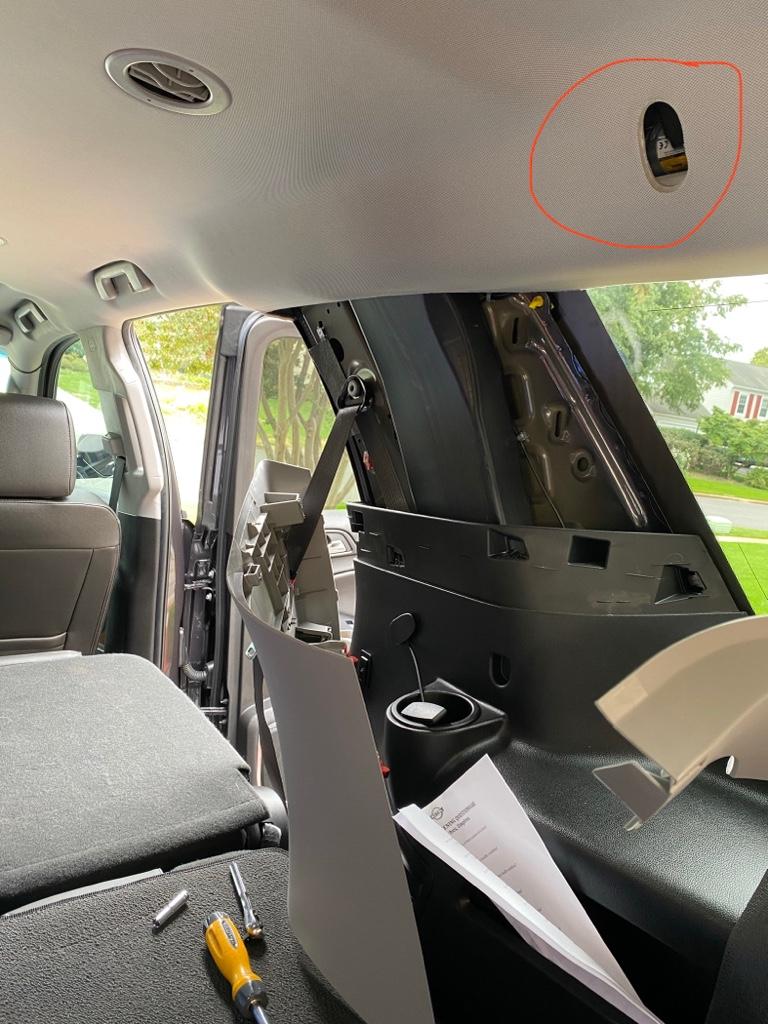

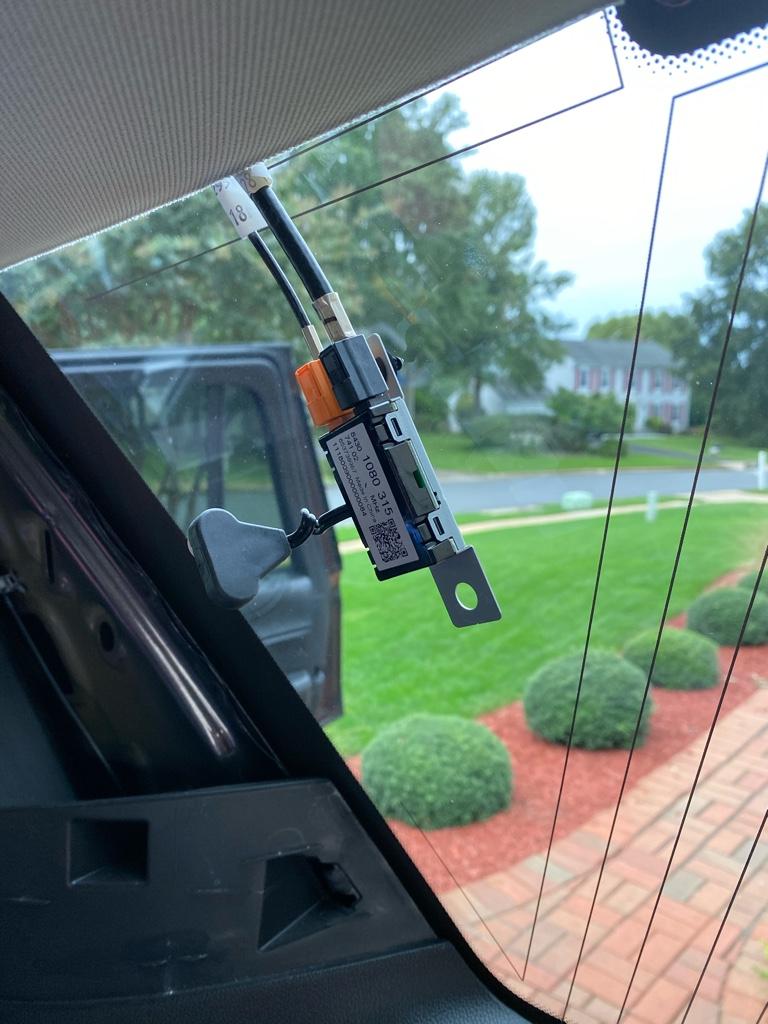

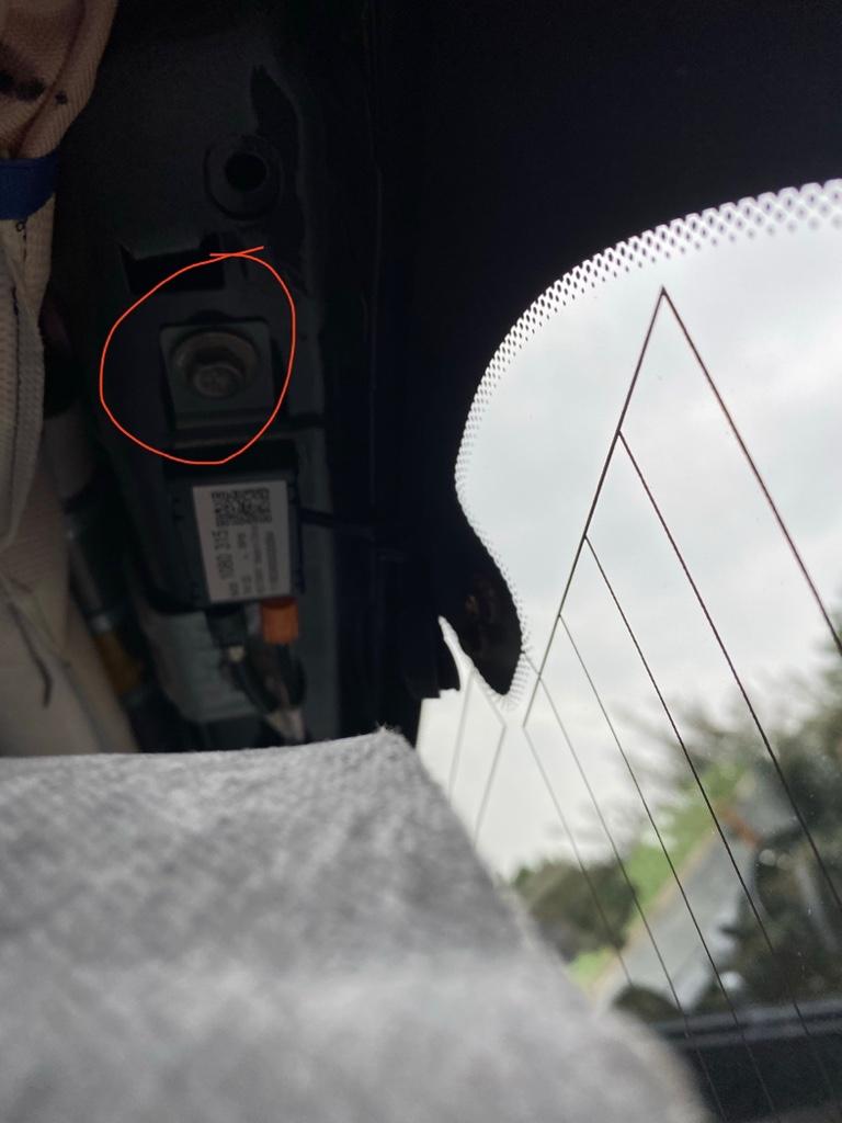

No need to take entire headliner down. I changed mine myself in 20 min. It’s 20 dollar part. Just need to take some side panels off to lower the back corner of headliner. If you have a burn or xl I think just the back pillar panel needs to come off given there is more play in the headliner.

Perfect. There was another member as well who changed his himself and his works fine. Now let’s see how long it lasts. Mine is still under warranty but the hassle of going to the dealer and them screwing up something is not worth the headache IMO. Tell them the entire liner doesn’t need to come down. They will get it filthy and it will never go back the same. That’s why I wanted to do my own. Rockauto stocks the part for future reference.

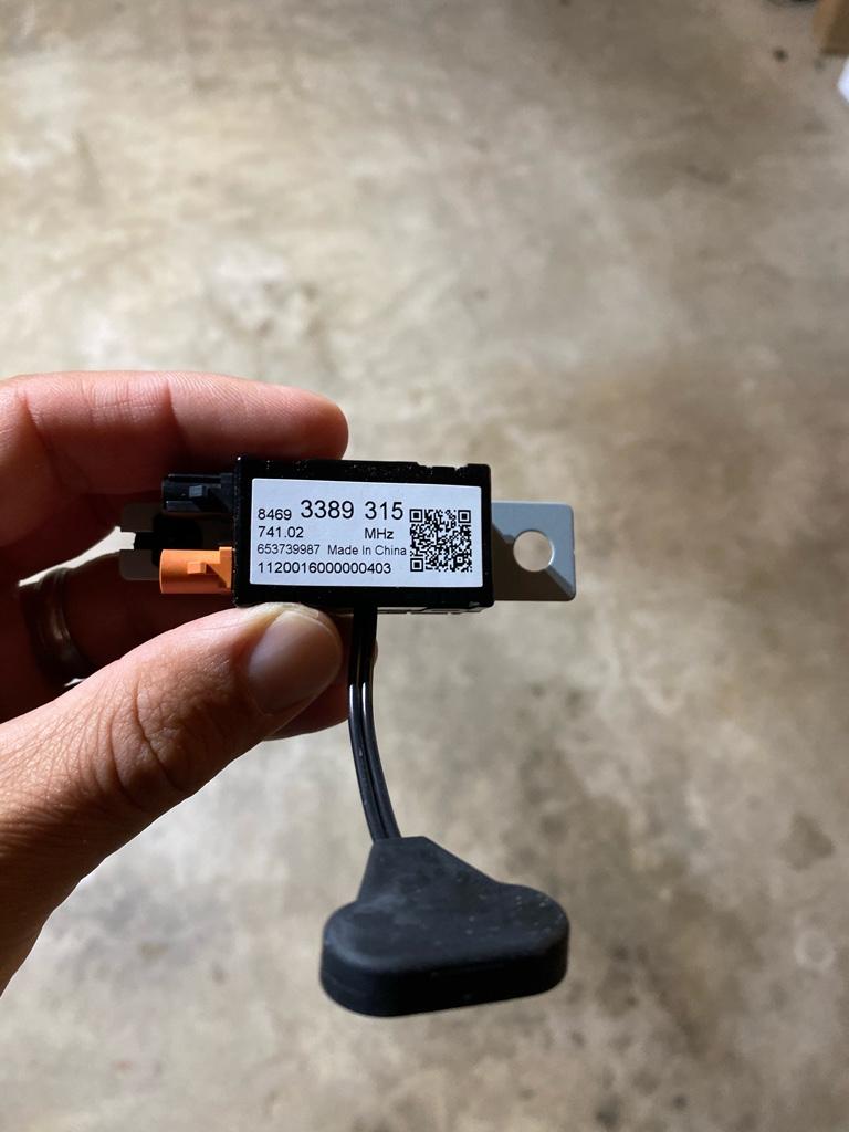

I ordered the the 315mhz one. Check your RPO code. It will list which one you need. Rock auto has 2. There is a 433mhz one too. Not sure which vehicles got the 433. The frequency has to match up to your tire pressure sensors as well. I have code U77 which is 315mhz. Maybe they incorporated both frequencies into one later. Who knows what they did

Sorry. Just saw your post. Check my reply below or above. Lol. No reprogramming. Just plug and go.
