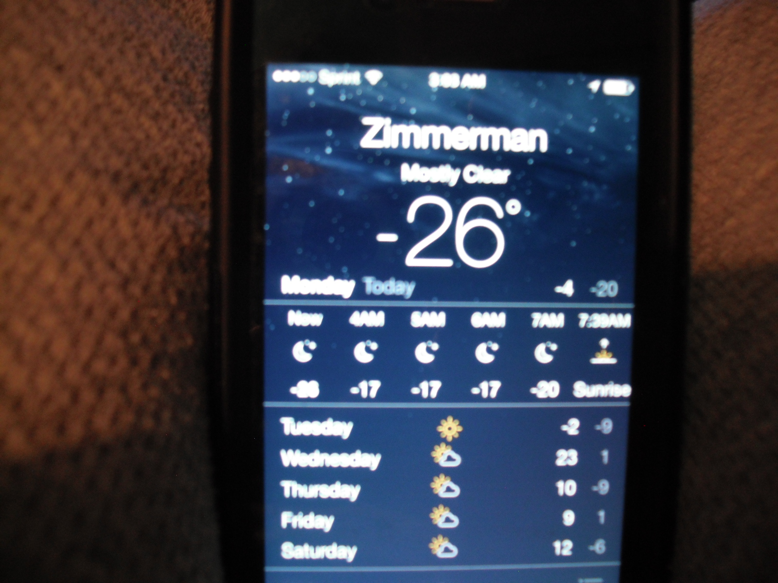

I dont see cold causing a 4000 rpm shift, but how cold are we talking? You said youre from California so cold to you isn't necessarily cold to me Midwest, and cold to me isnt cold to a U.P. or Minnesota member lol.
This is stupid cold no matter where your from and doesn't even include the wind chill which can be -50 below zero. Look close and you will see the high this day was -4.
