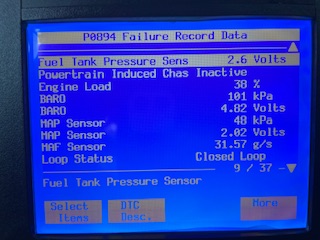

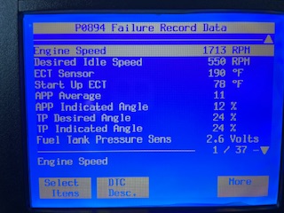

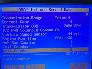

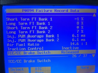

150k miles, Suburban 2500 6.0, seemed to run and shift fine when I bought it 100 miles ago..
Last night decided to pop a P0894 code. Looks like slip in 4th gear TCC locked code.
For approximately 1 mile afterwards, the 1-2 and 2-3 shifts were extremely harsh.
After about a mile, the shifts returned to normal?
Drove this morning, still normal, but no TCC activation with the code I have not cleared yet.
I'm hoping worn transmission/engine mounts exacerbated the harsh shifts.
What sounds like the issue? @NickTransmissions?
Leaning towards taking it in to a transmission shop.
I am not ready to dump big $$$ into it currently, maybe after I fix a bunch of other smaller issues..
Would driving in 3rd gear avoid the issue? Or disabling TCC in the tune?
I do not want to experience those harsh shifts again. Felt like it might break something..
I did lockup the TCC through a scantool at idle in park.(oops)
That stalled the motor completely in 5 seconds.. (Took effect in ~2s, but fully stalled in 5s)
Logged shift time errors for 1-2 and 2-3, frequently 0 or 0.1s, but also frequently 6.4seconds.
I do not notice any delay or other issues shifting, wiring harness appears intact on the transmission.

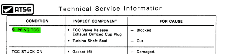

You think the torque converter clutch (TCC) clutch is slipping?
Here's what ATSG says could be the issue:
That's an older manual, not sure if their current manual shows diagnostics for the PXXXX codes or not?
Any time I remove a transmission (like for a RMS), I always replace the turbine shaft seal since they are only like $7 or something (also called torque converter lockup o-ring), and they always seem kinda flattened out but I have never had this issue yet on these transmission units...

Edit: it's this one here shown in green-ish. https://www.ebay.com/itm/3245970741...bAh0BkbFpXaIoMrs0phN8HvOkDtx3-6se59ACF07PLLlk
They are kinda hard to find at the local parts stores. Last time I ordered from WIT, I ordered like 6 of them to have in my transmission parts bin.

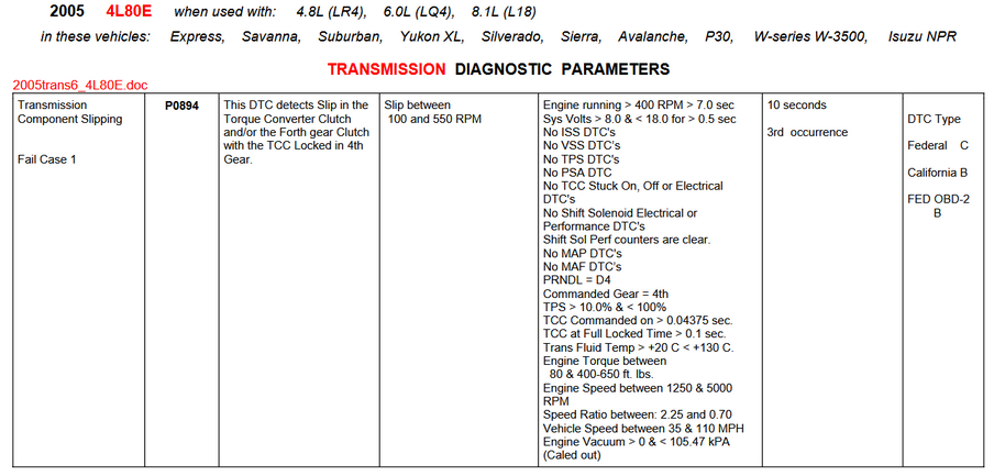

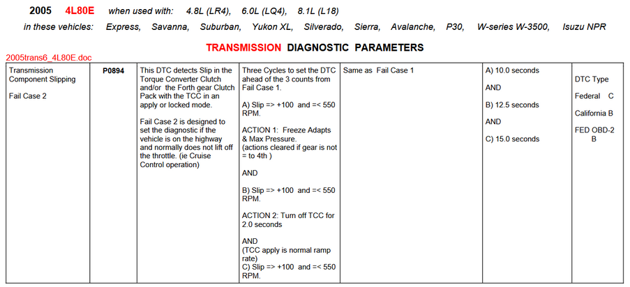

The diagnostic parameters (posted above, copied from 'auroragirl' at silveradosierra.com btw) seem to say it could be 4th gear clutch and/or TCC clutch.

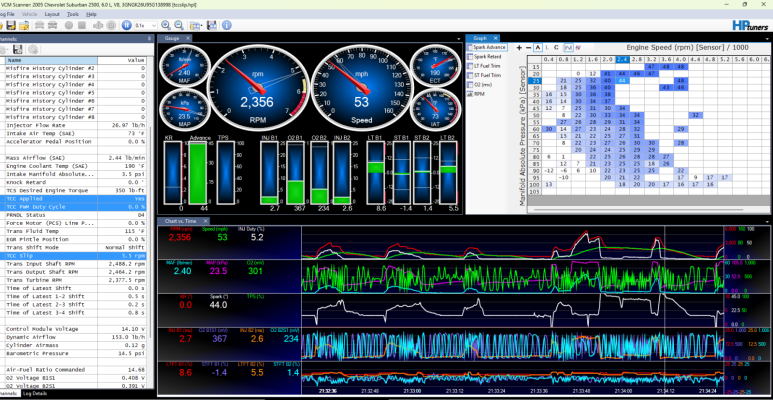

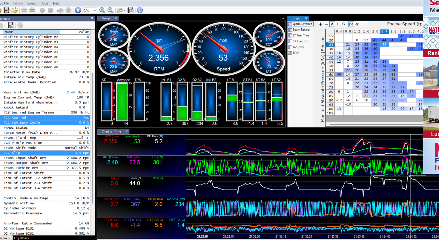

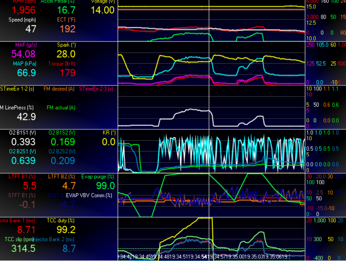

Confirmed at least my TCC is slipping. (bottom graph)
TCC duty cycle at max for 1.5 seconds at 18% throttle, and slip only drops from 350 to 315.
(TCC was max duty cycle for 3 seconds, but I'm not counting end throttle lift portion.)
Peak during 6 second ramp in was 390rpm slip, but the ramp started at 6% throttle and basically 0 slip, hitting 20% max throttle input around middle of ramp in period.
Hoping I can just disable TCC to prevent code and harsh shifts...
This chevy surprises me with something new everyday, it seems..
I dunno, this chevy surprises me with something new ,everyday it seems..

Would you mind posting the HP Tuners log file?
Sure thing, just rename file.
There isn't much TCC activation in my suburban logs..
I'm going to write a TCC disabled tune and see how much driving I can do,
and hope no more codes pop up...
(before either throwing a used trans in, or if I can find a good priced rebuilder..)

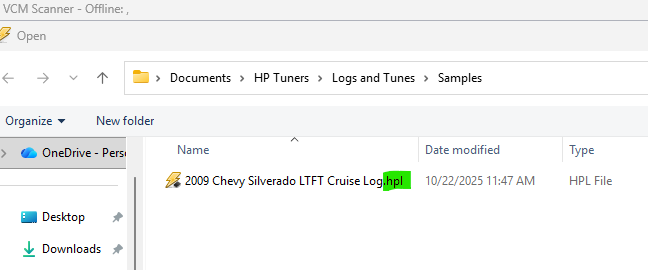

Is that file supposed to be a text file?
I opened a sample file on Hp Tuners and it's this file extension:
[thinking emoji]
Edit: I just deleted the ".txt" portion and I got it! Thank you sir!
[thinking emoji]
I assumed the message board wouldn't accept unknown file extensions. You need to rename the file minus ".txt"
Yet just tried it, only txt zip pdf png jpg's gif and doc extensions allowed.

I can see what you are talking about. But I do see sometimes the TCC slip go down to almost zero like here:

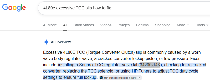

Would TCC excessive slip mean your torque converter clutch is starting to slip? That's a lot easier (relatively speaking: you still have to remove the transmission) and cheaper than a transmission overhaul. I'm just thinking out loud here...
Although Google says this:

Well the times the slip is low, I'm completely off the throttle I think..
Possible it's just the TCC and I won't need a full rebuild..

Regarding those Google AI potential issues, I'm pretty sure that Sonnax valve is not the culprit. That beater truck had a stall when shifting into gear, and that's the valve that supposedly fixed that. But you don't have those symptoms...
Doesn't seems like you need an overhaul because none of the clutchpacks seem to be slipping. That leaves the solenoid or maybe another valve body part? What else?

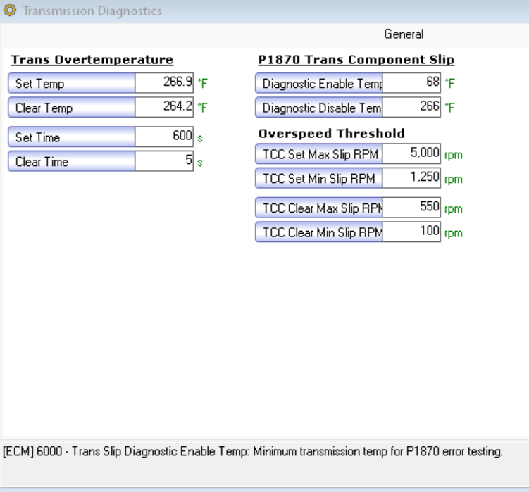

There are these settings for P1870 in hptuners, that sounds like the older version of P0894. Looks like the same criteria for shown for P0894..I will tweak that as well..

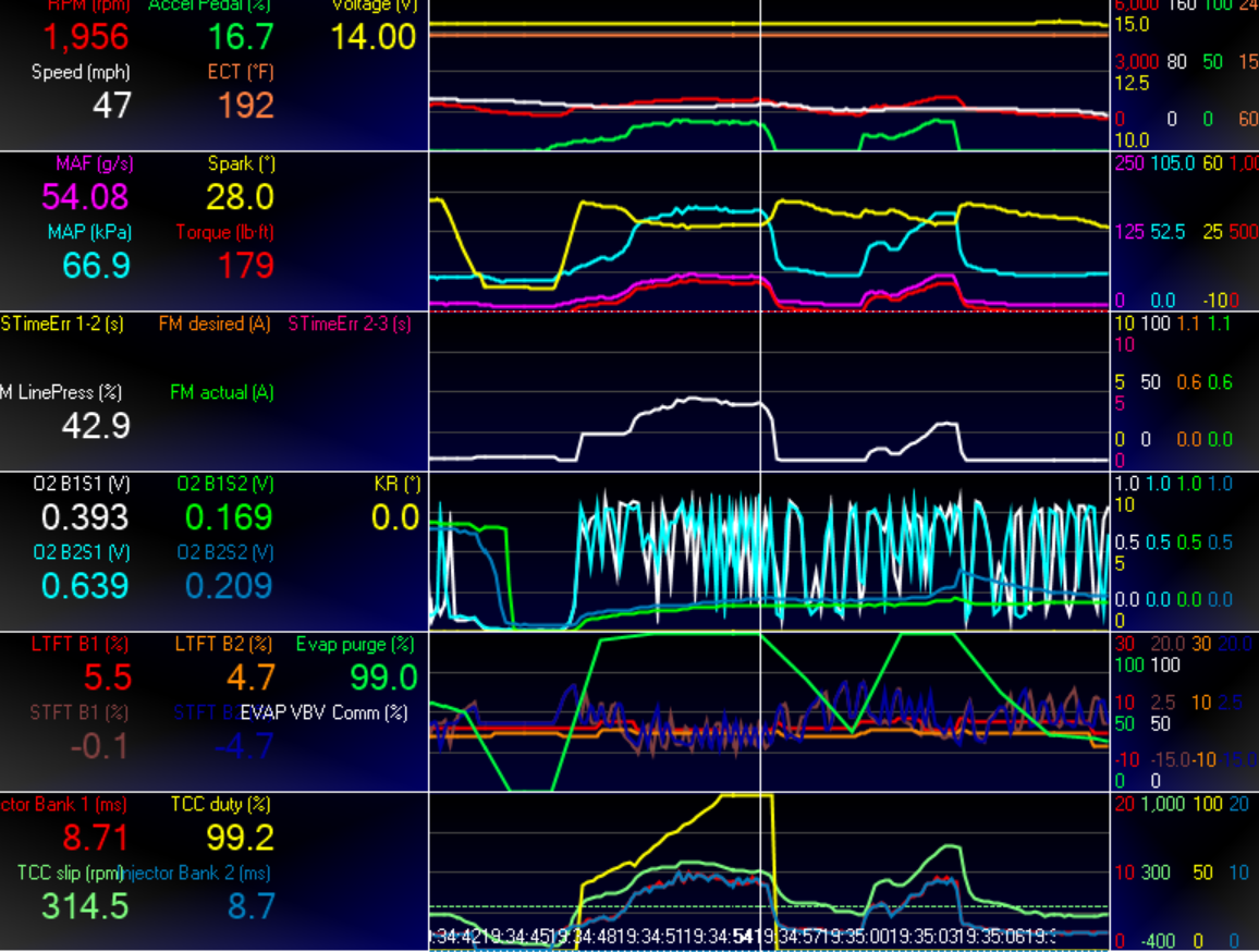

Ok, let's try this again...
Drove around my office, just to make sure I got the correct parameters added to the channel. Try this one:
  • 1999 Silverado 5.3_4L80e_test.hpl.txt

Yea, I can see it. You log has a nice flat spot as you cruise.. Mine NEVER does that.
In fact it heats up a bit with converter engaged as well.. so I think my converter is probably toast.. (plus who knows what else..)
BUT it does seem to shift alright..
Trying to smog this pile of doo doo, then will take it to a trans shop and see what else they can test (pressures?)
Hoping I don't need a full rebuild.. If I do, I might gamble on a used one..
