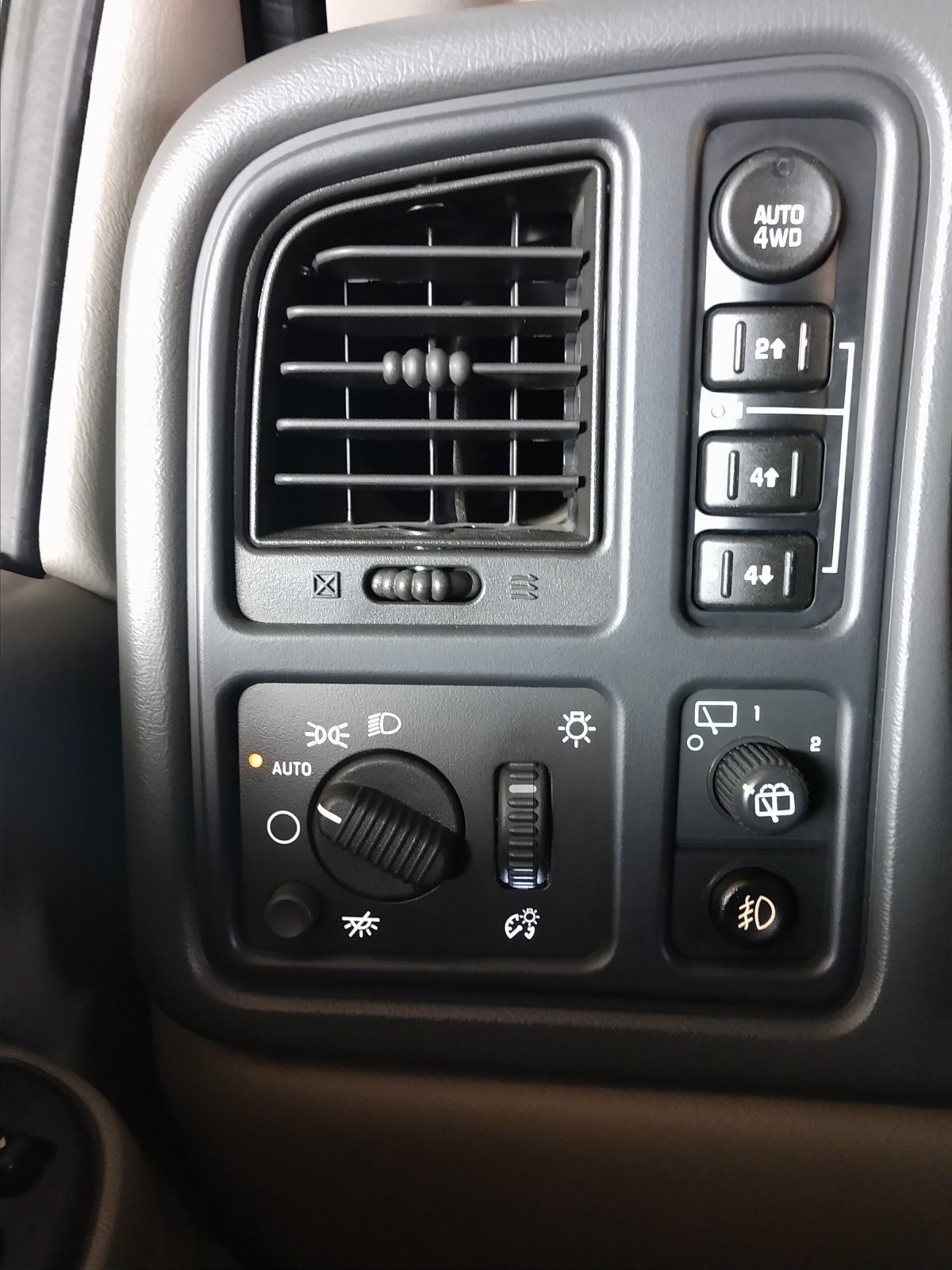

The Escalade headlight switch has an amber LED beside the Auto position that lights when the headlights are on. I don't think GM ever put that on the Chevy or GMC models (maybe Denali's??). However, it is not difficult to add. There is a pin on the headlight switch connector that has the signal from the BCM to turn on the LED. When I had my switch apart a few years ago to replace a burned out bulb, I noticed this and added the LED and backlights for the right side of the switch where the instrument lamp dimmer is. After you add the LED you have to open a small circle in the paint to let it shine through. I used a circle template the same size as the amber indicator for the fog lights and a needle to scrape away the paint. Looks like it came from the factory.

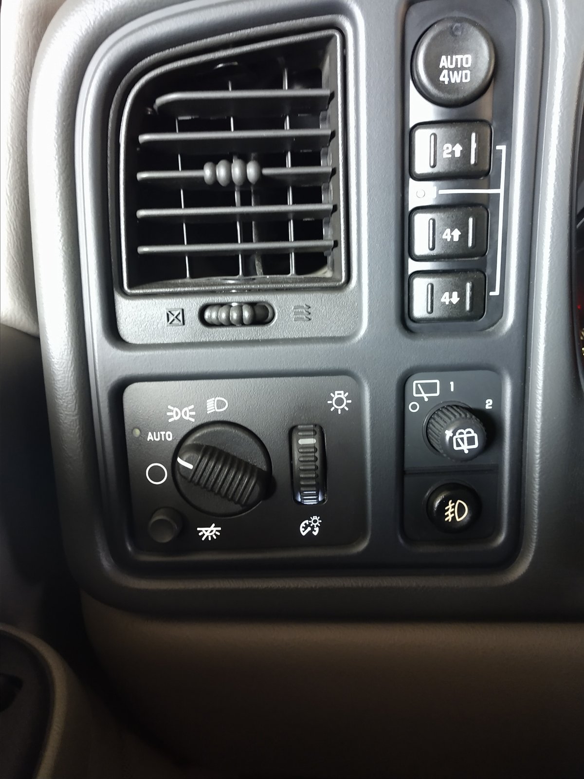

How about a nighttime pic of said mod?
Here is a pic from ebay of the Escalade switch. The LED by the OFF position indicates if you have the DRLs turned off. I can take a picture of mine this evening.

Oh, that's right. I put in an amber LED for the ON indicator, but I later learned that the Escalade used green. The Escalade used amber for the DRL OFF indicator. I like amber better as it matches all of the other indicator LEDs on the switches, but I guess most vehicles use green for the headlight indicator.

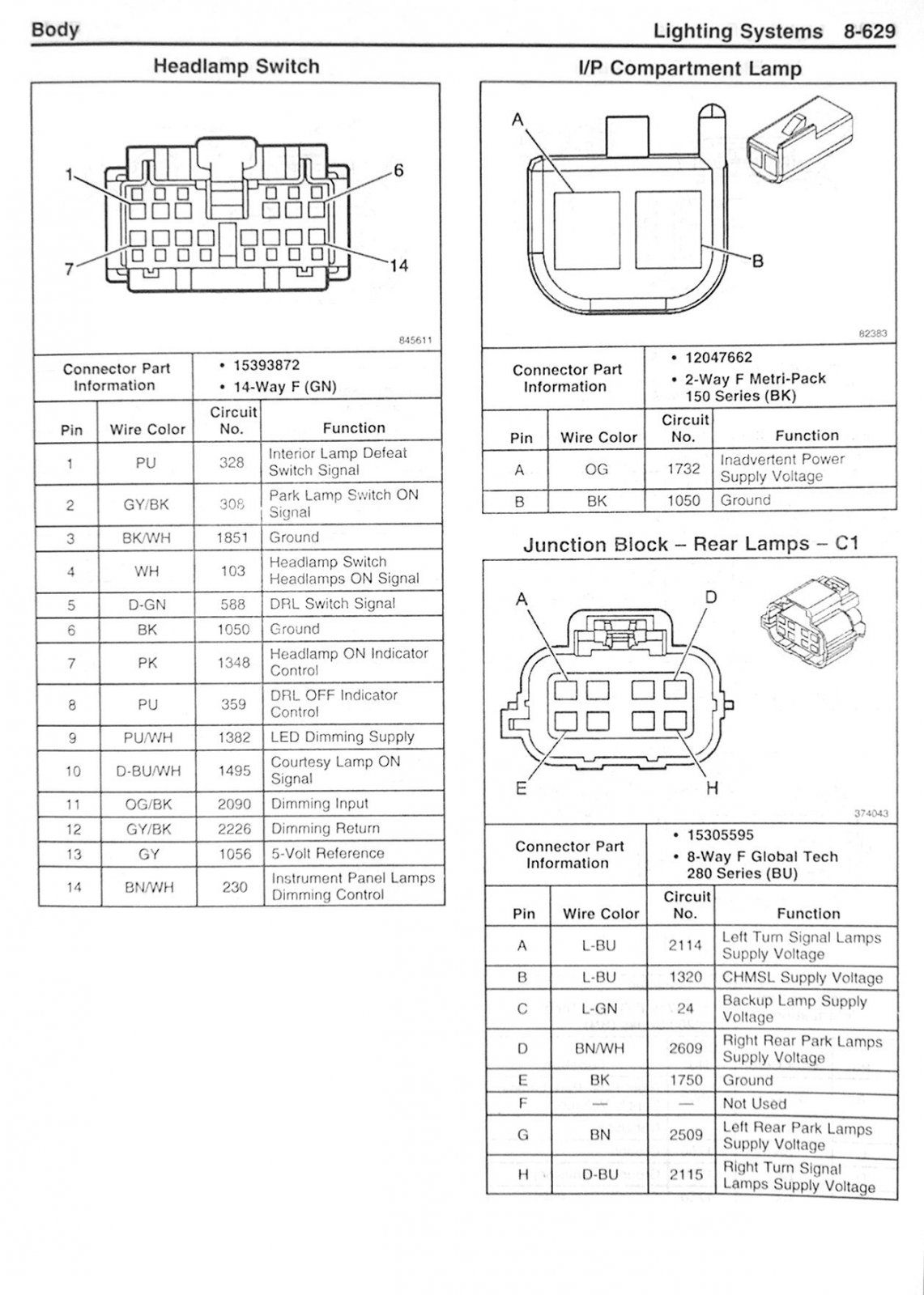

Really interesting thread topic. I never would have guessed these trucks would’ve had an indicator light for the auto headlights. The headlight switch on my 2006 Denali is just a switch. There’s no spot for there to be an indicator lamp beside the auto and off settings. And now I want one.....
All that is really needed is to put in the LED, as long as your switch has the wire in the harness. It's the pink wire in cavity 7. That is unless GM took it out of the BCM programming for 2006 MY.
