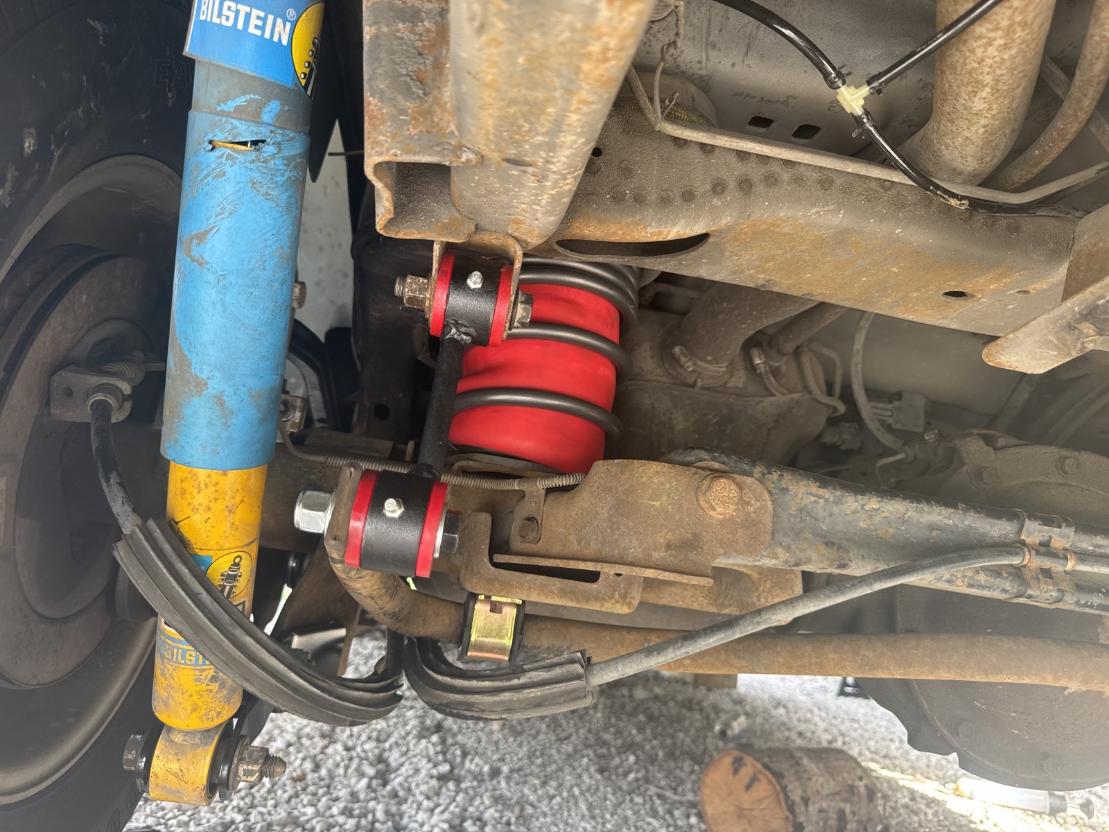

Resurrecting this one. I have just finished installing the belt tech relocation tabs for the shocks and belt tech springs. I also installed these same end links from DJ M. I’m having no issues installing these. They clear both sides without having to relocate the sway bar over to the passenger side. I’m worried because things never go this smooth. I haven’t driven it yet, so hopefully once I get done driving and things will still Clear. By the way, it’s a 2~34 drop.
NardDog
Mar 26, 2017
126
121
Pics
