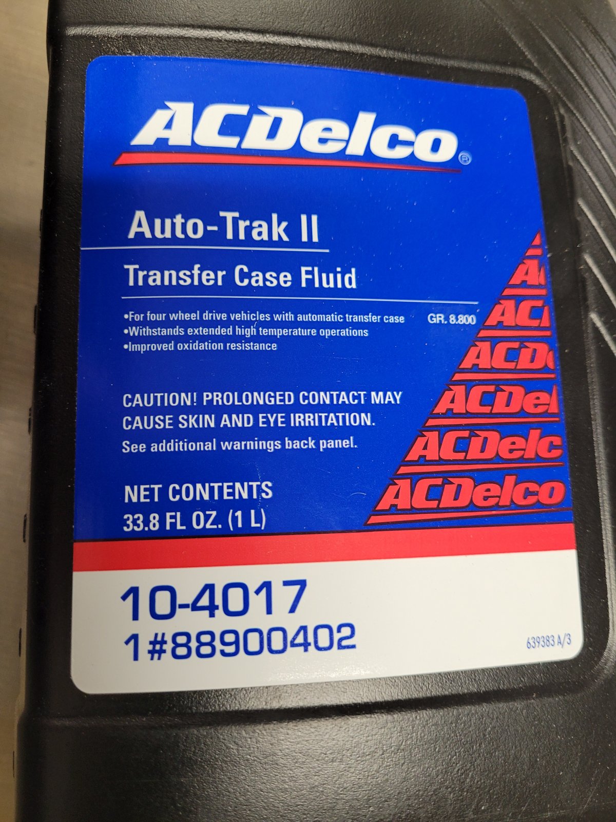

This is what I use in my 1999 Tahoe

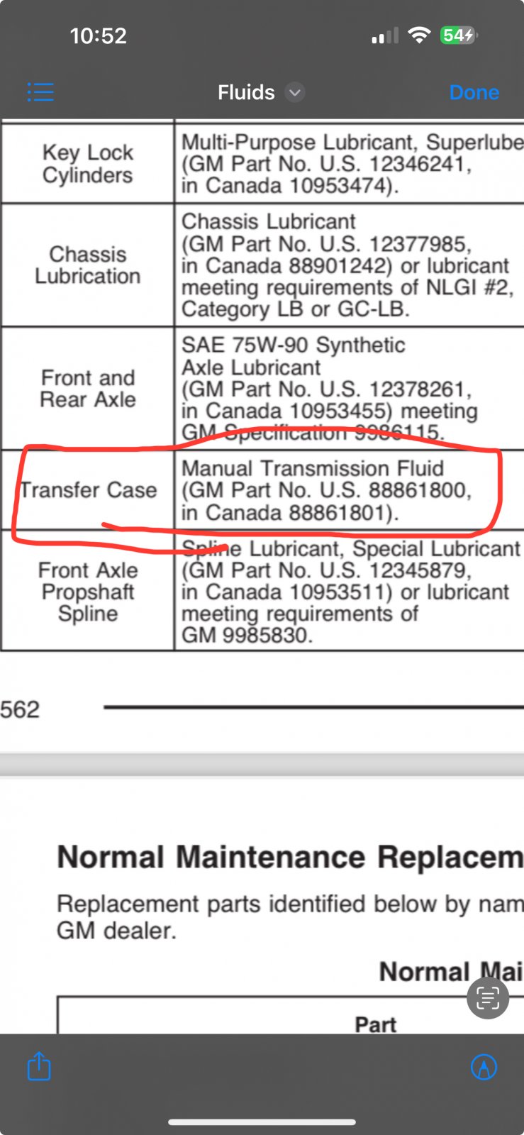

I have an 07 Denali with AWD and my OM says to use the manual transmission fluid. Which is aka Dex 3. But I believe you can find the exact one by looking up the part number ending in 1800.
