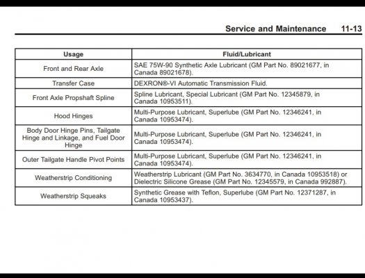

My 2012 owners manual specifies Dexron VI for the transfer case

I just found this: PIP3836B Precaution: DEXRON-VI in Manual Transmissions When DEXRON-III is indicated as the fluid fill for manual transmissions and transfer cases, DO NOT use DEXRON-VI. Instead, use GM Manual Transmission Fluid p/n 88861800 in these components.
