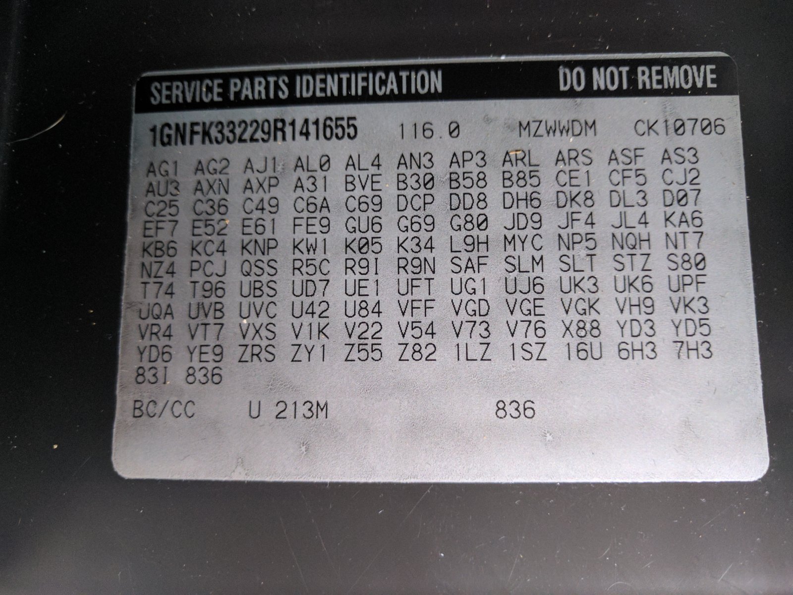

Ok, that's a new one for me. Do you mind sharing your radio RPO codes Mike?
Sure, I'll give all my rpo from glovebox
21,296
30,248
Same system as Ben's truck. He was sure he has the center speaker too. I have the RPOs from another '09 that is the same as the both of yours. Mine is very similar, only difference is mine does not have rear DVD players. Better check mine out now too! Either I'm not reading them right or the shop manuals do not show this configuration. No biggie though.

Haha, I physically touched my center speaker today to be sure, and it's there. I wonder what is different from my system to the Denali that has the RPO Y91. I love technical details and this one stumps me, lol
21,296
30,248
Pretty sure Y91 includes the smart amp. If you had a Tech2, you could query the amp, it is its own module. I know for sure mine has the dumb amp, it cannot be talked to by the Tech2 and I've seen it, it's about half the size of the other one. It's was raining today and these old bones didn't want to go outside and check.
